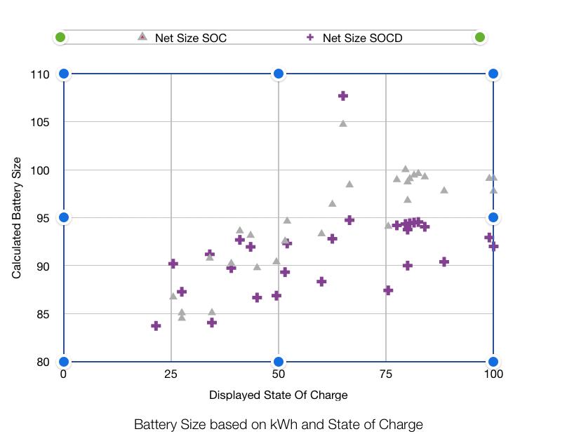

If you use an ODBII scanner you will find that there are two state of charges - the one that is displayed and an internal state. They almost never agree and rarely show the appropriate percentage for the battery size. At higher states of charge the internal state is always *less* than the displayed state (by up to 7%), at lower it reverses although they are then closer.
The displayed state really drifts around, to the point that I consider it useless. The internal state will be higher immediately after a charge and will drop down over 20 minutes as reported.
The nasty trick to all of this is that when you charge the truck, it uses the displayed state to control - so when the displayed state hits 80% you drop down to 40kW. However, at that point the truck really thinks that the battery is at 72%. The power limitations seem to be software controlled, but I do not have enough data to know which of the two states of charge are used for that.
Honestly at this point if you want to extend range, I think that you need to follow the battery voltage which you can only see with an OBDII scanner.
