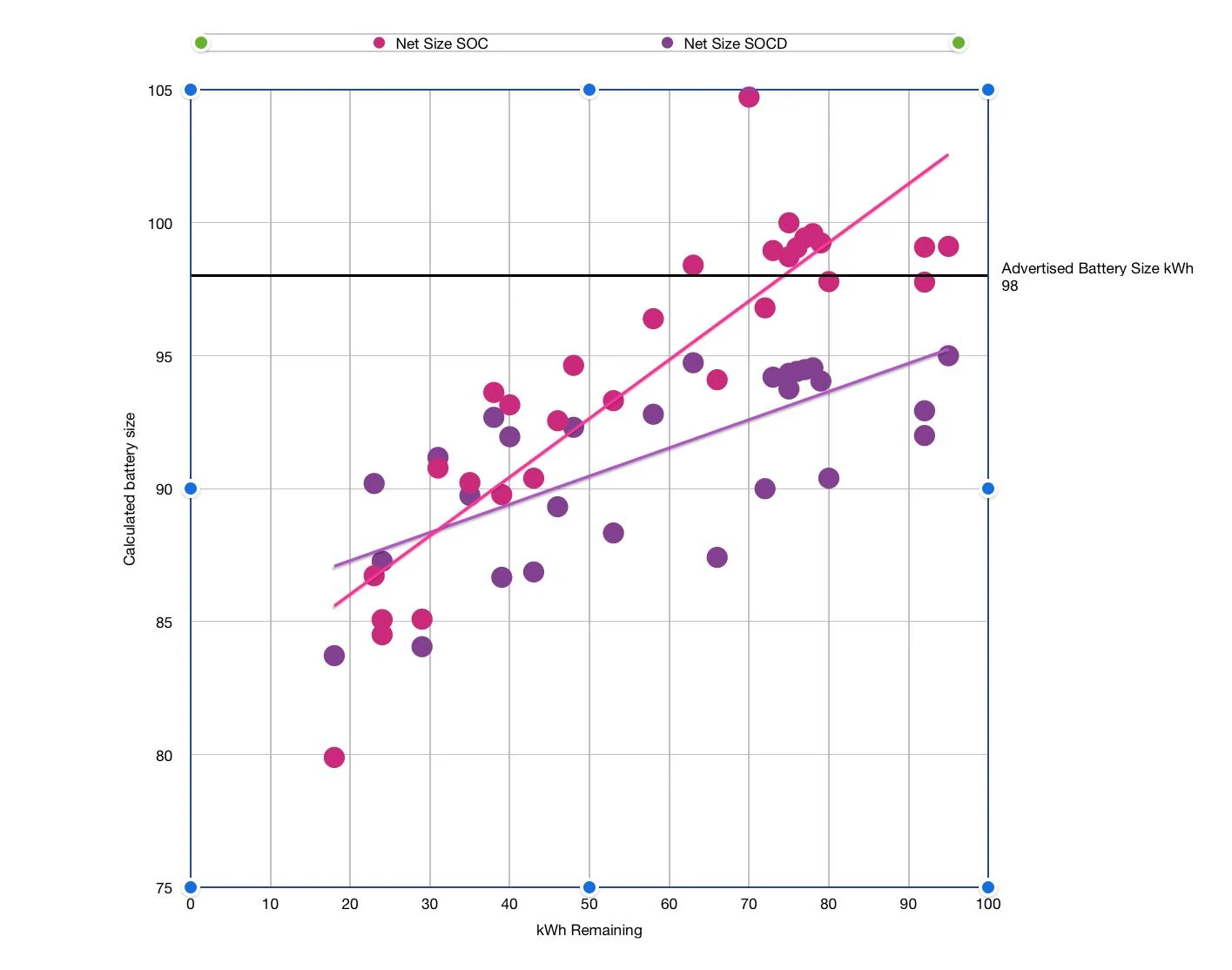

That is an interesting theory about how they maintain the high and low reserves, but there are a number of issues that it doesn't explain.
  • On my SR, the internally reported kWh to empty is never over 95 kWh even after a 100% charge
  • I have observed the internal battery percentage to decline by a significant amount after charging while the reported battery percentage remains the same
  • Multiple reports show that there is pretty clearly no usable range below 0%
  • If my data matched your graph, using my reported kWh as the x axis, I should be able to recreate the known 98kWh battery size and the unknown larger size at any point by dividing the reported kWh by the percentage We should see a nearly level line. Let's see how it goes:
Is it possible the battery needs time to "settle" down to a stable voltage before each reading?
You have alot of scatter in your readings.

So you would agree that at any
I'm not sure what the graph is trying to show.
The SR battery is 107.6kWh. It's clearly labeled on the battery. Of which 98kWh is usable according to Ford.
Again, we don't really know how they apportion the reserve but we know it's a 9.6kWh buffer which is probably split between high and low charge states.
95kWh max might be normal as a 3% loss in battery capacity sounds reasonable.
I'm sure that the "no usable range" below 0% is just how the software/BMS is programmed in order to protect the battery. In reality, there is probably 4kWh left. They have to set a hard stop somewhere.
