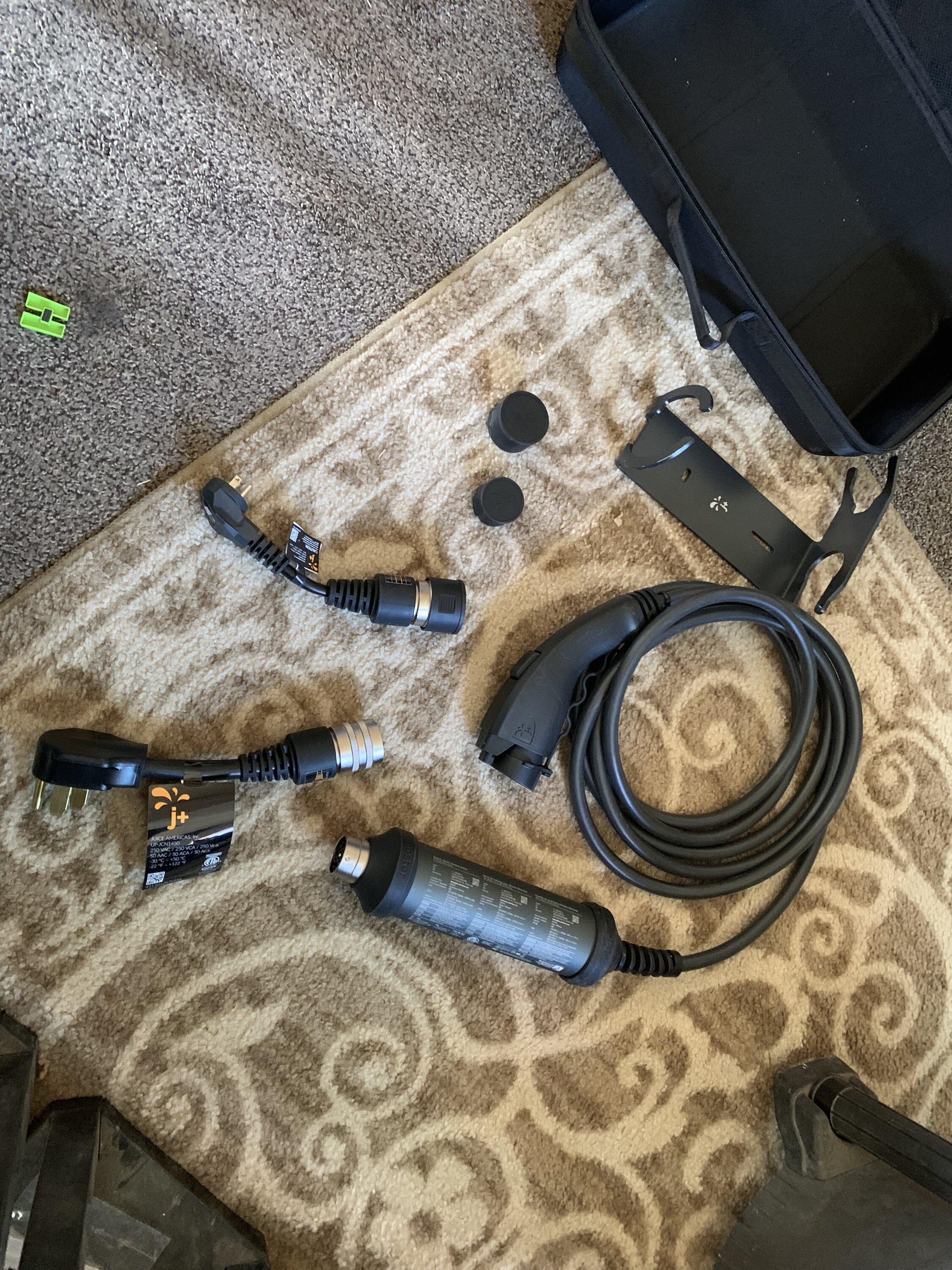

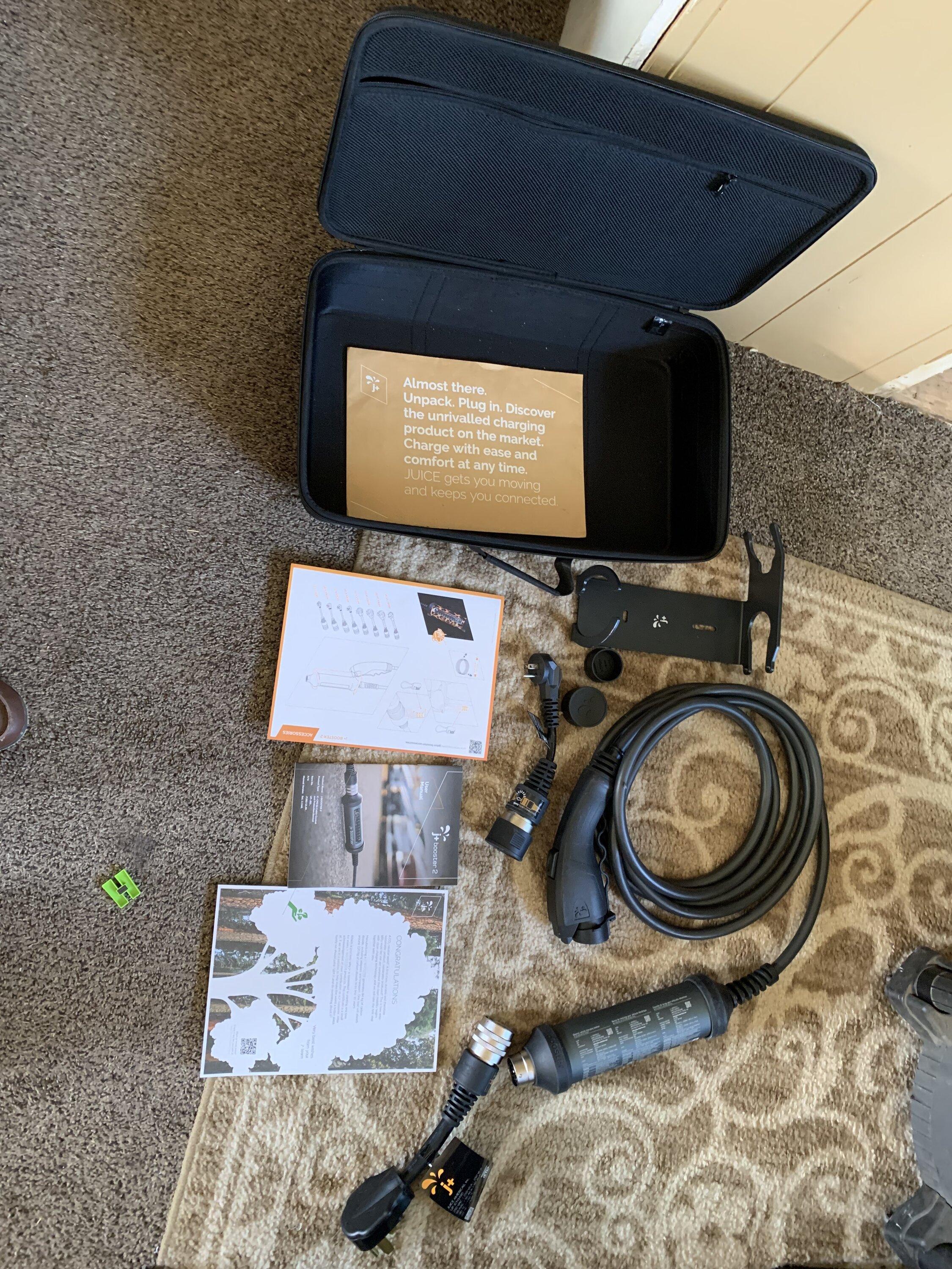

I have a J+ booster 2. It is UL listed and Swiss made. It is built like a tank and has interchangeable adapters. If you want to save some money the company sells demo units with a full warranty on eBay. I bought a demo unit and it works great and included everything a new one does at a significant cost savings. I keep it in the frunk for emergencies
