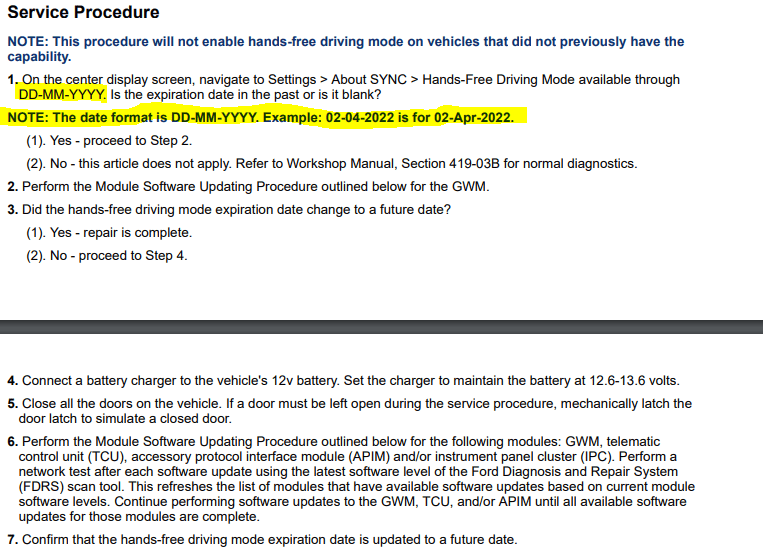

Is anyone else having an issue with OTA updates for their bluecruise map? I took delivery of my truck right after the map expired on Sept. 10th, so I haven't been able to use hands-free driving yet. It seems like a known problem, at least amongst Mach-E users, but my dealership doesn't seem to be able to help. Reading a few messages it seemed like I needed to take it in for a GWM update, but they at first couldn't find anything, then when I pointed out the "fix" in a Mach-E thread they were able to see that there was indeed a problem, but it apparently doesn't apply to my truck because it falls outside the production window that Ford has deemed prone to the problem. Now I'm being told that they don't know what the issue is, even though it's the exact same issue others have reported!
