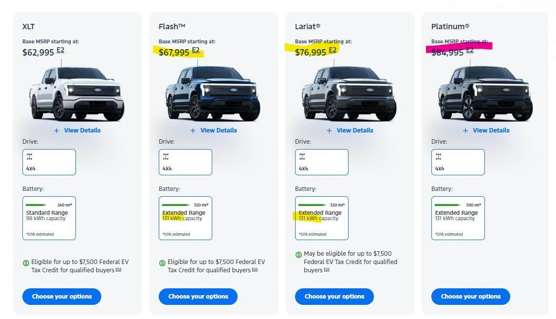

I don’t understand why Ford eliminated the dual onboard chargers especially if you have the ER battery??
It seems like maybe the cost cutting moves have gone overboard?
Trying to keep more configurations under the 80K limit.
It also decoupled the FCSP from the ER models, which is a cost cutting move as Ford was giving away the FCSP (let's be real, the cost was baked into the truck's MSRP). Even though it wasn't a line item, I'd have to imagine the FCSP price was included in the ER battery add-on.
Ford removed more features than they added without reducing the price. They should've left the second on board charger.

Only the 3 year BC option brings the MSRP over 80k, buy the 90 day trial on closing and any tire option and you're still under 80k on the Lariat-ER, obviously the Platinum didn't benefit much as regards the federal tax credit.
I wish we had a say in which features to drop and which to keep. Pipe dream I know. But buyers might gladly do without say, an automatic tailgate if it meant keeping dual onboard charging for future buyers. Idk.
