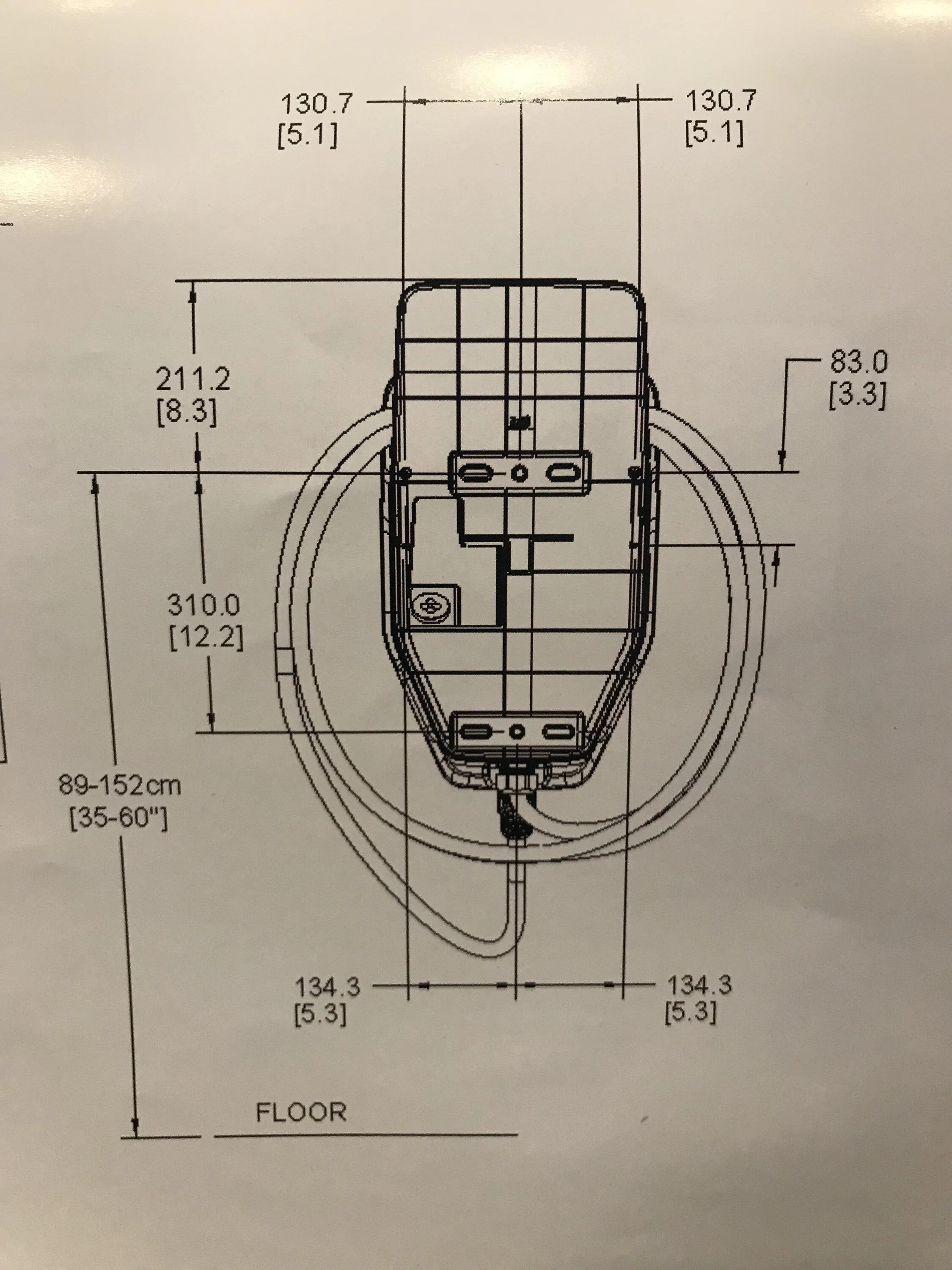

Same Problem. What Pedestal is compatible with the Ford Charge Station Pro EV charger?
I spent more than an hour on the phone with Ford ... four 800 numbers, six people and a grand circle from EV Parts through Battery & Electric Vehicle Parts (twice) to a couple of other 800 numbers and finally back to EV Parts. Nobody knows what pedestal(s) are compatible with the Charge Station Pro. It should not be that difficult. And I'm not interested in SunRun. I'm sure they will sub-contract this to some local and I've already got my own electrician. Ford sold 61,500 EVs in 2022 (Google) and I can't believe I'm the only one who wants to put the charger on a pedestal. There should be a list on the charger sales page that lists pedestals compatible.
Has anyone got a pedestal company and part number? Thanks
4,215
5,589
Below are mounting dimensions. As long as you make the post work with those dimensions, and it’s capable of supporting 100 pounds, you’re golden.
