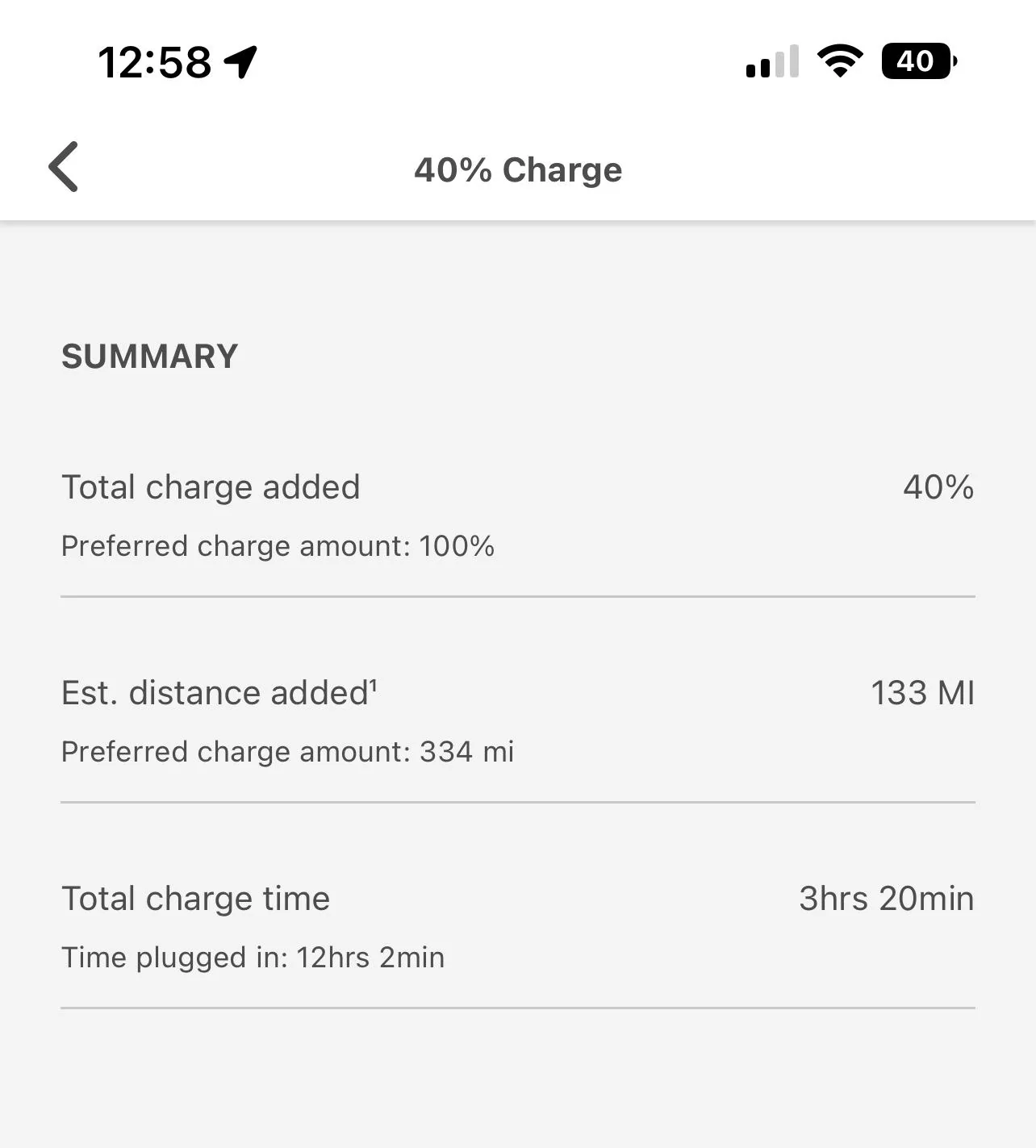

Just wanted to throw it out there that after the software update my Charge Station Pro is working perfectly and has not produced a single error. I also see no signs that the CSP is derating.
What does it mean, "Preferred charge amount: 334 mi"? Are you getting 334 miles when fully charged? I'm getting just over 300 (but I'm a not-very-energy-efficient driver, I admit.)
Yes -- I don't normally charge to 100% but I was doing this to test the charger. So after this charge, my "Guess o meter" said 334 miles. I can get that range sometimes, but other times I'm definitely closer to 300.
I drive about 100 miles a day on average during my busy season (which is right now) . It's a mixture of 40 miles using hands free blue cruise at exactly 79 mph each day and the rest is "around town" driving. I constantly floor it. My wife hates how I drive.
Based on how you drive, I'm impressed with the 334 miles!!!
Me too .. the lightning is the real deal though . Now that the charger is fixed I have absolutely 0 complaints . It’s an excellent work truck , it’s faster than all of the mustangs I’ve owned . No issue with payload. Can tow my skidsteers locally with no issue. Looks great . Zero range concern . Tech is great. Just want some more PowerUp updates and phone as a key . Love.this.truck.
