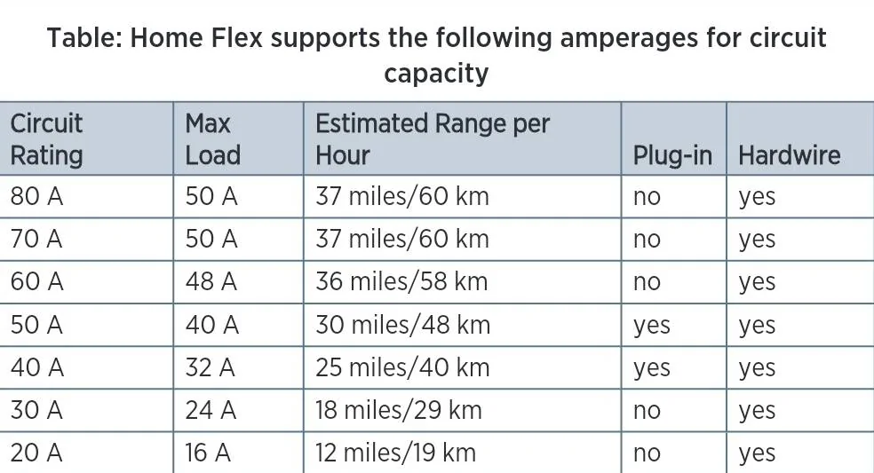

Problem is i have it set at 80amps on app, thats what im not understanding. On another note, charger says 6awg is max wiring, but how can you get 80amps with 6 wire. Doesnt make sense.

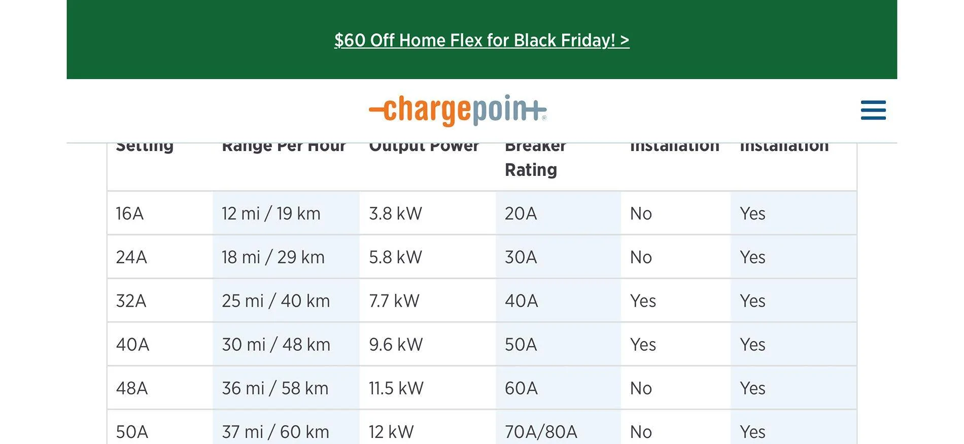

You can't. The ChargePoint doesn't support 80 amps. The most it can deliver is 50 with a 70 amp breaker. It's in the manual.
