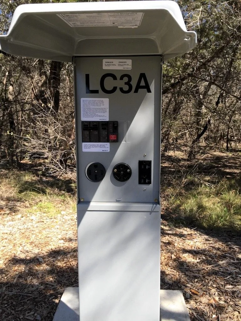

I always book a 20/30/50 site. 30a to the camper, 50a to the truck using a 15-ft extension and the OEM mobile charger. Wish my 2024 could adjust the charge rate down a little. Would also be nice to have an option to turn off the charge port lights. Maybe someday we’ll get that update? 😂
I book a 20/30/50 site when I can and when I need to charge overnight. If I'll be at a site for several days, a 20/30 will do: 30 for the trailer and charge the truck off the 110/20.

We've pulled 3 different camper trailers in 3 years to a State Park with our Lightning. Each time, we plug the RV into the 50A plug and we charge our Lariat with the 30A plug. I always keep several adapters just in case there's different style plugs. Each time, we use our Ford mobile charger and we charge every day while we're camping. We always stay 3 days and we always leave with 100 percent SOC. We love camping and charging with our Lightning. :)
