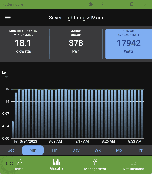

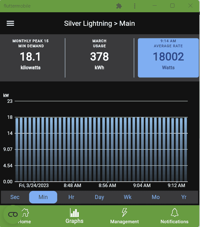

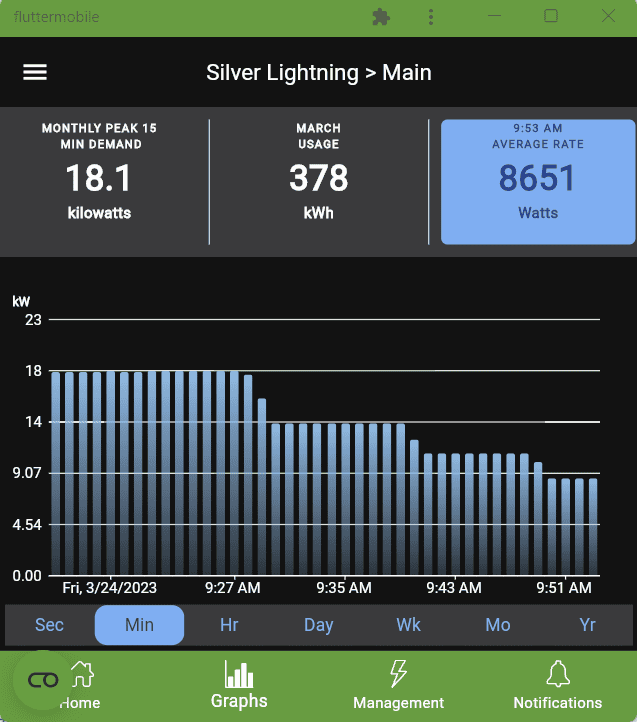

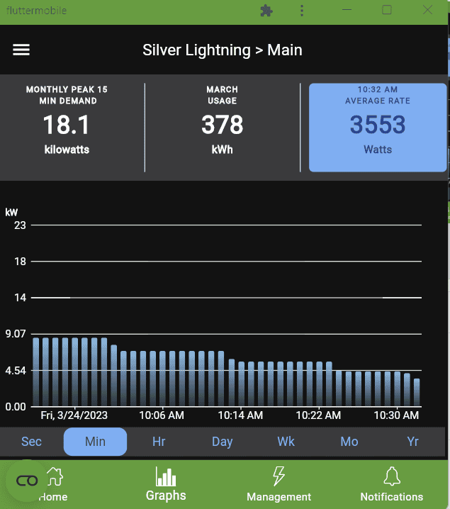

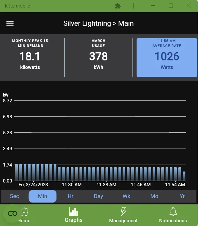

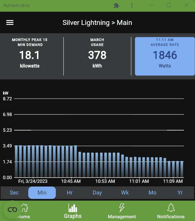

This is an example of my truck's charging {energy consumption} curve by the minute, to go from 77 to 100%, the initial minutes could be the PTC warming the battery up to optimum charging temps.
Ford F-150 Lightning Charging loss or some other issue...? 1679758755042
Ford F-150 Lightning Charging loss or some other issue...? 1679758830793
Ford F-150 Lightning Charging loss or some other issue...? 1679758876782
Ford F-150 Lightning Charging loss or some other issue...? 1679758946974
Ford F-150 Lightning Charging loss or some other issue...? 1679759003551
Ford F-150 Lightning Charging loss or some other issue...? 1679759086151

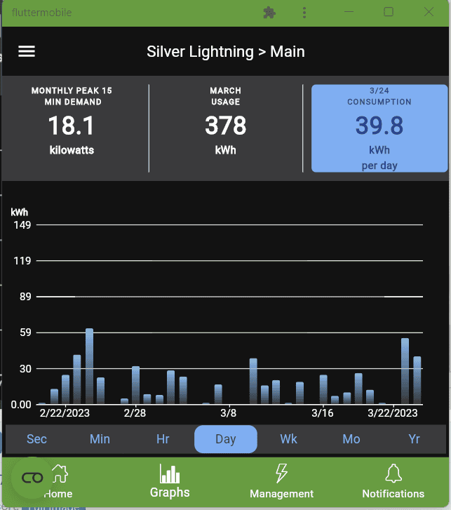

This is the daily chart 39.8 KWH for Friday morning to noon

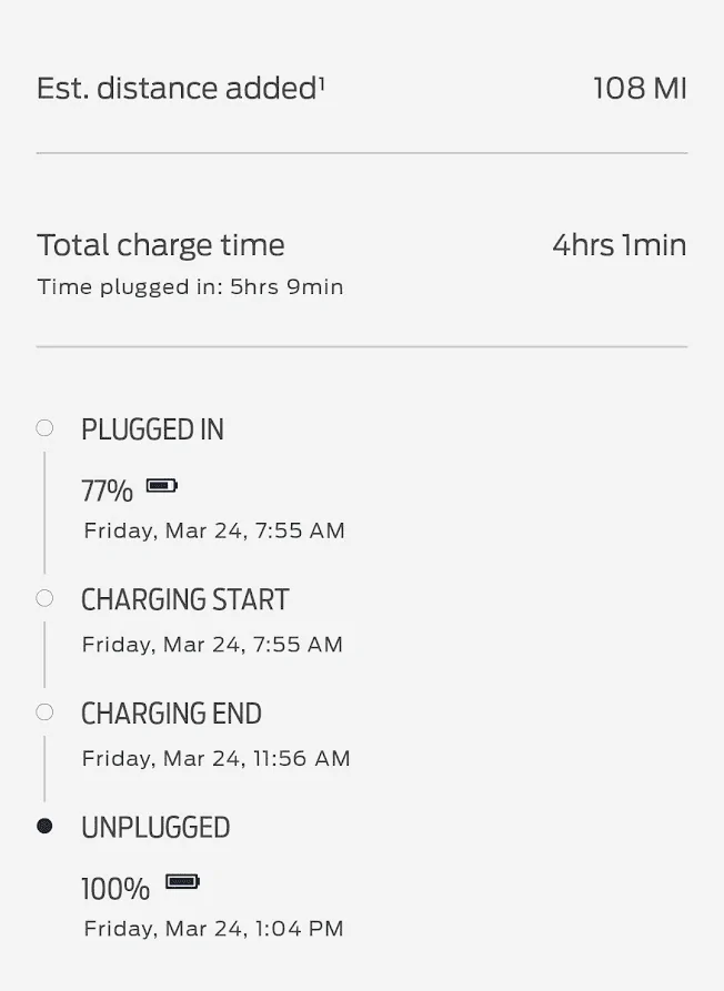

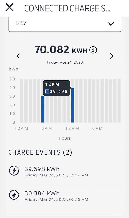

This is the FordPass charging log 77% to 100% infers 23% gain or about 30 KWH of a 131 KWH pack.
So 30/39 is ~77% efficiency or ~23% losses, temperature was mid 50's during this charging session in my garage.
Ford F-150 Lightning Charging loss or some other issue...? 1679759579920
This is the FordPass "Connected Charge Station" chart, note the time error is due to conversion EST to EDT since my last device configuration.
Also it only reports the charge statistics upon unplugging the truck, so the actual Thursday night charging is showing up as Friday morning [30.384 kwh], but the late morning to noontime record represents cumulative energy the by the minute charts show above [39.698]
The total energy measured by FCSP and my Emporia Vue2 are very close accuracy wise.

Interesting, info taxmanhog. I appreciate you posting the graphs.
The openevse shows the total number of watts dispensed in a charge session and then I just figure 131 kw total pack size so I do my math based on the % of increase.
From what I'm seeing, taxmanhog sees the same percent delivered to percent dispensed as I am.
