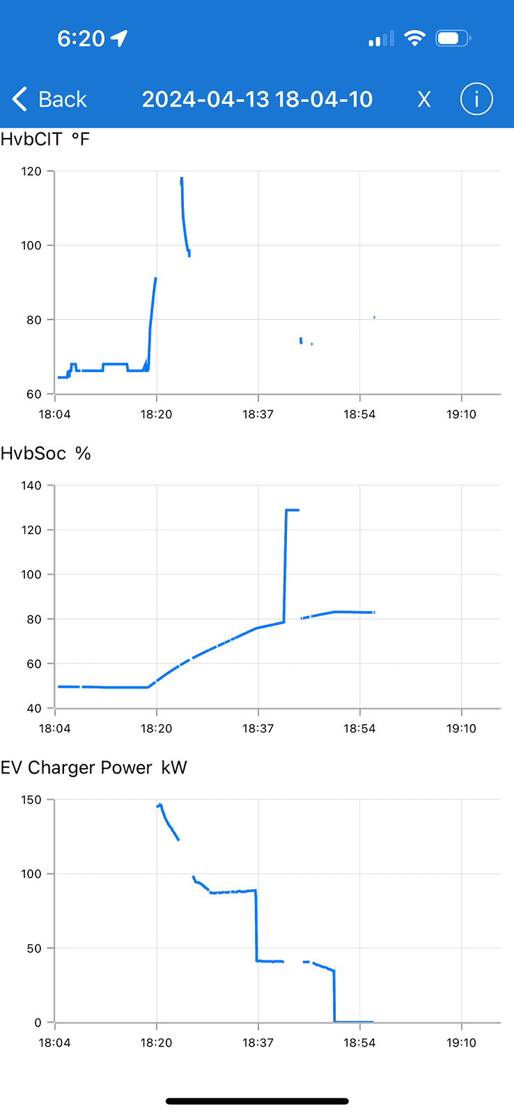

This is from charging at the Magic Dock in Forks, WA on a 2023 ER Lariat. There are some odd spikes, car scanner pro seems to do wonky things when you start arranging the screens while it is recording.
Ford F-150 Lightning Charging Profile at Tesla Supercharger with NACS adapter IMG_5275

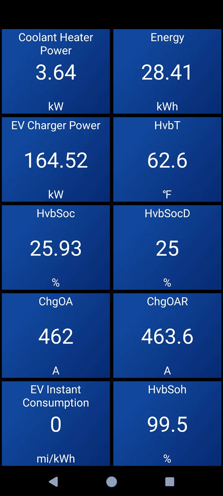

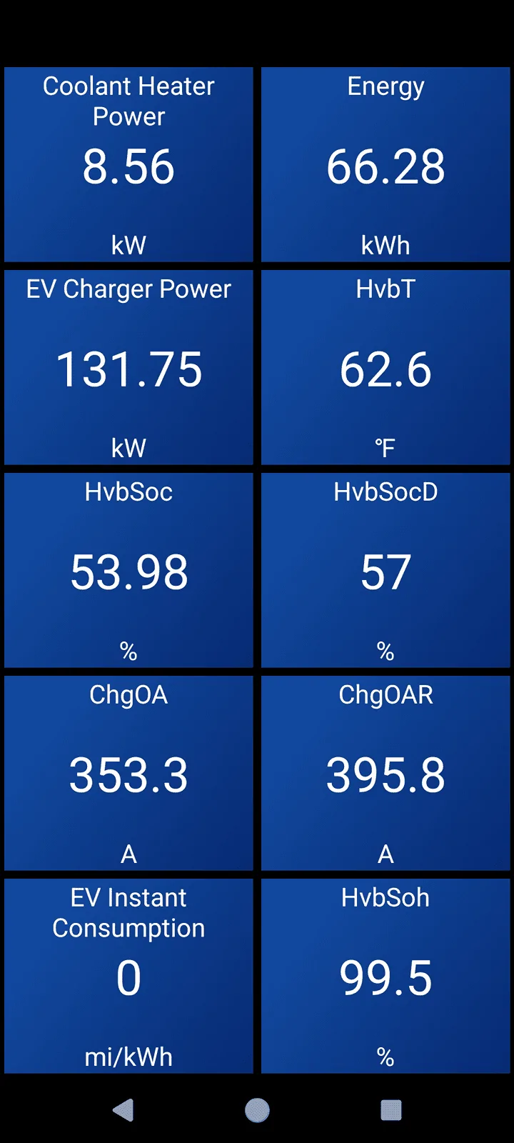

The truck determines charging curve within the charger’s available range. To put it another way, the truck determines the best way to charge the battery, and the charger does what it’s told. If you got a better rate with an EA station, your battery may have been cooler which permitted a higher power rating.
I keep an eye on current requested and delivered through my OBD scanner, and I’ve never seen the charger deliver lower than what the truck asks for.
Really? Happens at EA a lot. Tesla is closer to requested.
Tesla charge:
Ford F-150 Lightning Charging Profile at Tesla Supercharger with NACS adapter 1000003310
Here is EA:
Ford F-150 Lightning Charging Profile at Tesla Supercharger with NACS adapter 1000003335
