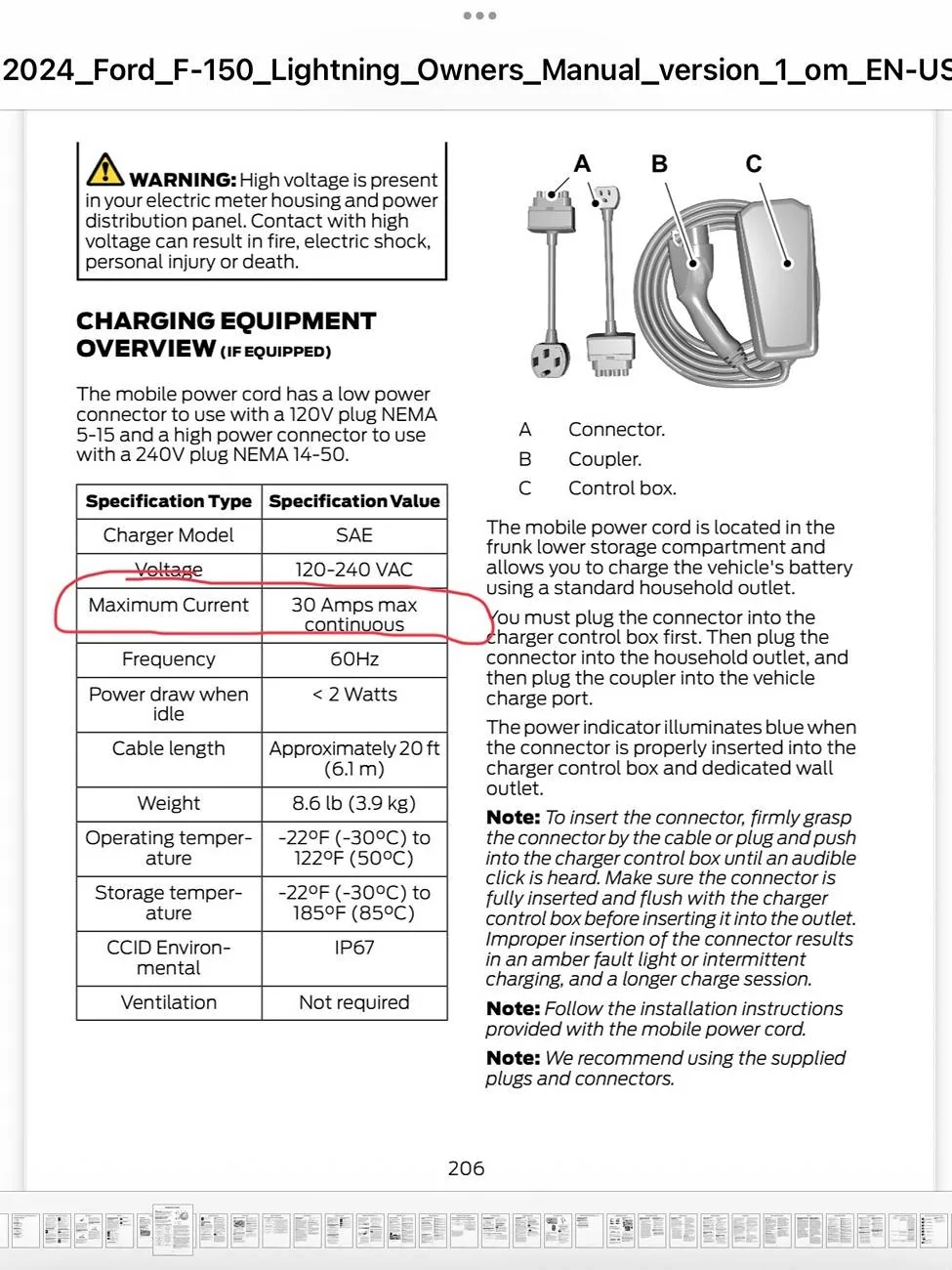

Yes, the mobile power cord is rated for a maximum of 30amps current. So on a 240v circuit it can provide a max of 7.2 kW.
Ford F-150 Lightning Charging Speeds at Home IMG_0399
often due to local demands you may not have a full 240v available and the power output will be somewhat less, ie 6.6 kW

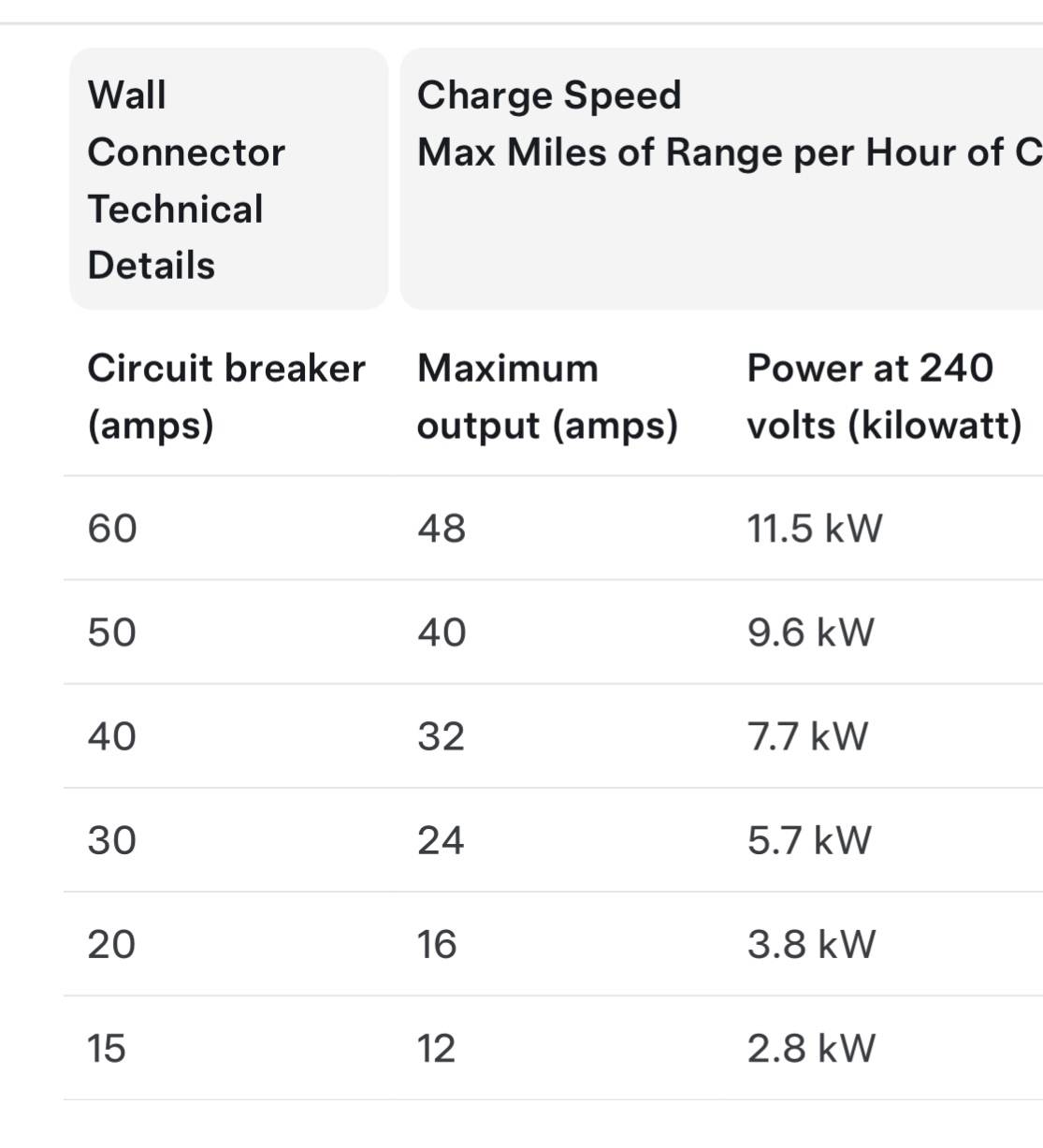

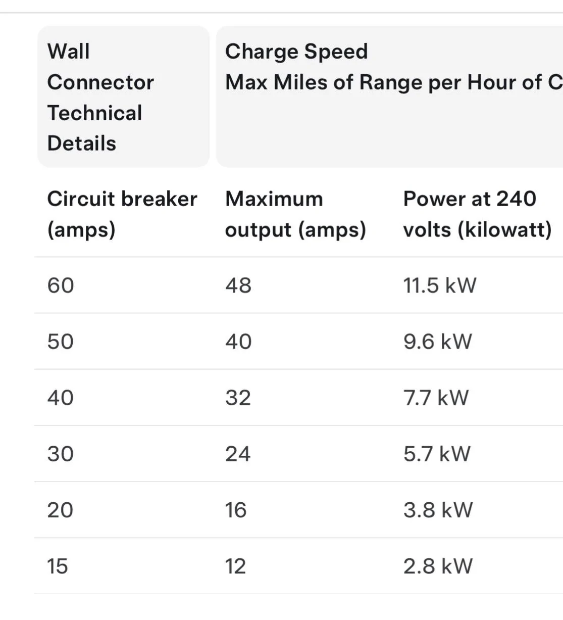

For clarity. This is from installation instructions for a Tesla Wall Connector.
When you set it up you tell it the circuit (breaker) capacity. The setup automatically configures the max output to be 80% of the circuit capacity
So a 50 amp setup automatically configures the output to 40 amps max which delivers 9.6 kWs. 40a X 240v=9,600 Watts aka 9.6 kWs. I have that exact setup at my cabin. While Tesla reports 9.4-9.6 kWs the truck reports around 8.8 kWs due to about a 8-10% efficiency loss.
