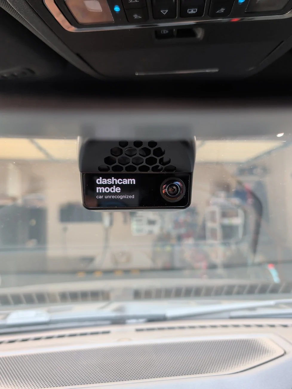

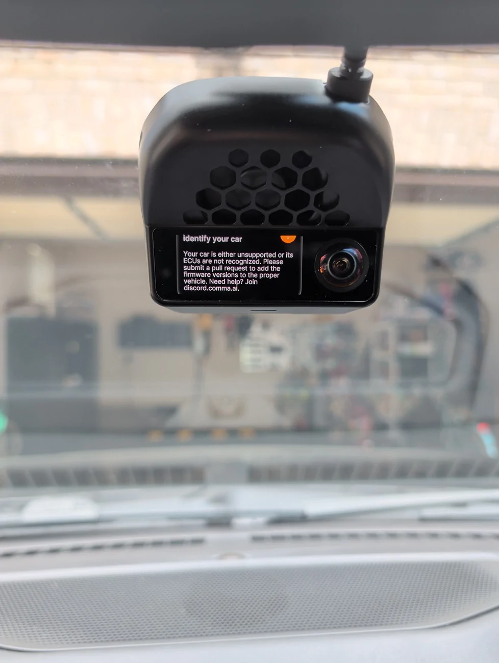

After you install bluepilot, go into the menu and find the SunnyLink pairing option. Once paired to Sunnylink, you can go in through the web browser and force it to recognize your truck in the "vehicle menu"

Sorry, but are there instructions anywhere on how to do all of this and where to download the files?

This thing is so frustrating. Do you have a link to your instructions? I can't seem to find them after searching Google.

menu --> device --> uninstall
on reboot, join wifi
Use custom software
URL (case sensitive) = installer.comma.ai/BluePilotDev/bp-6.0-beta

Thank you, sorry, I was able to get this figured out finally and it's installing now but it's been sitting here at the Bluepilot screen for a while now. Not sure how long this takes but I will give it some more time.
up to 30 minutes, longer than that would indicate an issue.
