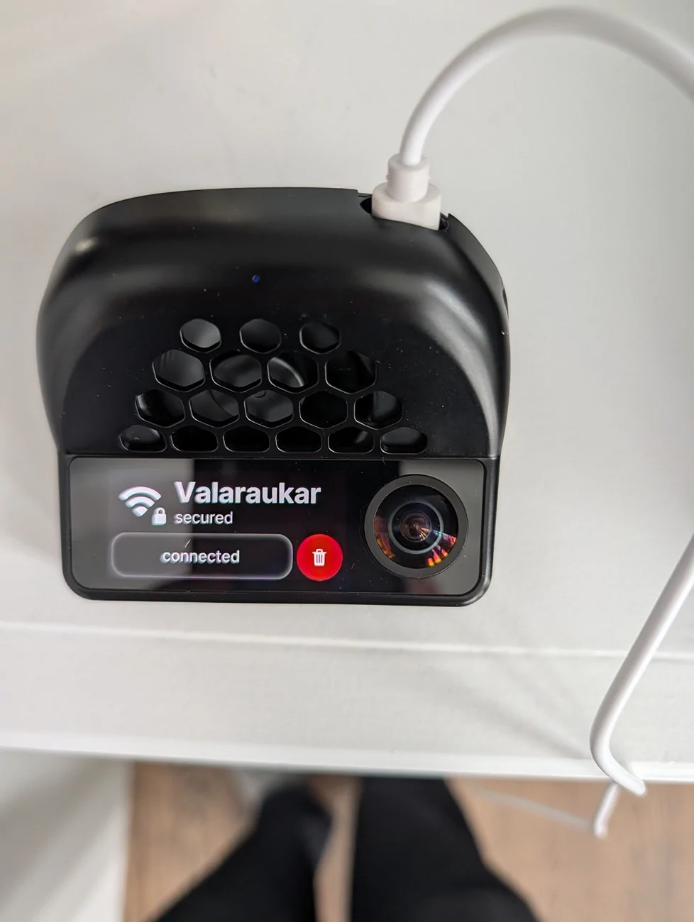

I got everything installed but it's just sitting on the WIFi connected. Does this step take a while?
it can take 2 -3 minutes depending on wifi speed. It's best to do that step inside on a phone charger
Okay, I took the unit inside and it's still sitting here at connected. It's been around 3 to 4 minutes and we have a pretty fast connection.
picture?

After you install bluepilot, go into the menu and find the SunnyLink pairing option. Once paired to Sunnylink, you can go in through the web browser and force it to recognize your truck in the "vehicle menu"
