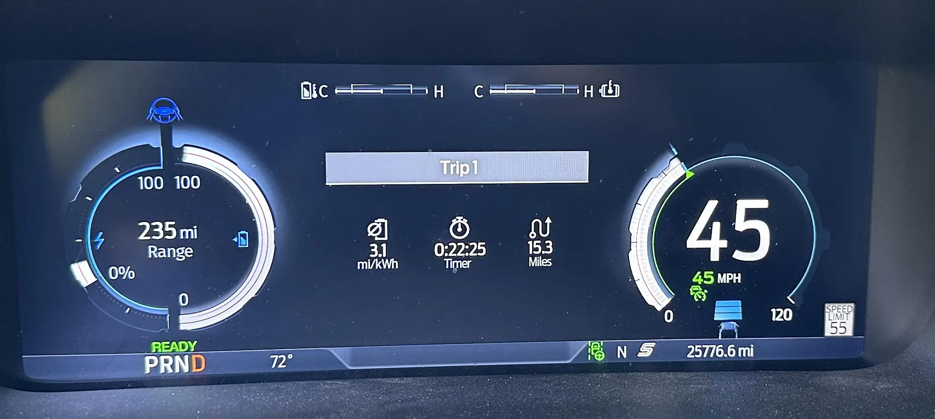

yeah, you would be the first person ever to have blue cruise on city streets. I would bet a comma that you don't though. Blue Cruise is only active when you have a blue screen similar to the first image below and there's a 0% chance of that on non-interstates or controlled divided highways. Ok, I shouldn't say 0% since those with comma's can get that screen anywhere with cruise control. :crazy: The second image is regular lane-centering with the steering wheel on the top left and requires frequent pressure on the wheel to avoid the "keep hands on the wheel" nag.

What I noticed while it was steering itself on surface streets is every now and then it would tell me to put hands on wheel, when I did, the alert would go away and continue steering itself. It didn't stay on with the blue wheel as shown in your screen, I've seen that pop up on the hwy. Regardless of what it's called, the truck was keeping itself centered in it's lane.
That is the hands-on wheel nag. With the Comma, you can go for hours without touching the wheel on any street.

Not to come off as rude, but if you don't understand how the stock systems work and what they are called, you probably don't need to install a comma. They are essentially dev kits and you need at least a basic understanding of what it does. What you are talking about is Copilot 360 which is not hands free, which is why it is telling you to grab the wheel. Blue Cruise is the stock hands free system and it only works on mapped roads. It also shows the graphic on the IPC as shown by the post above (Which he is only getting because of the comma).
