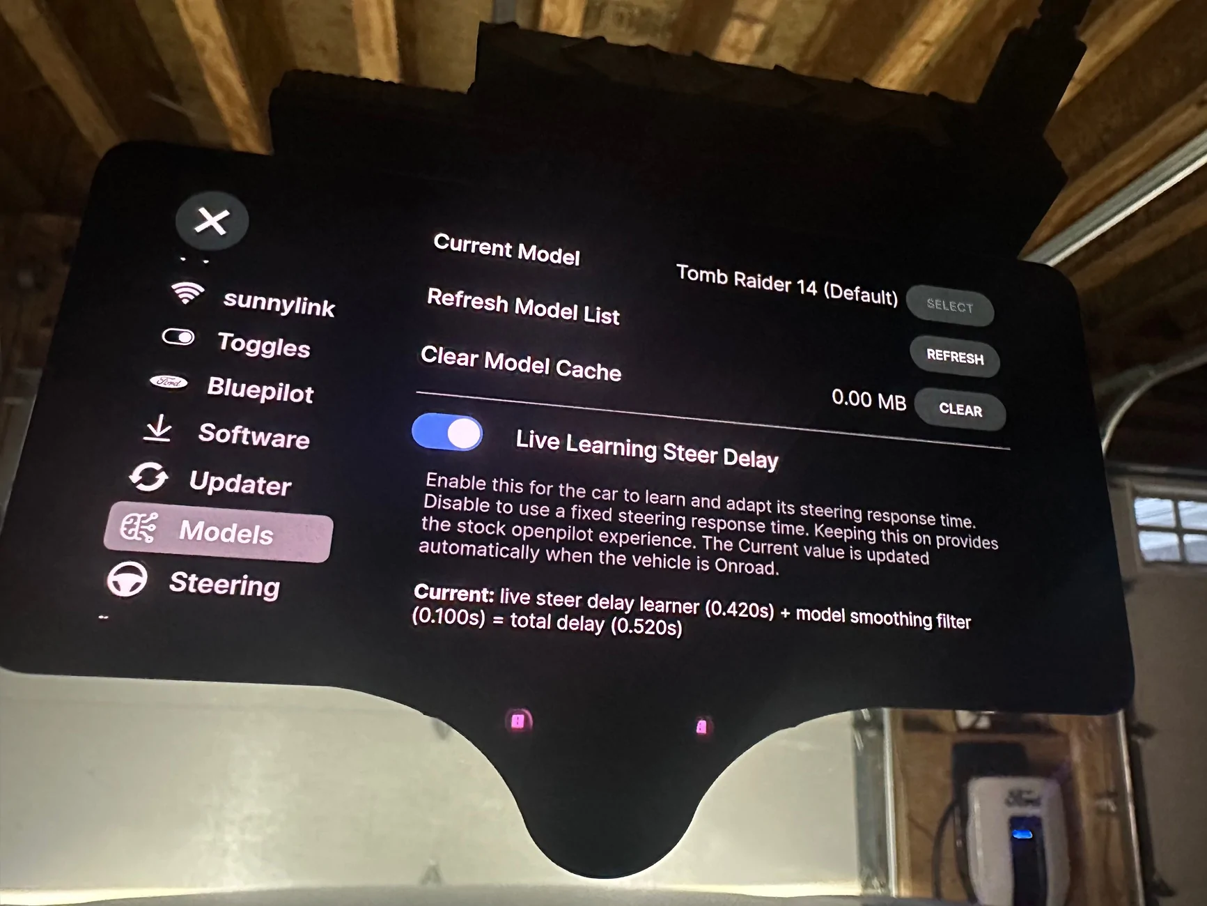

I just took the Comma out for its maiden voyage! It did pretty well. I did find that it wanted to hug the left lane a bit. It also cut a left curve a bit too tight and started to cross the line a bit.
I know I saw on here settings that can help with this, just need to search more to find where I saw them.
Overall, I'm really impressed. I can't wait to get the coupler so I can start getting the errors on the cluster. But for now, this is working well as a replacement for BlueCruise.
start with checking what AI model is selected.

Did the in-lane offset not fix hugging left?
It helped it a little bit, (those are screenshots from this morning, after I sent that original post). However, now there is a slight "ping pong" effect in the lane centering. It isn't horrible at all (basically the same as Blue Cruise itself).
Have you tried without custom tuning profile enabled?
