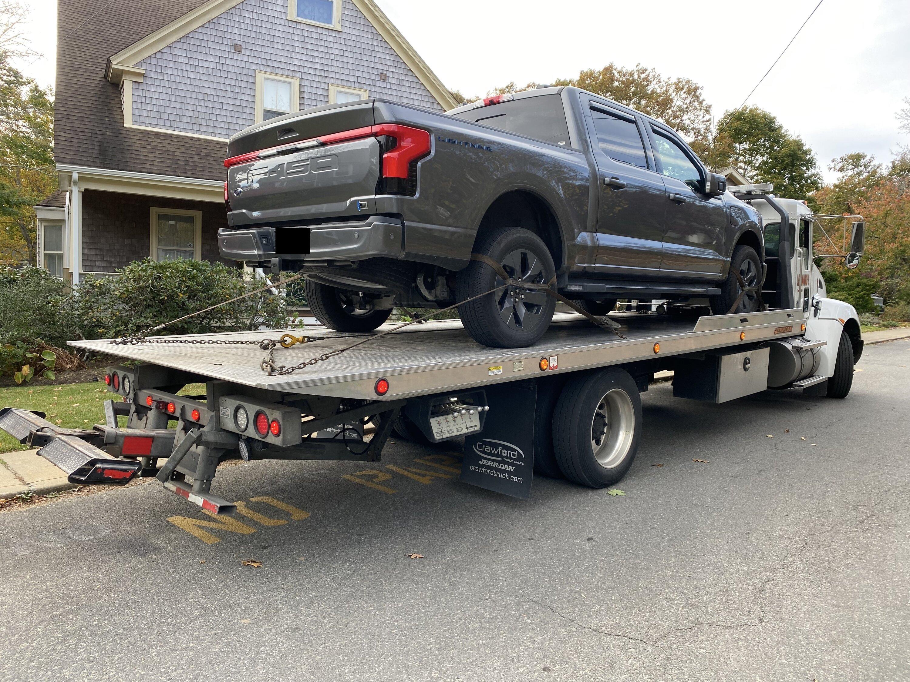

Made an account just to get on this thread.
22 Lariat ER, build date was not involved in any recalls, and the notification for this CSP unfortunately wasn't easy to see on my app... they sent me physical mail about the tail light and dash mat, but not the high voltage battery CSP -- concerned by that a little... wouldn't have missed it if they had been consistent.
The other night with the 6.2.0 OTA update, started the truck and immediately got the Powertrain Malfunction/High Voltage Battery warning combination. I can't imagine they're related but either way it's on the way to the dealer to figure out. We'll see what they say once they take a look.
Ford F-150 Lightning CSP-23B57 for High Voltage Battery Notice tow
Welcome to the forum, sorry it had to be this event ..... what part of Mass are you in?
massmedic
Nov 2, 2023
Massachusetts
2022 Lariat ER
Thanks - over on the Vineyard actually, which made dealing with this CSP after it affected me an even bigger issue! I purchased via Balise in Hyannis (great experience overall during delivery last year, and super responsive during this). Seems all of the dealers in this area are backlogged dealing with this CSP among other recalls. Balise has me officially on the docket for a week or two from now, and the next two closest dealers all report mid December (Colonial) and January (Wareham) as the earliest possible servicing availabilities... and all three have said they are only working with one EV tech, so that's not going to help with efficiency of these CSP issues everyone's coming in to them with.
I will also say that to Ford's credit, even with the added logistical headache of a ferry, the BEV team was very helpful and took care of everything related to the tow and the ferry trip.
