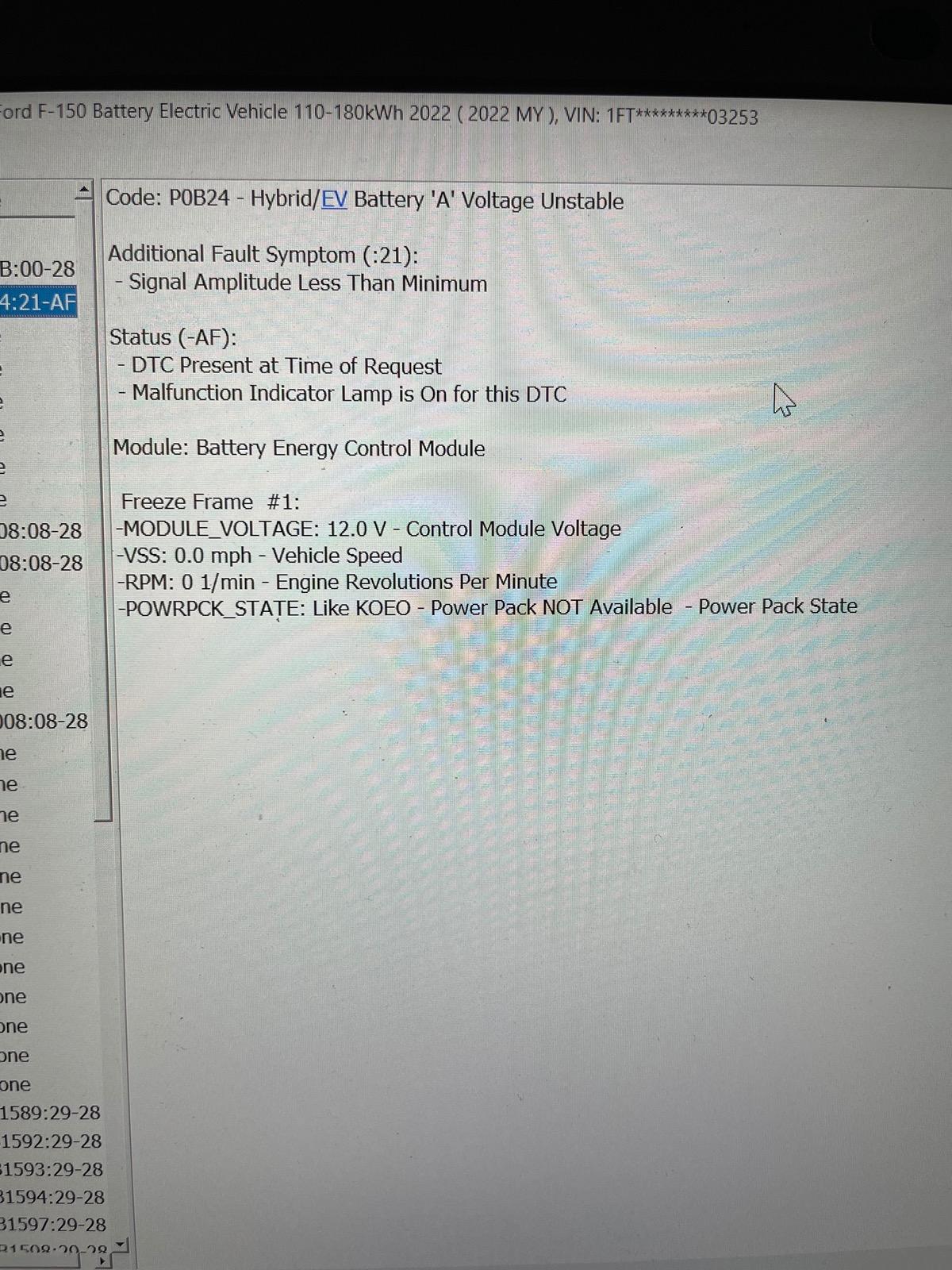

I had the dealer do this update via Mobile Tech on 12/8/23. Got the Powertrain malfunction 3/29/24. Like you, I'm not sure whether the update makes the truck more sensitive or, when the error occurs, allows us to still drive with reduced power.

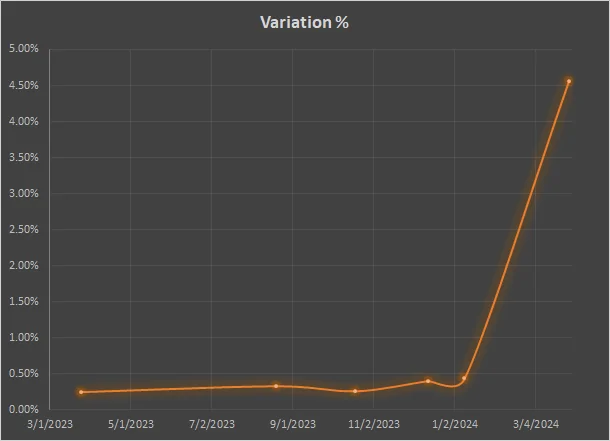

I have been tracking certain battery characteristics for a year using Car Scanner. You can see it was a relatively sudden occurrence, everything was within spec back in January (but % variation had been creeping up).
DateOdometerHVB SOHHVB Age (months)HVB Module Var. (V)HVB Module Var. (%)
3/25/2023214499.5%5.950.010.25%
8/20/2023476599.5%11.010.010.33%
10/19/2023536599.5%12.980.010.26%
12/13/2023643699.0%14.780.010.40%
1/10/2024667599.0%15.70.000.44%
3/29/2024750099.0%18.30.094.56%
I had Mike G pull the Battery Health test the dealer performed on 4/3 and it shows the voltage deviation on cell 62 is 0.134 V from average. That's in Module 6 which the dealer is in the process of replacing.

Yep, seems to be unpredictable.
X-Y chart of above
