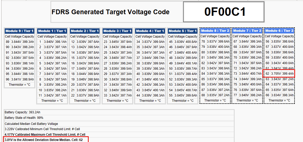

I sent Mike G my VIN and he was able to pull the Battery Health report my dealer did. Shows cell 62 in module 6 below spec. Dealer is replacing module 6. You might see about getting that report from the dealer or Mike so you can see what the true situation is.
