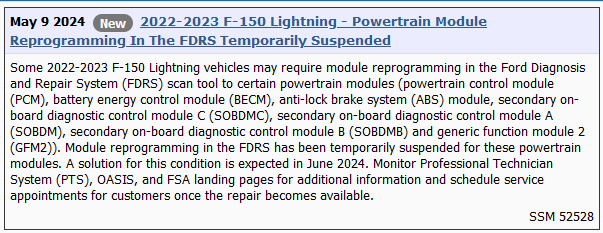

This just in...the FSA 23B57 has been put on hold temporarily.
From what I understand it's just until they sort out the powertrain software and release an update.
Message in OASIS this morning:
I was scheduled to go to the dealer today to have them take care of 23B57, 23B70, and 23B50. Got a call from the service advisor this morning, he said that both 23B57 and 23B50 had been put on hold. They were able to take care of 23B70, the BMS replacement. This was the first I had heard about 23B50 being on hold.
The BMS replacement (23B70) is a 10 minute sensor replacement requiring no programming at all (not even a BMS reset, strangely enough).
But both the 23B57 and 23B50 programs require the powertrain modules to be updated.
So they don't want anybody updating Lightning powertain modules until they have put out a set of revisions to address issues they are currently seeing in the field.
So after that new set of powertrain updates comes out they will knock out both the 23B57 and 23B50 programs by doing one powertrain update to fix both of the original issues that those programs were separately intended to address.

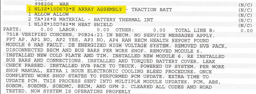

Pinpoint test completed, "array" on order (I asked for specifics). 2-3 weeks on parts.
So "array" is indeed the description of the battery module. I just got my truck back and here are the repair notes:

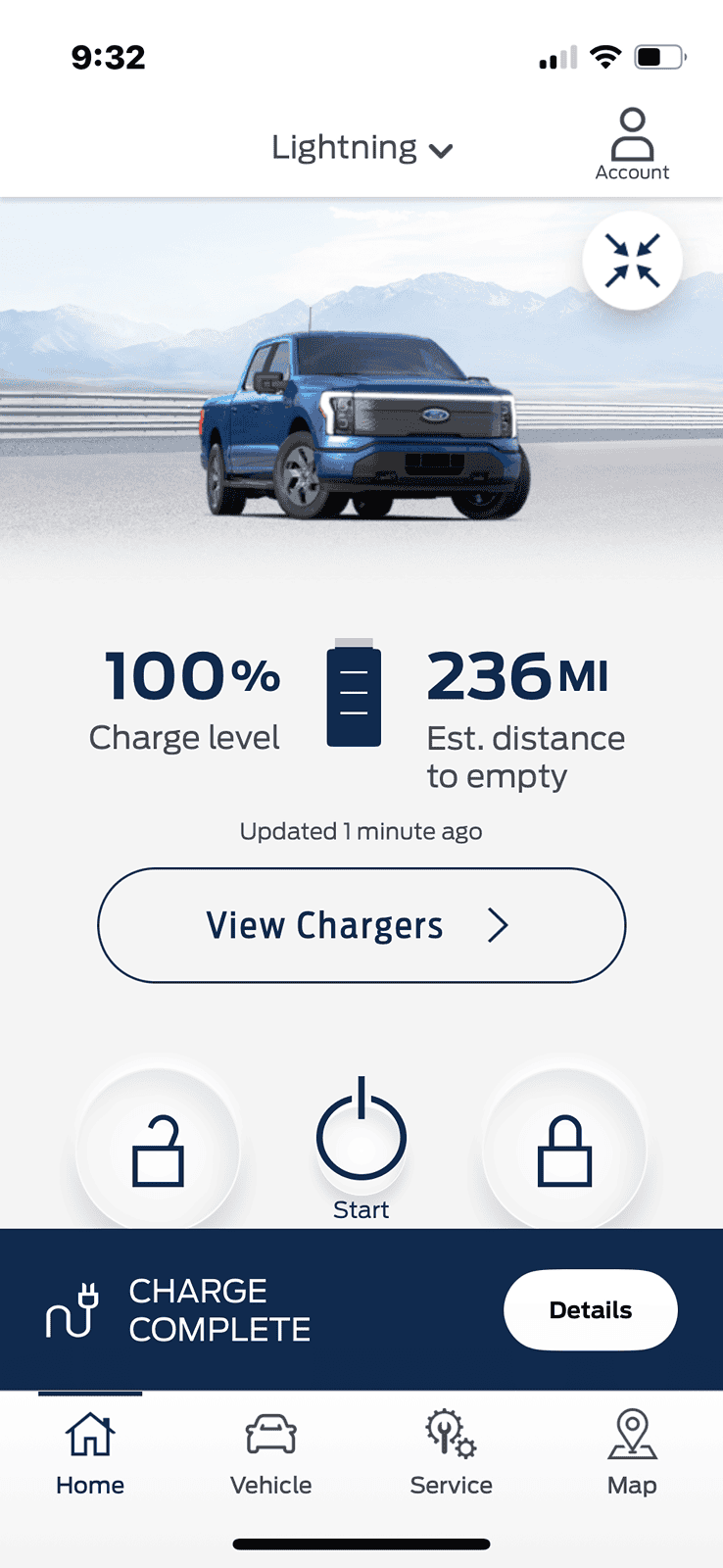

Until last night, my Ford App showed me that the battery was slowly losing power while it sat there, so the power went from 50% on March 25th to about 30%.
Last night the App showed me that the power was back to 50%, so they clearly charged it a bit. Then this morning, it recorded that they drove it about 3 miles.
The App says it's charging right now at a slow 5 kw AC charger and has been charging a total of one hour.
Hopefully this means they're done and are making sure it will take a charge without the Powertrain warning.
I miss my truck. I've got lots of plans that can't be done with the loaner SUV.

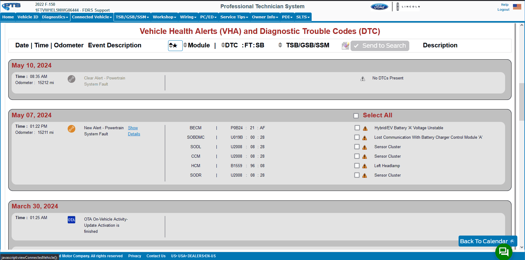

Not sure that's gonna happen today.
Here's the VHA from today, where they simply reset the DTC:
Ford F-150 Lightning CSP-23B57 for High Voltage Battery Notice 1FTVW1EL5NWG06444-10-May-24_VHA
Your truck still has 23B57 outstanding. I don't think the dealership can release the truck to you in the condition it's in. It would require them to fix whatever the battery imbalance is, and then update your powertrain software...which Ford has told dealerships not to do UFN. And to expect a solution in June.
