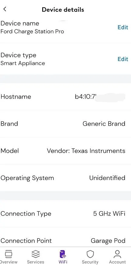

Keep in mind that once the FCSP has established a good connection to a host network, it ceases broadcasting it's SSID publicly, the only way to view it is via the Ford Charge Station Setup app.
You can also see it on your wifi network control panel as a connected device, IIRC it's listed as a Texas instruments device, I renamed it to something logical like FCSP.
Good luck.

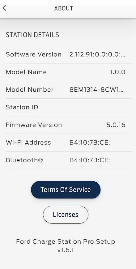

View of my FCSP via Xfinity wifi router, I use a POD extender to enhance signals to my detached garage, FCSP Setup app station details scree, shows you the software version, you'll likely get an update ~24 hours after first connection to the network, a power cycle a couple days later will implement the software revision.
