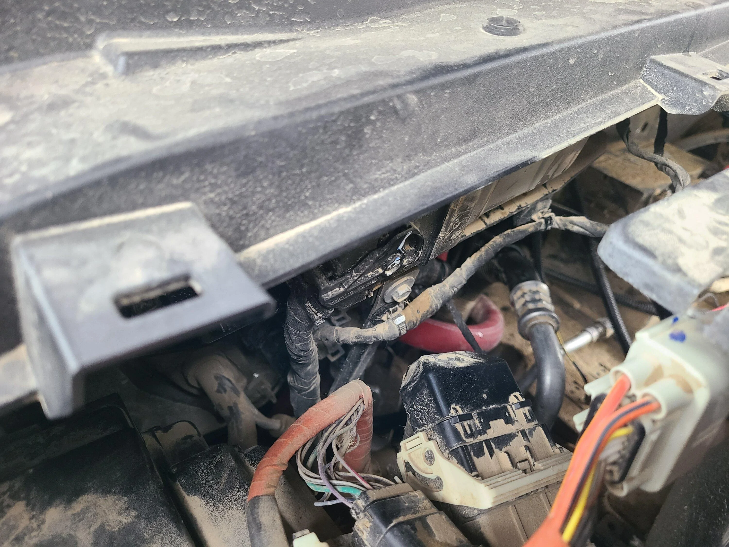

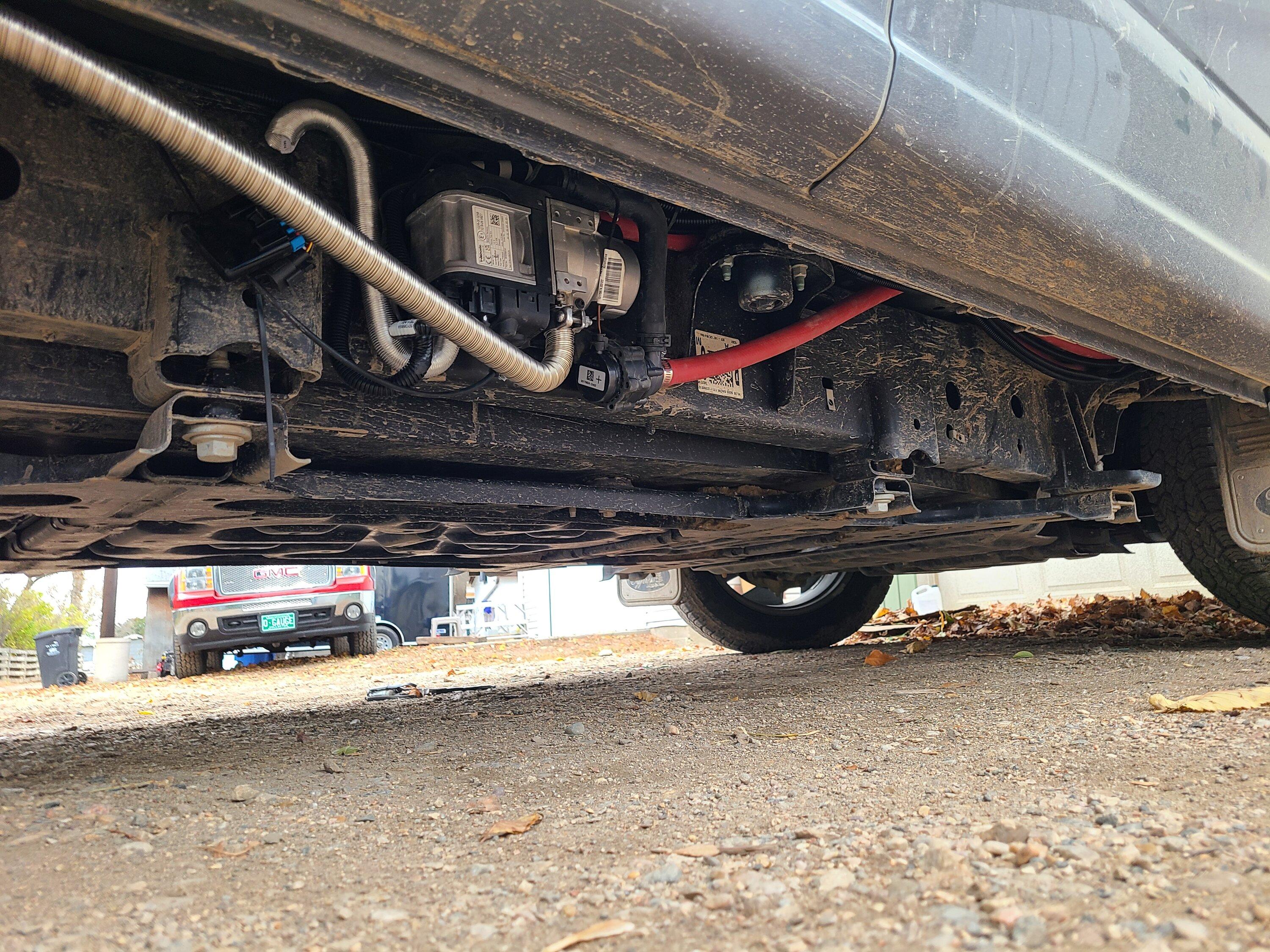

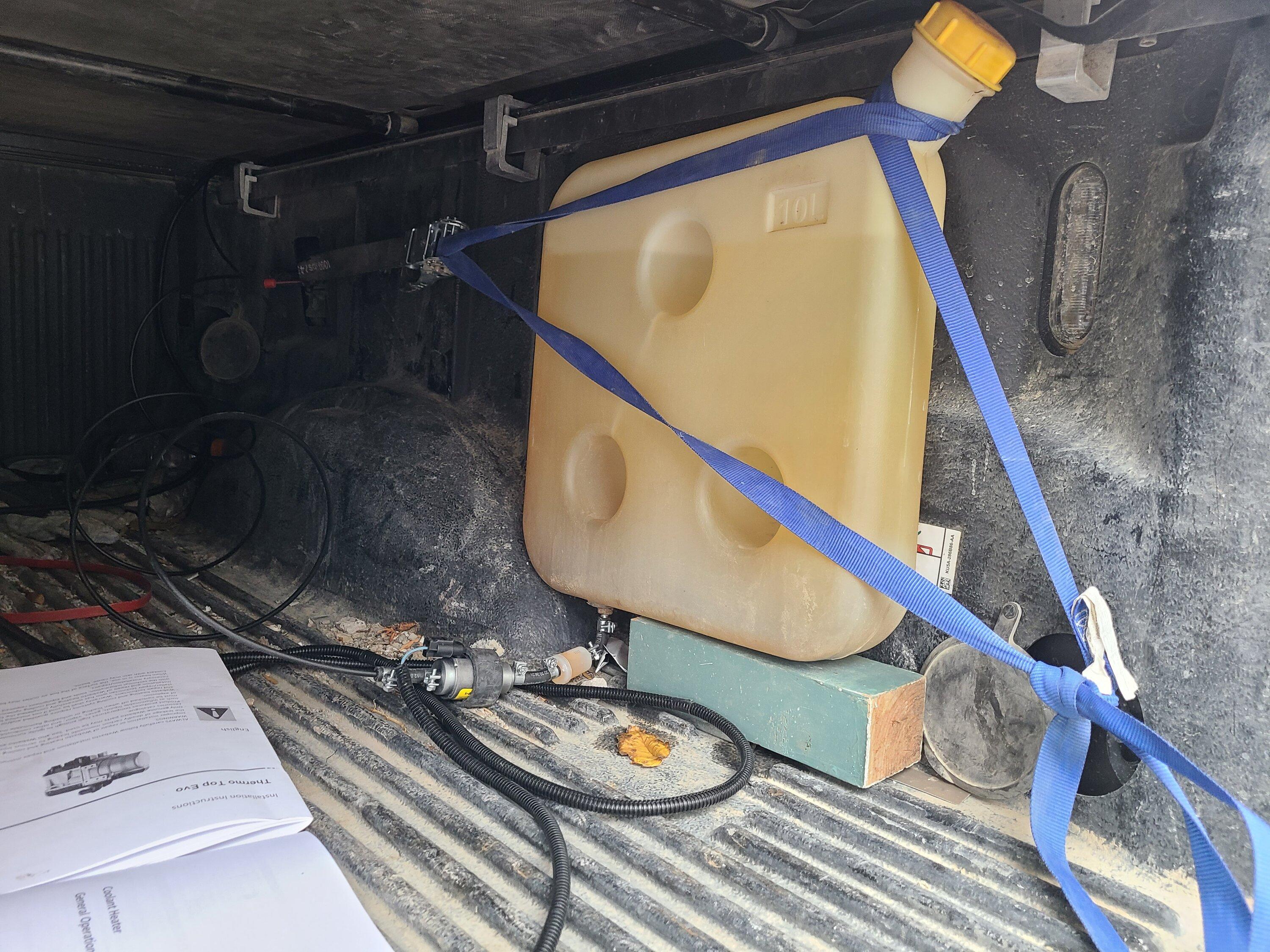

Doesn't get extremely hot in the cab which is ok. But to midly heat the cab and only uses 12watts I'm ok with that
It's not really ment for this but with a bit more tweaking I think it will be perfect
Right now everything is temporarily installed. Wasn't sure if it would freak out or not. Wanted it easily removable waiting for a check valve to stop reverse flow
Drove 140km in -2celcius weather and i had to turn it down because it was to warm. We will see at 30 below

Whoa I suggested in another thread that Ford could add a fuel heater for extremely cold weather. I never thought someone would be crazy enough to do it though!
Did you build it into the hot water loop of the truck? I don't understand from the pictures how the heat gets into the cab.
Sure did it's plummed into the heater core. So I just use the fan like normal and out comes hot air
