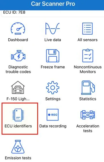

How can you find this info using Car Scanner? Do I have to install Forscan Lite? Cheers
To see the software version of any module in Car Scanner, click on ECU Identifiers.
Ford F-150 Lightning ECG-25.2.5.7.1 - Consistent Battery (LVB) Performance 1741357898373-b7
It will show a list of modules to interrogate. I usually go with the default list - but I think that excludes a few modules we really do have. It takes a while for the app to query them all and display the results. When finished, it displays the results. At the bottom of the screen is an Export button. I export the results to one of my cloud accounts with a date so I can compare.
You will see an ECU Software Number for each module. This corresponds to the Strategy number or the F188 value in FDRS that you see posted occasionally.

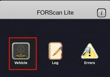

You can also use Forscan Viewer (free) or Forscan Lite (paid) apps. When you connect to a vehicle for the first time it interrogates the modules (can take a minute or two to fully connect). The module information will be under the Vehicle icon.

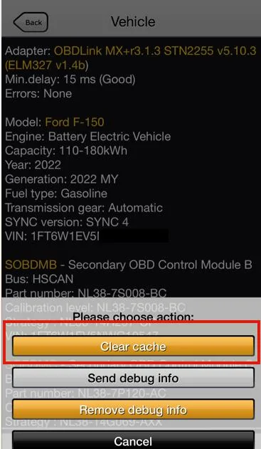

CAUTION: it only interrogates the modules the first time and then caches the results. Subsequent connections will use the cache (connects almost instantly). To force a new interrogation, you need to click the Vehicle icon, click the gear (settings) icon on the lower right and choose Clear cache. Then Disconnect and Connect again. You will notice it takes a lot longer to connect since it is interrogating again.

The results display more information than Car Scanner and I like when exporting it creates a file name with a date automatically.

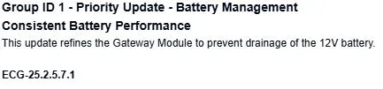

Using Car Scanner / Forscan Lite, I was able to determine this OTA updated my Gateway Module Strategy (F188) from ML3T-14H021-RCL to ML3T-14H021-RCP
@Mike G @rugedraw
EDIT: It's now even reflected in my online As-Built.
Just saw this a few minutes ago. Did not show up when I took a drive this morning and hit the Software Updates menu item in Sync for some reason, even though it said the event triggered yesterday afternoon. I'll go out and see if I can get it to install now.
Ford F-150 Lightning ECG-25.2.5.7.1 - Consistent Battery (LVB) Performance ECG_25-2-5-7-1
