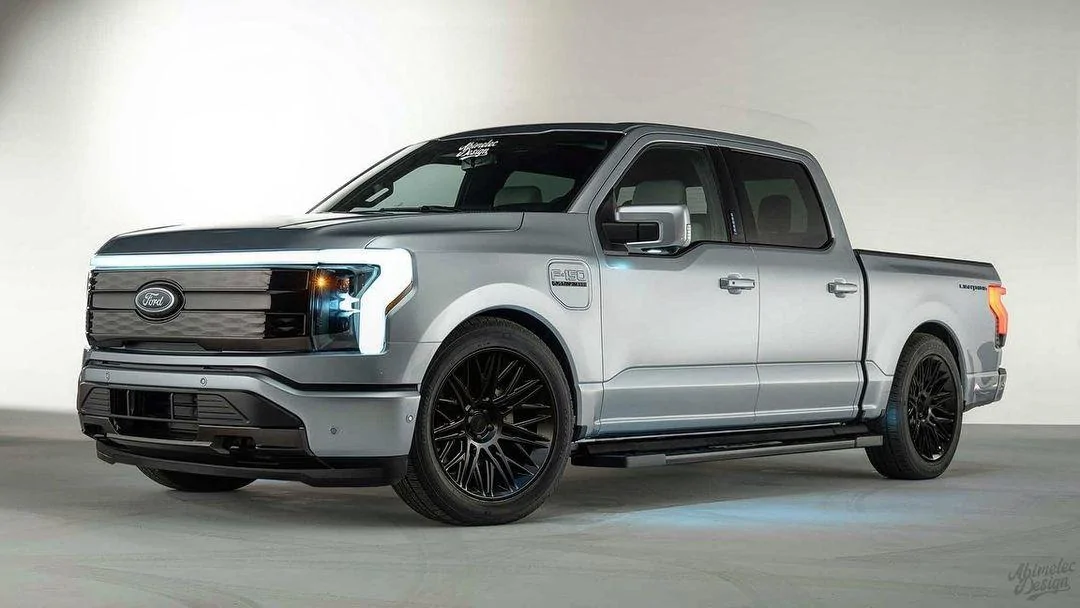

I'd like to see a setup that levels out the rear without a major compromise in ride quality. 2" or so? Here's a pic from Ford:

I like the low & mean profile, makes it look faster when the wheel well gap is eliminated.
So do I as I'm not likely to do any serious off roading with mine. The low look was a digitally produced pic I saw online. Likely 22" wheels if not 24". That's a bit too extreme for a pickup IMHO.

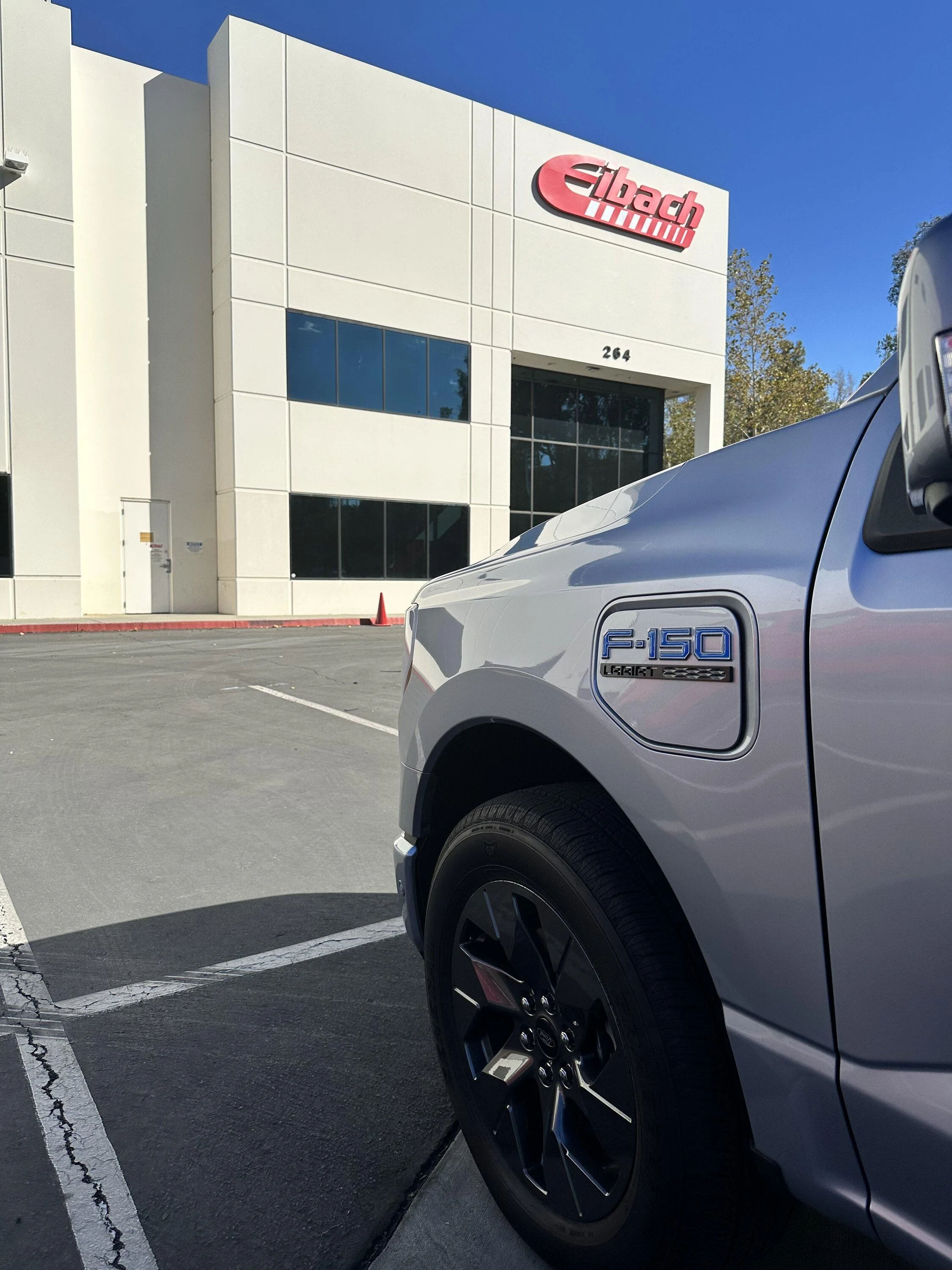

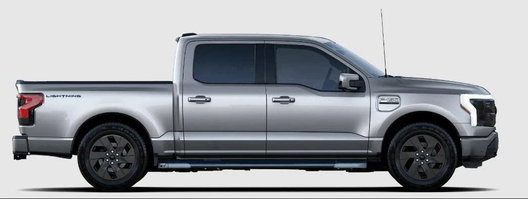

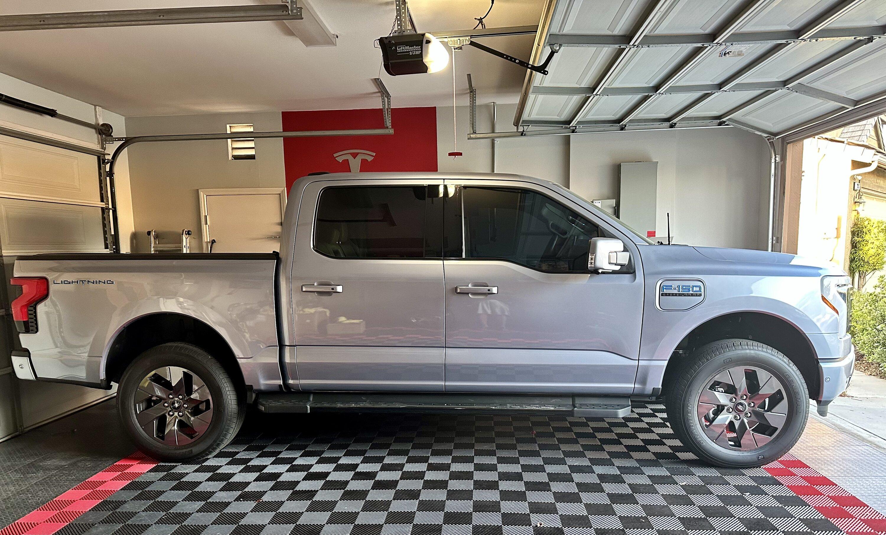

Picked up the Lightning today, prototypes are in progress. They did add the ICE F-150 shocks to the front for leveling, looks good to me. Rides a bit stiffer but has taken care of the bounce for sure. I’ll be driving this week and providing feedback on these. They informed me that OE ICE shocks came in at 500 lbs/in vs the Lightning 580 lbs/in, so the available Eibach leveling shocks should handle it appropriately. The lift from the front ranges from 0-2 inches. Stay tuned!
Before:
Ford F-150 Lightning Eibach R&D for Lightning lowering kit, leveling kit and lift kit -- submit your input 14D4756D-126D-4972-B81A-BFBDE77461F8
After:
Ford F-150 Lightning Eibach R&D for Lightning lowering kit, leveling kit and lift kit -- submit your input 1F84A879-B83C-45A4-A51B-6AA0047BAE1B
