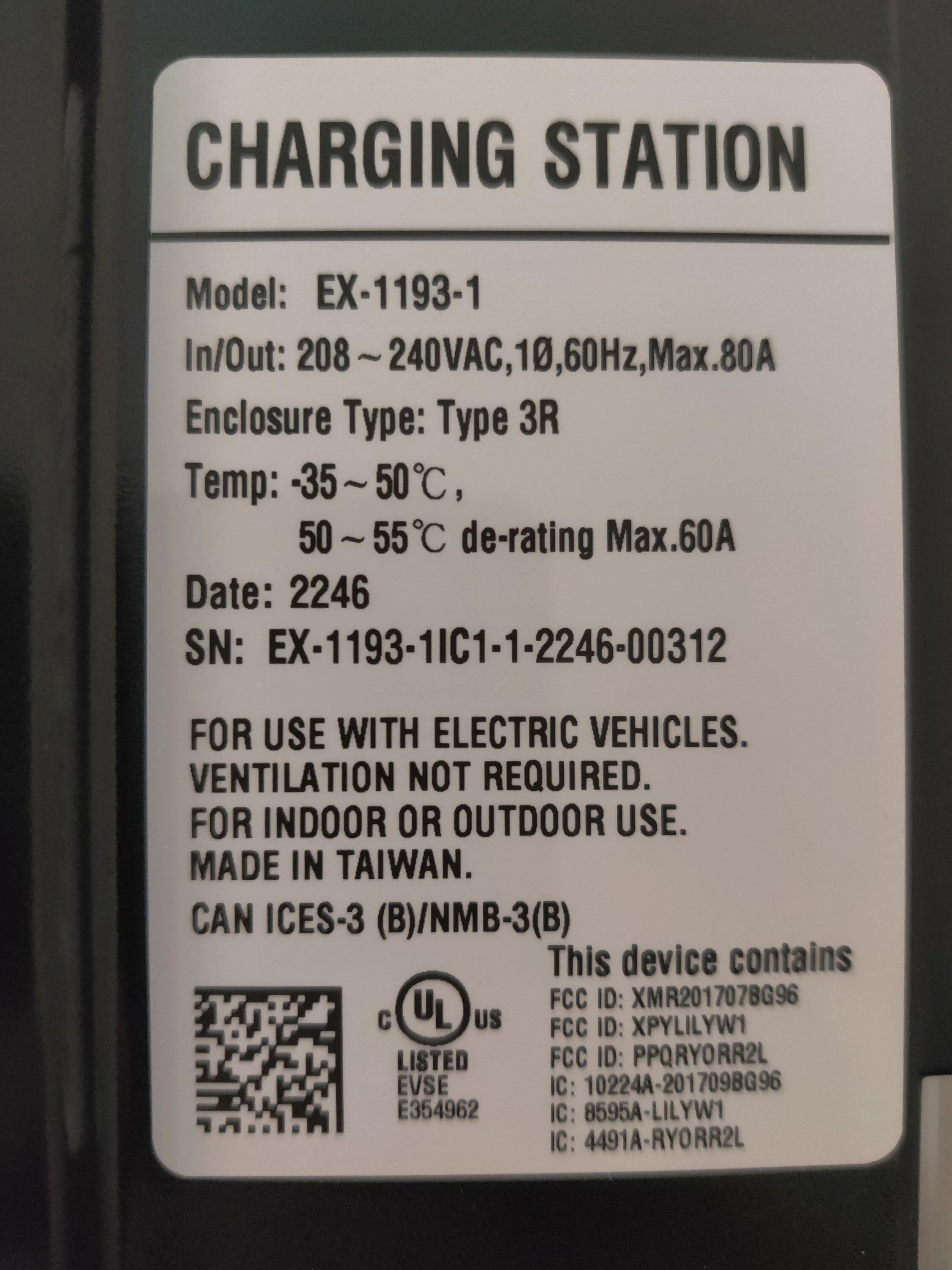

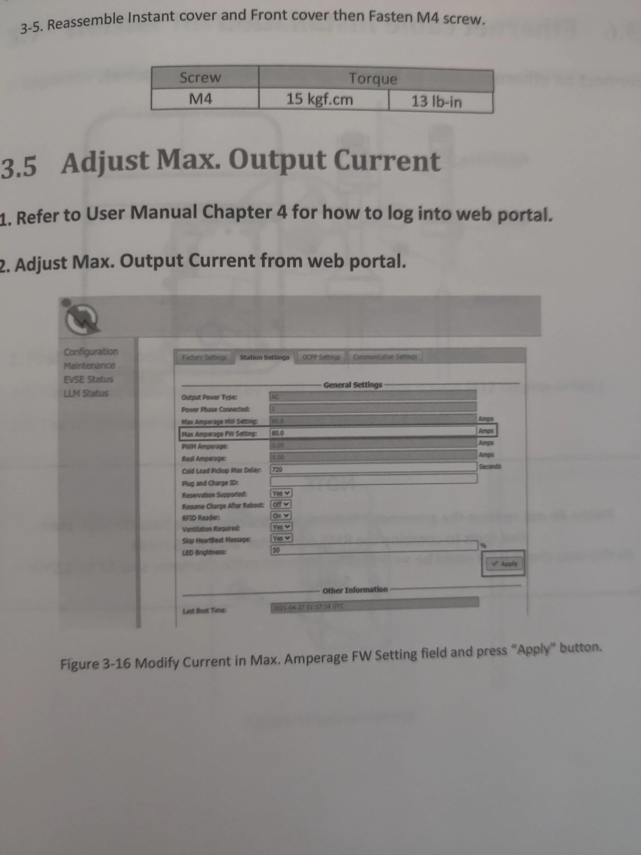

I have the Non-Ford branded 48Amp charger (Made by LiteOn) and I believe it's switchable from 48 Amp to 80 Amps
https://www.ebay.com/itm/404383430943
https://content.fordpro.com/content...Ford-Pro-User-and-Installation-Manual-48A.pdf
I'll go look in at it now in the garage now to confirm and if you need a 48 amp charger that may well be switchable to 80 amps, let me know, I'm in Massachusetts.
I have another 80 Pro Chrger for home and was going to use the one above at our place in Maine.
I mention because if the unit I have would work for you, I'd be happy to work out a deal and would also be ammenable to taking it back if "something was outta whack" so to speak.
If it can be switched between 48 and 80, you could just decide later :)
MANUAL:
https://inchargeus.com/wp-content/uploads/2022/12/inCharge-spec-sheet-LiteOn-80A-221130.pdf
LITEON
https://www.liteon.com/en-us/product/432
The instructions show that the output is selectable (see photo)
Ford F-150 Lightning FCSP or Another Level 2 Charger? IMG_20230928_095252
Ford F-150 Lightning FCSP or Another Level 2 Charger? IMG_20230928_095814
