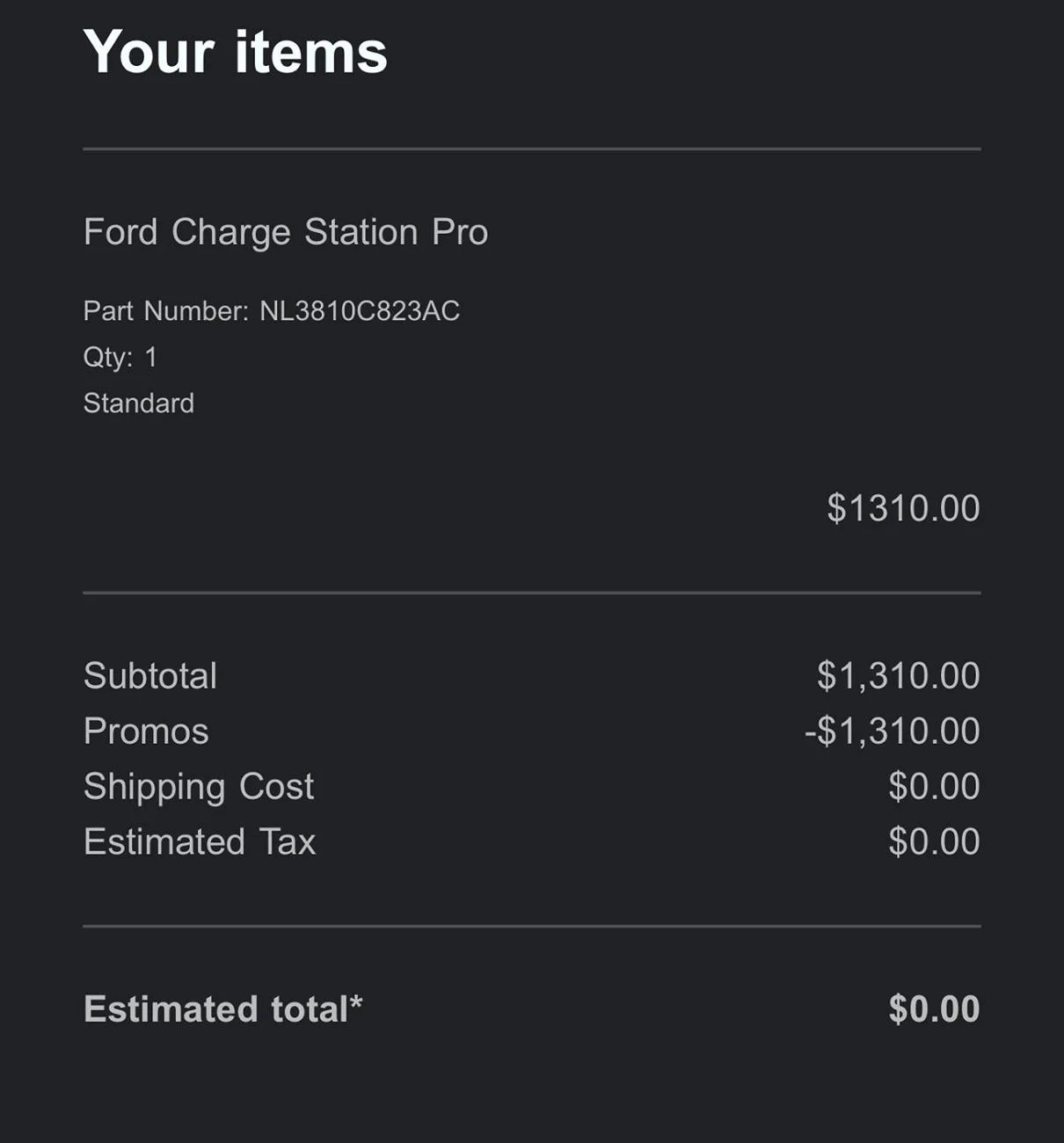

Just got my 2025 Lightning 2 days ago (HYPE). This topic may have already been beaten to death so if someone has a previous post I can read linking it would be great.
With my Lightning purchase I got the Ford Power Promise. The dealer advised it could take any where from 2 weeks to 3 months to get my charger and installation completed. So I am curious if anyone has purchased a Lightning recently in 2025 what your wait time was for the arrival of your charger and installation?
Thank you in advance!
So just an update. I received the code in my email from ford last night. Went to the website and added one to my cart. Put the code in and it balanced it out to $0. Just a tip for anyone else doing this. The code won’t work if any other discounts are auto applied. You have to remove all discount codes then add in the one ford gave you.
