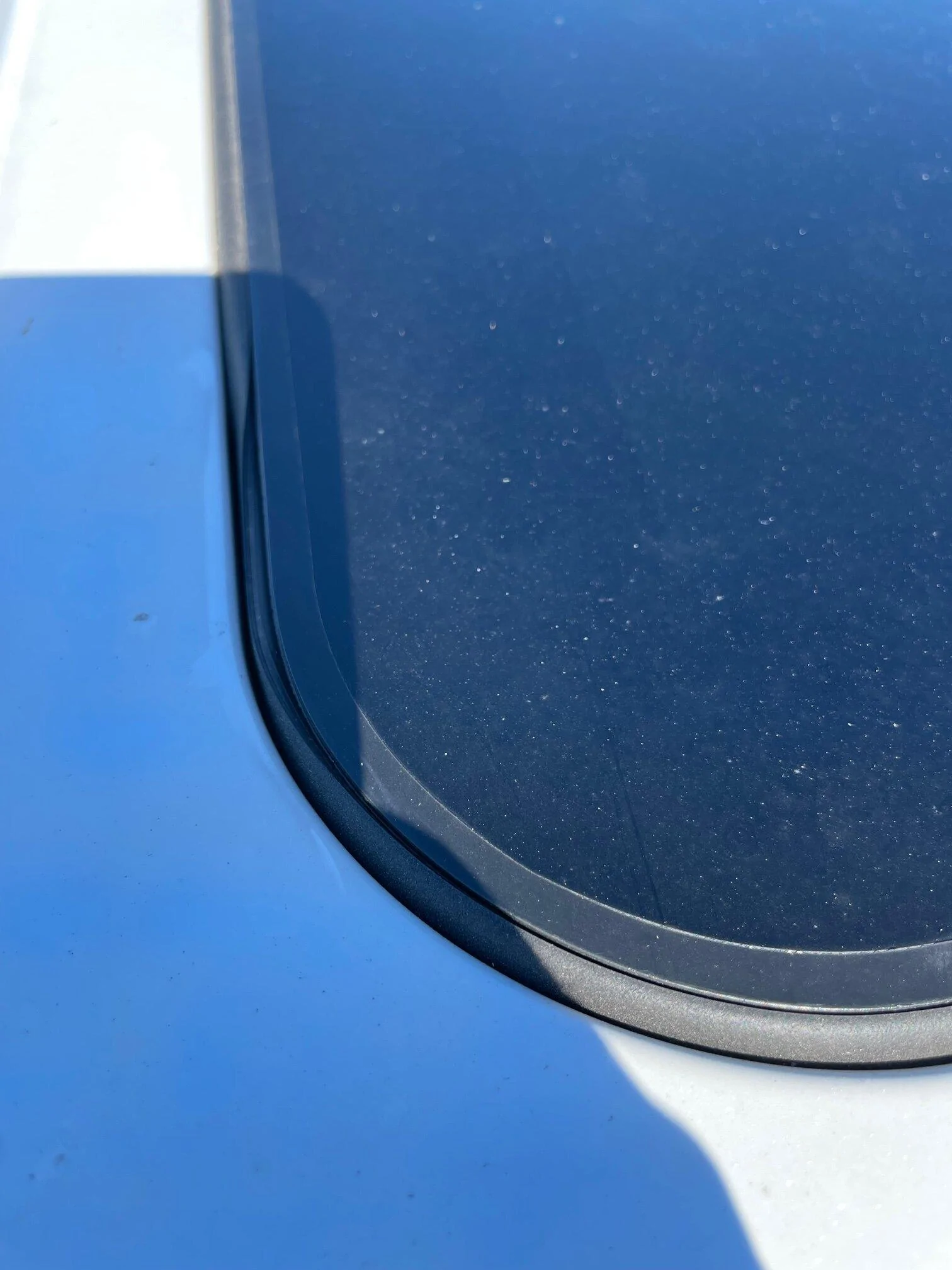

I always try to buy Fords without sunroofs due to all the leaking horror stories. Unfortunately this was not possible on the Lightning Lariat. Decided to check out the sunroof today for the first time and left rear corner seal has issues. Argh.
No mine does not leak (yet). Amazing how poor the installations are. Is this normal or acceptable? How does it get past QC?
I agree with you, quality issue on the seal around the sunroof is a problem, but what are our option if it doesn’t leak?
Bring it to dealer and have them replace the seal and risk a worst than before problem. Or leave it alone since it is brand new and and does not leak inside. We have 3 year or 36k mile warranty so I figure just keep and eye on it from time to time and wait and see.
