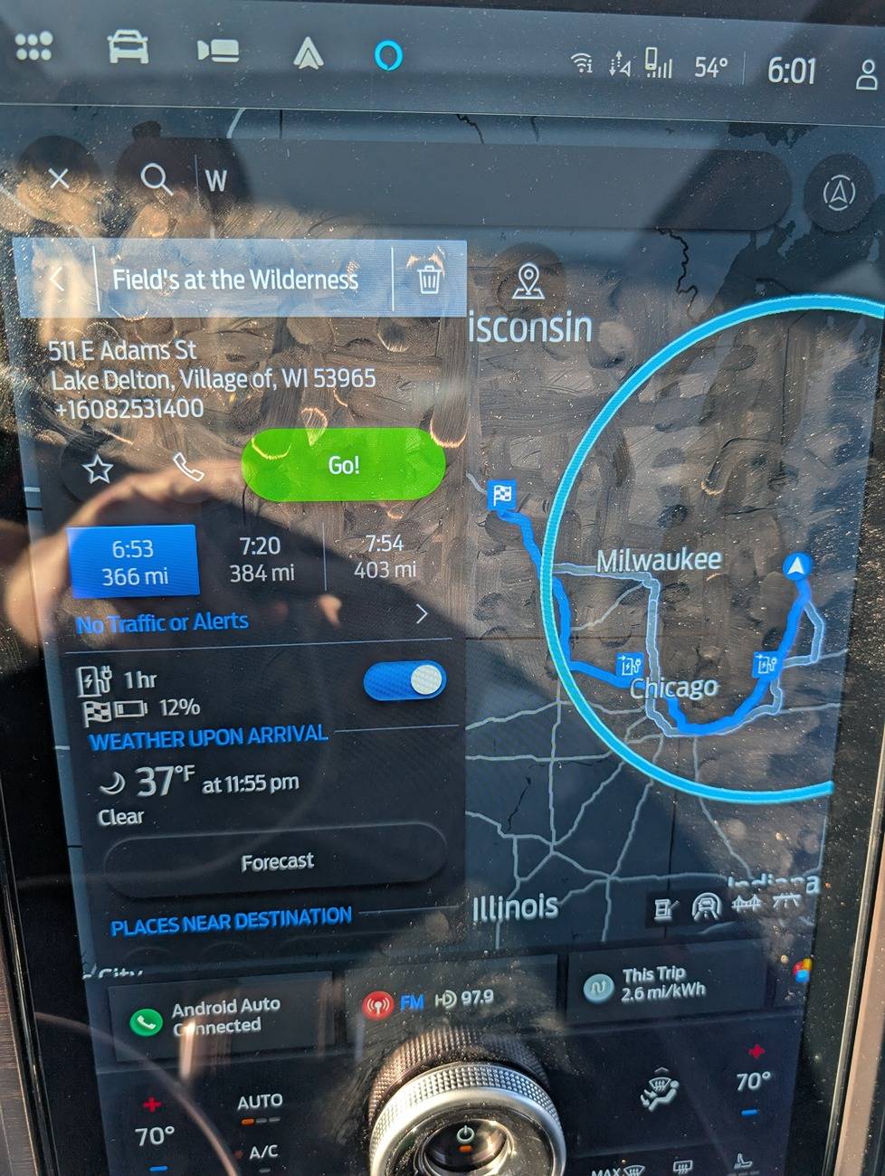

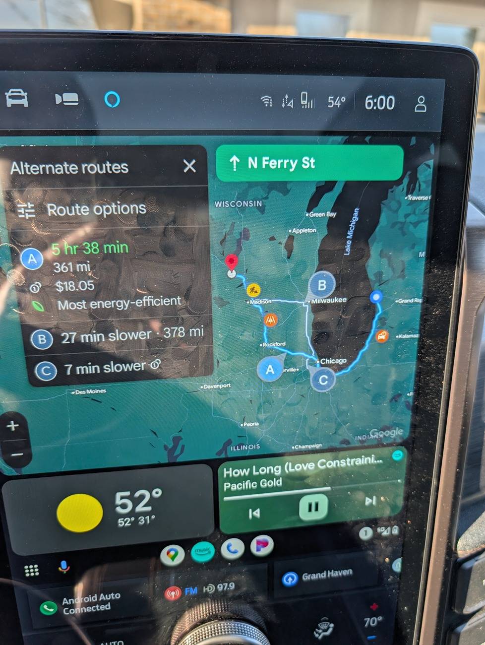

Hi,
I've been struggling to get this to work.
I have a pixel 9 that pairs fine with the truck, no Android Auto issues.
Google maps loads fine and plots directions fine.

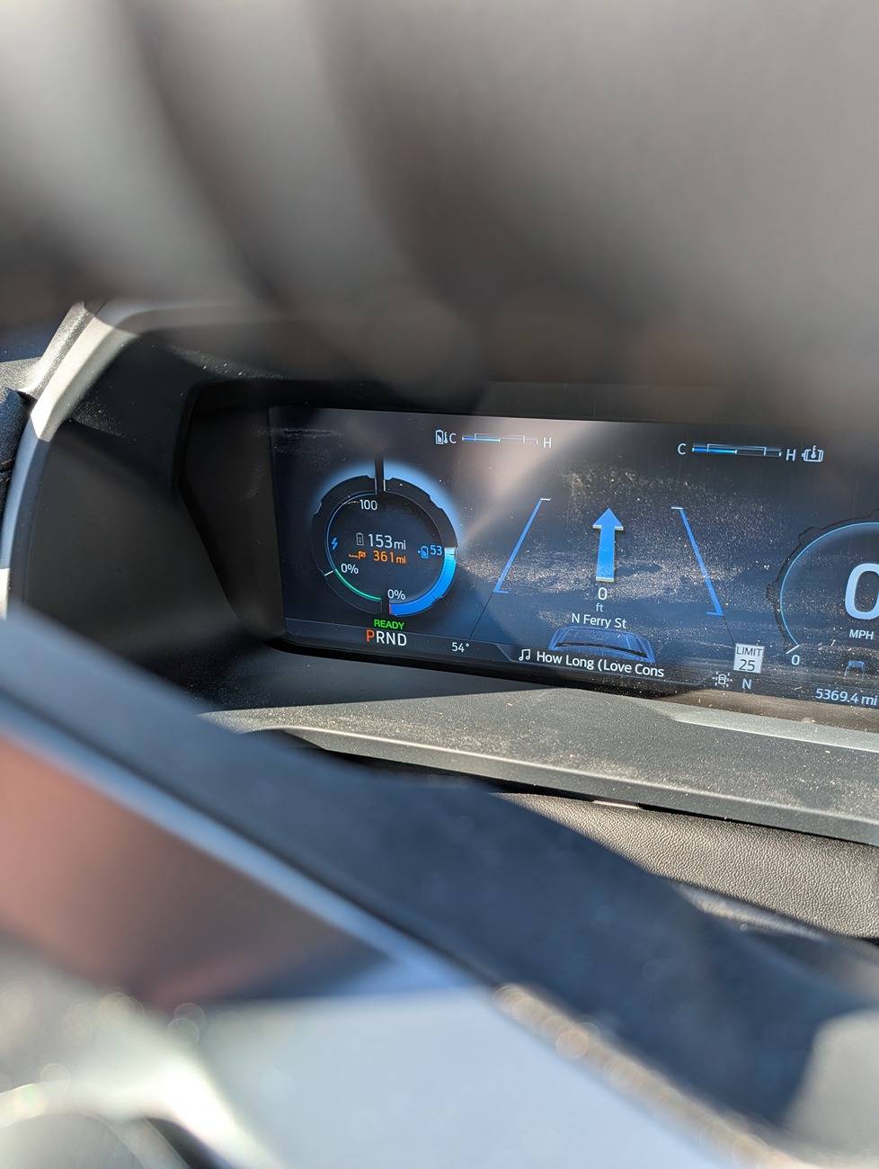

But it won't plan stops. I'm entering the destination in the Google maps on the touch screen in the truck and the truck knows the destination is too far away (orange under range remaining)
Ford navigation works fine and plans the stops.
Any suggestions of what to try?

Route C will have a couple more tolls but will be faster unless you hit downtown Chicago at 2am

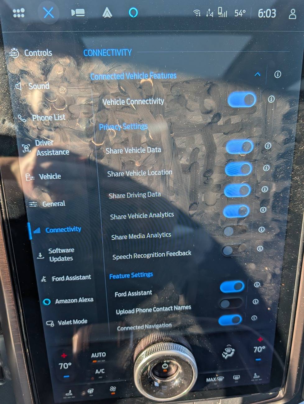

I think there is a Sync update that you need to receive for Google Maps to show the chargers.

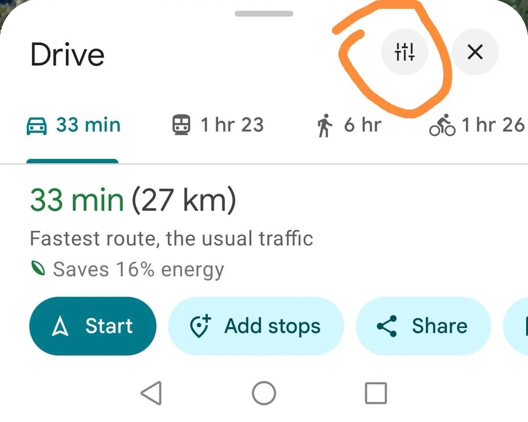

You didn't have any selected on your google maps route. Try viewing gmaps in full screen and add the stops.

Not sure I understand what you mean. Yes I can add a stop to maps and those can be EV charging locations...but I was under the impression EV routing would add them automatically, where I need them and how long I need to charge like Ford navigation or ABRP.

This is not working on my 24 Flash also, even after 10.1.1 so I think they have not pushed some part of the software udpate that enables this feature in Android Auto yet. Even though it says it requires 10.1.0 in their own help documenation... its quite confusing and frustrating.

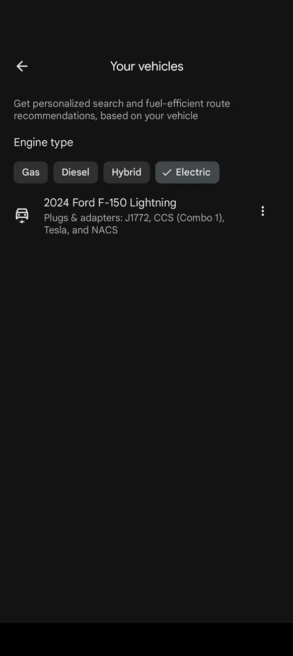

On your phone, set up a drive and check the settings under "your vehicle"

Ok. The truck is set up there

This is the point I've reached as well. Sync and gmaps software updates confirmed, truck setup in gmaps with connectors added but no EV charging stops or battery percentage. Ford support is blaming Google.

For someone who has this working: Off topic slightly but under plugs and adapters, he checked Tesla. I just chose NACS (and CCS1). Will choosing Tesla give you stations that we can’t use or does Maps know those as well?
