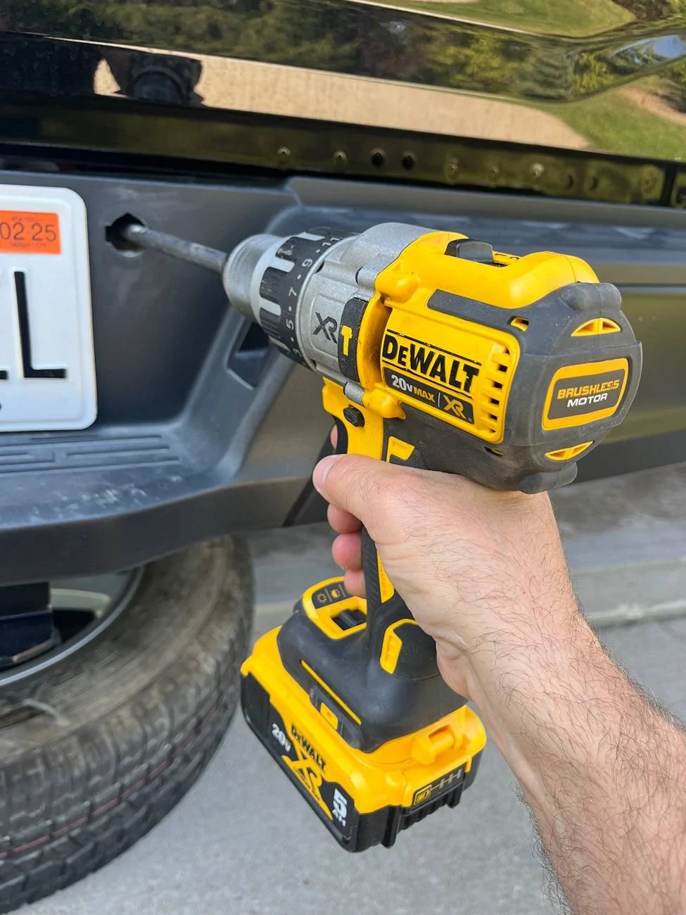

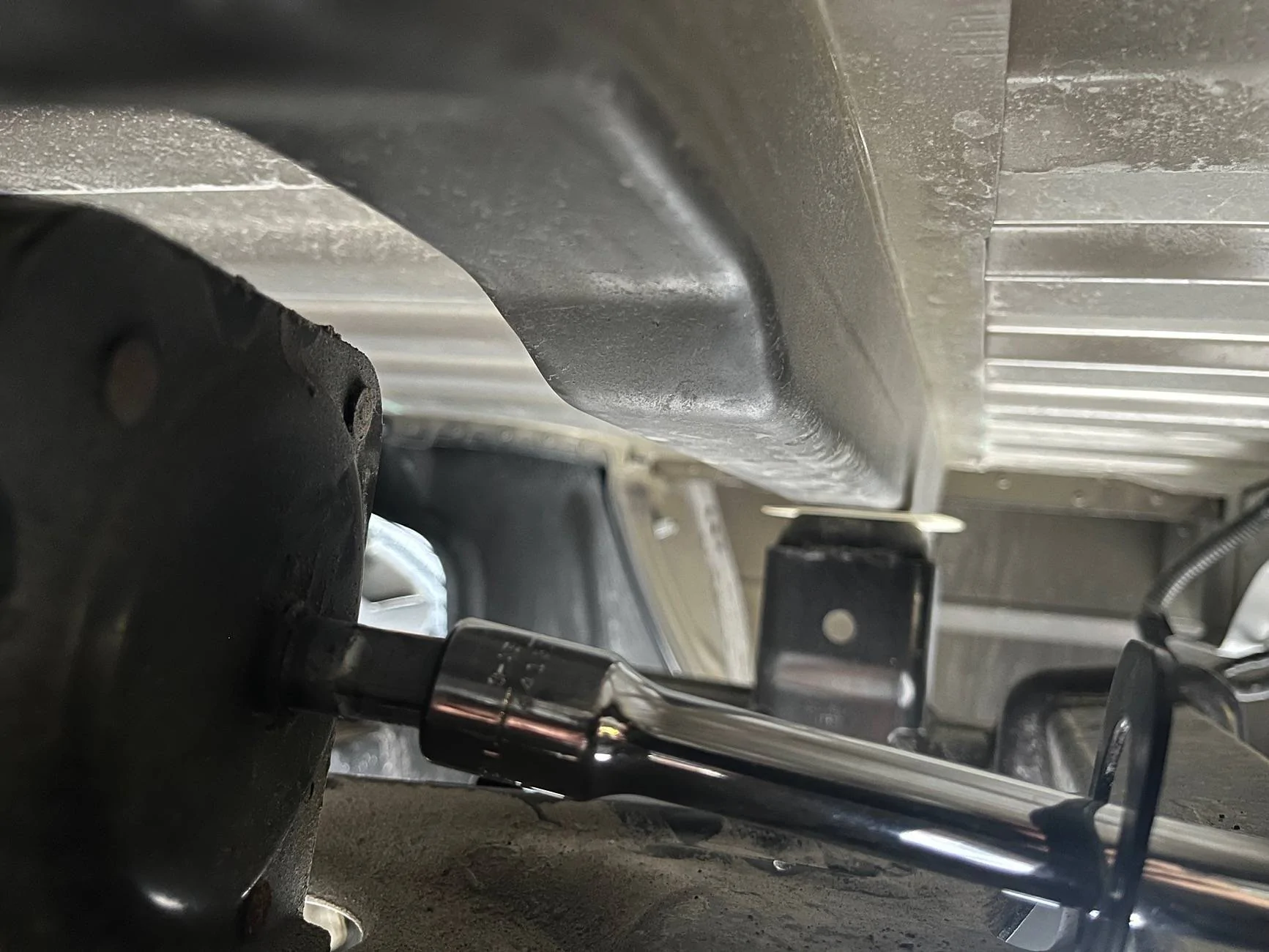

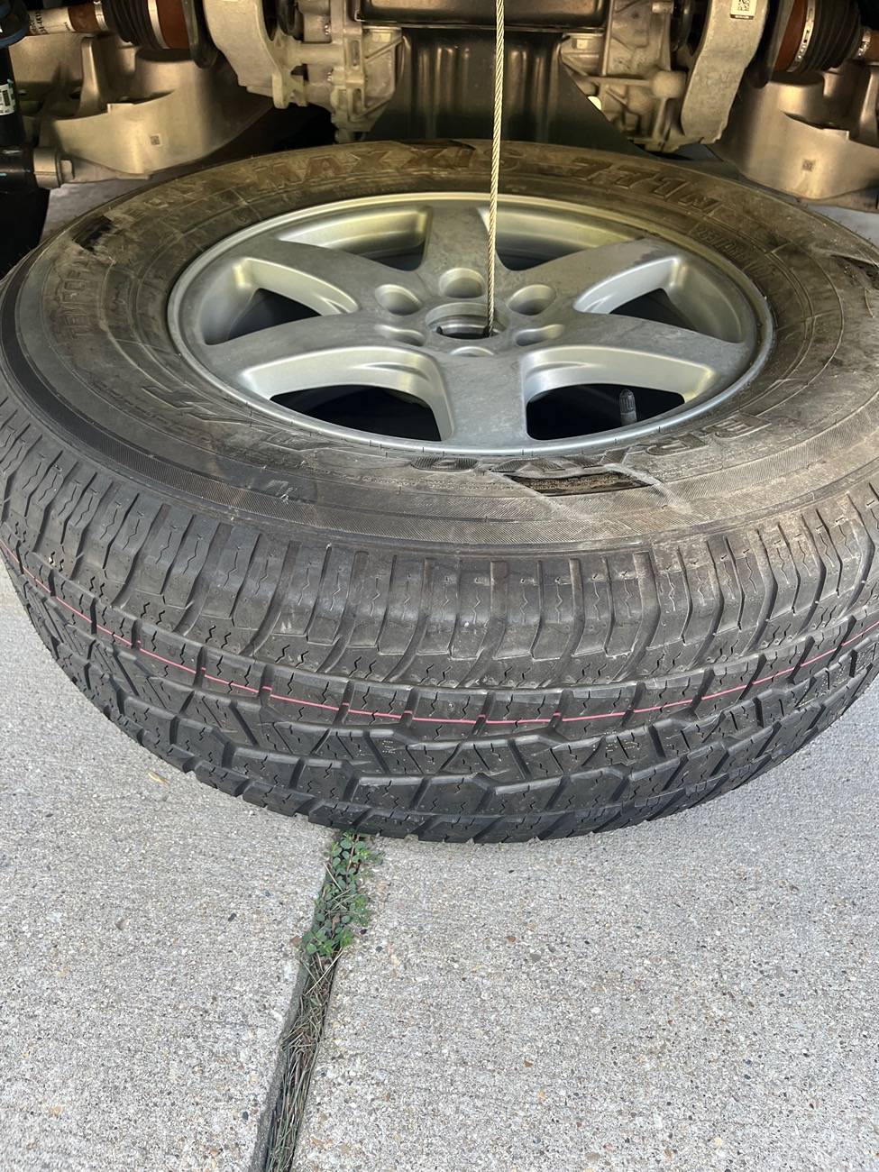

Ok, so I’ve owned multiple F150s since 2006, and maybe I’m slow, but I never knew this hack before today.
I’ve always lowered the spare on occasion to keep the mechanism free and check the condition of the tire, but now with my Lightning I do it every rotation and incorporate it into the process and then put it back away. This allows me to jack one wheel at a time, which is easier with the lightning.
We all know getting the jack kit out and then put away correctly is a pain. Turns out the tool is the same diameter as a 3/8” socket! So, I cobbled together all of my extensions, and then chucked them up backwards in my drill, ran it in reverse, and Wahlah!!!!!
So much faster and easier than getting that stupid jack kit out!
Sorry if this is an already well known fact!

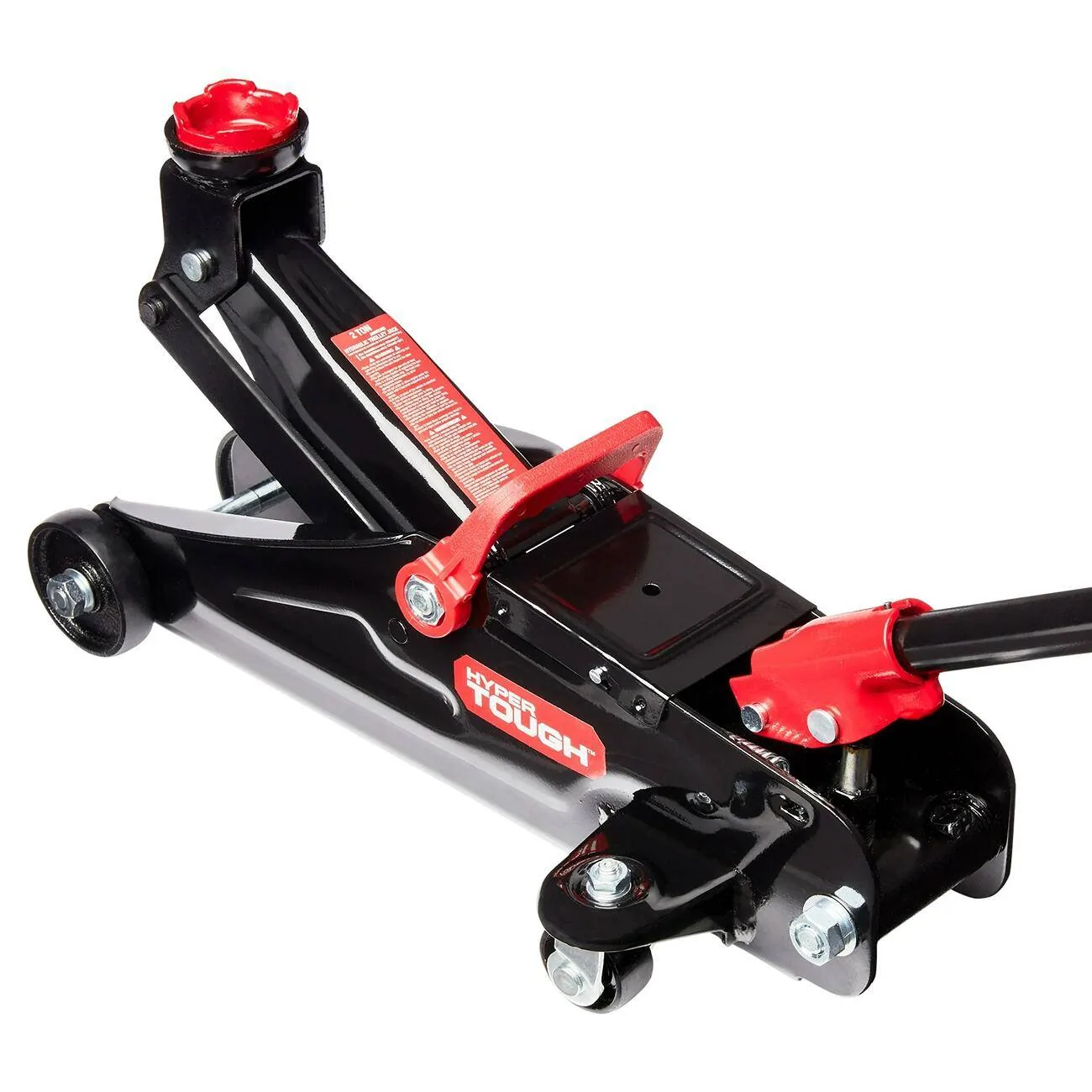

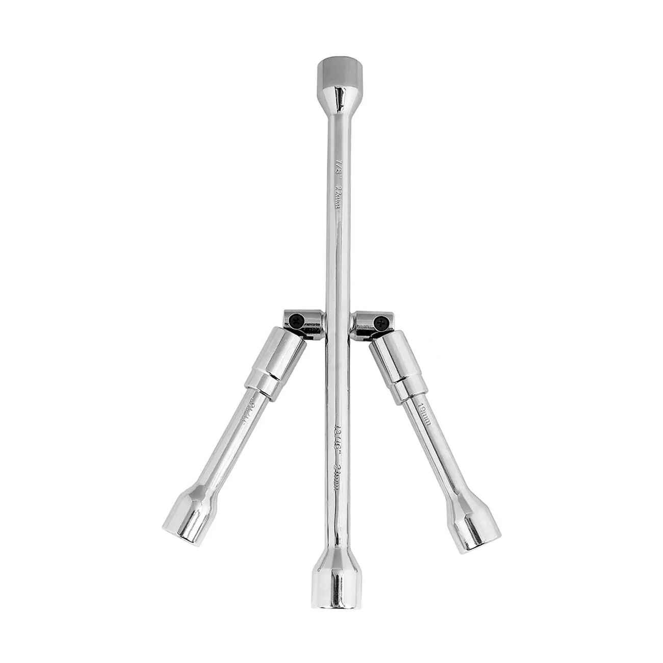

I guess now I'll have to my OEM 'jack kit' back in my truck : /
I replaced it with a more robust JACK LIFT, and 4-way foldable lug wrench, which is much, much better and easier for ANy vehicle, ESPECIALLY this high-stance truck frame... oh well...
I guess I forgot all about how to 'get to' the extra tire : )

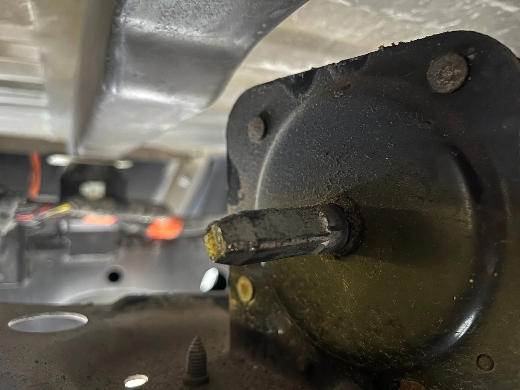

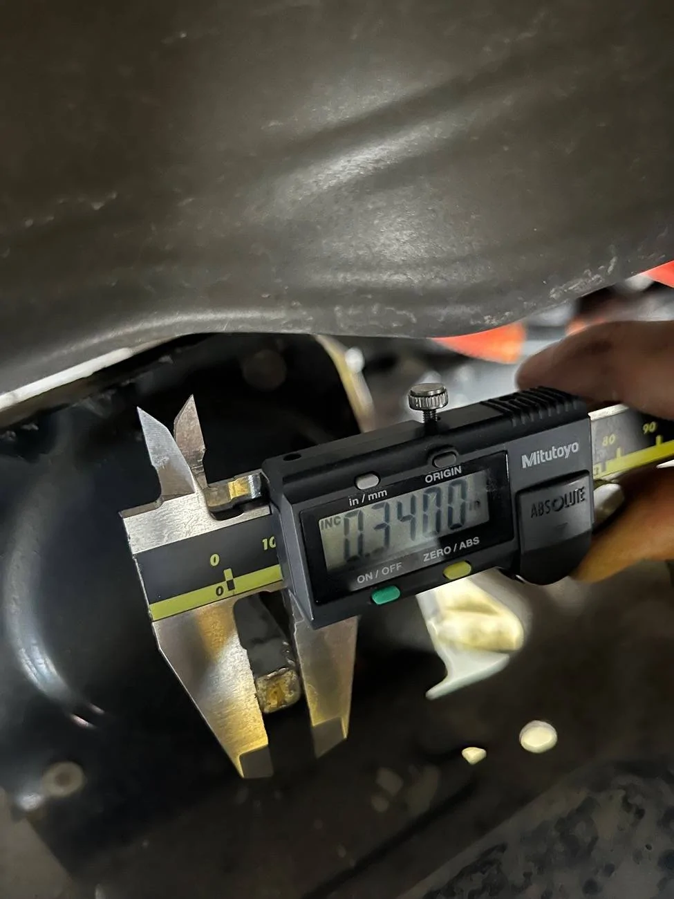

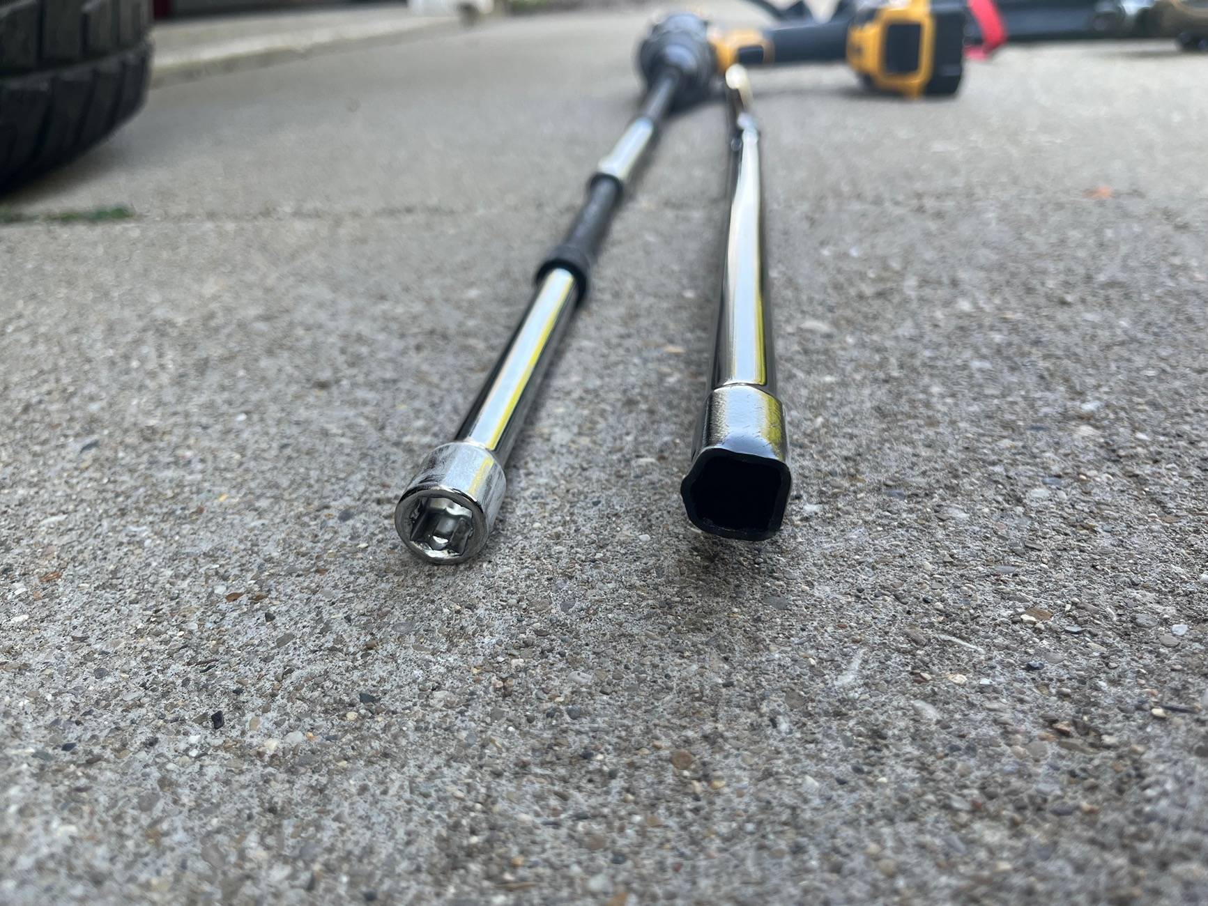

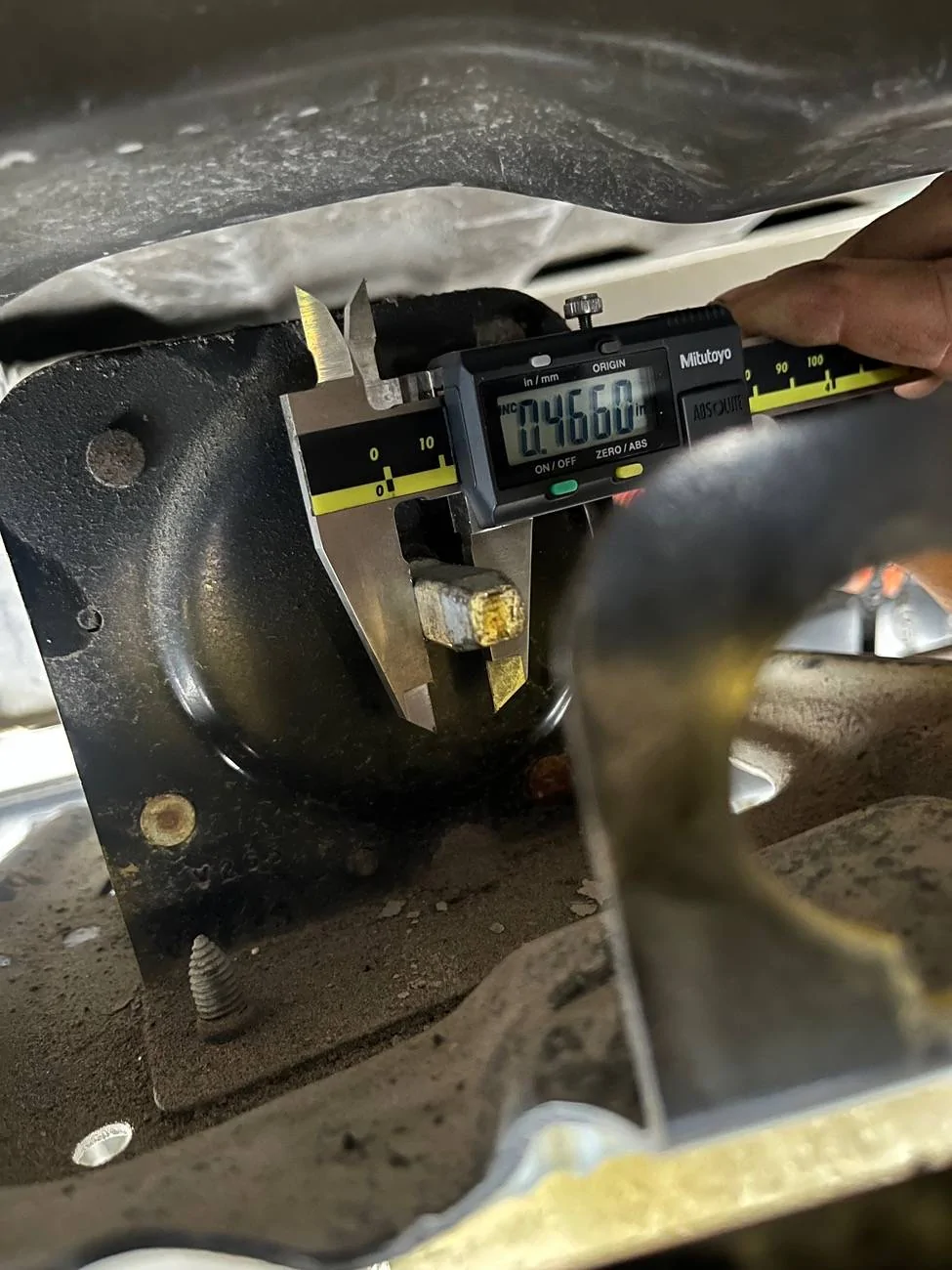

Well, stand by everyone!!! Sorry for misinformation!!! My particular 3/8” that ended up on the end grabbed just fine…but the others I have do not!!!
Turns out it is 0.5” needed. So it’s closer to your 1/2” extension, not the 3/8”!
Did same thing with my 1/2” extensions and it works much better without slipping.
My particular 3/8” extension lowered it just fine, but slipped when cranking it back up!

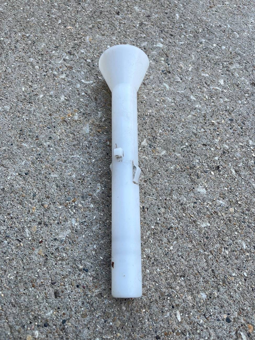

I measure the post…it is tapered which explains why it works with multiple sizes. If you use a 3/8” , you need to maintain force towards pin so it does not slip, since it’s tapered. See photos.
Ended up removing the plastic “funnel” so that I can use the 1/2” more easily.
Sorry for the confusion!

An 8 point socket works on square nuts or in this case a square shaft.
Might need to put the socket on after the extension is pushed through the bumper.
