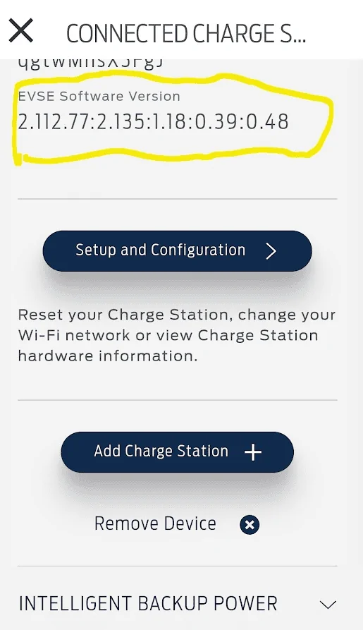

What software version is your FCSP/EVSE at?
This is mine with latest firmware release.
