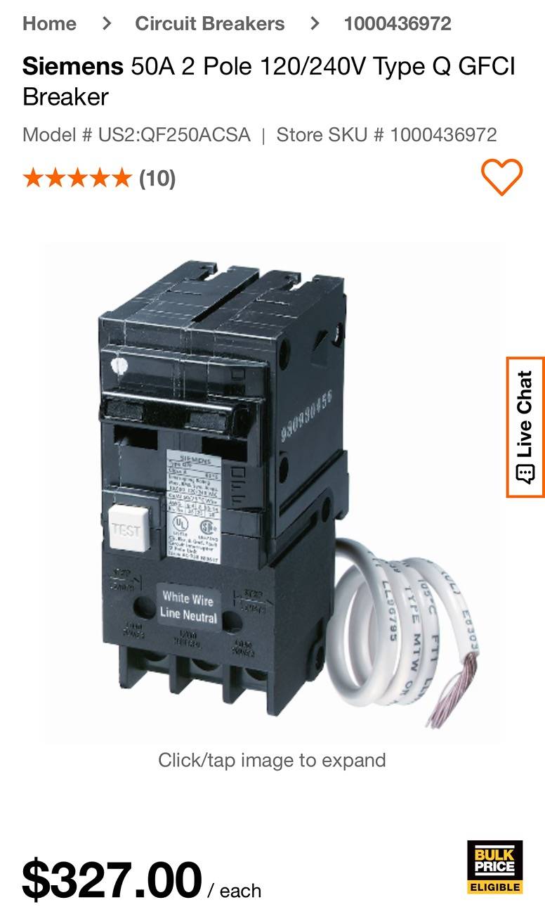

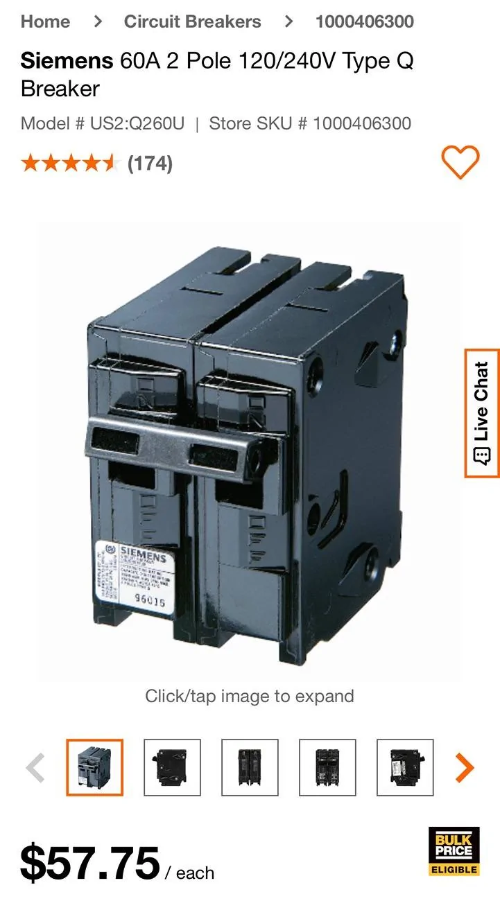

in Canada go hardwired. you'll pay a bit more for a hardwired charger but...
- slightly faster charging 48amps vs 40amps
- install cost will be cheaper. 50amp plugs need a neutral (3 wire), hardwired only requires 2.
- 50 amp outlets require GFCI breakers by code which are expensive and can nuisance trip. hardwired units are ok with regular cheaper breakers.

not sure what the requirements are in the US but in Canada the installation will always be cheaper with a hardwired charger. Mainly because of the GFCI breaker requirement for the plug which can reach above $300cad.
*edit - GFCI breakers only required with outdoor installations in Canada. CEC 86-306
I just did an install of a 50 amp outlet in Ontario Canada with an ESA inspection. Did not require the gfci.

Maybe you got lucky with the inspector? It's clearly stated in the NEC. section 625.54
  • GFCI protection for all single-phase EV charging outlets that are 150 volts to ground or less and 50 amperes or less
  • GFCI protection for all EV charging outlets, regardless of location

Sorry guys, I was mistaken when it comes to EV charging section 86 of the Canadian Electrical Code. GFCI protection is ONLY required when installed outdoors.
I guess indoor GFCI protection is America only. My bad!
