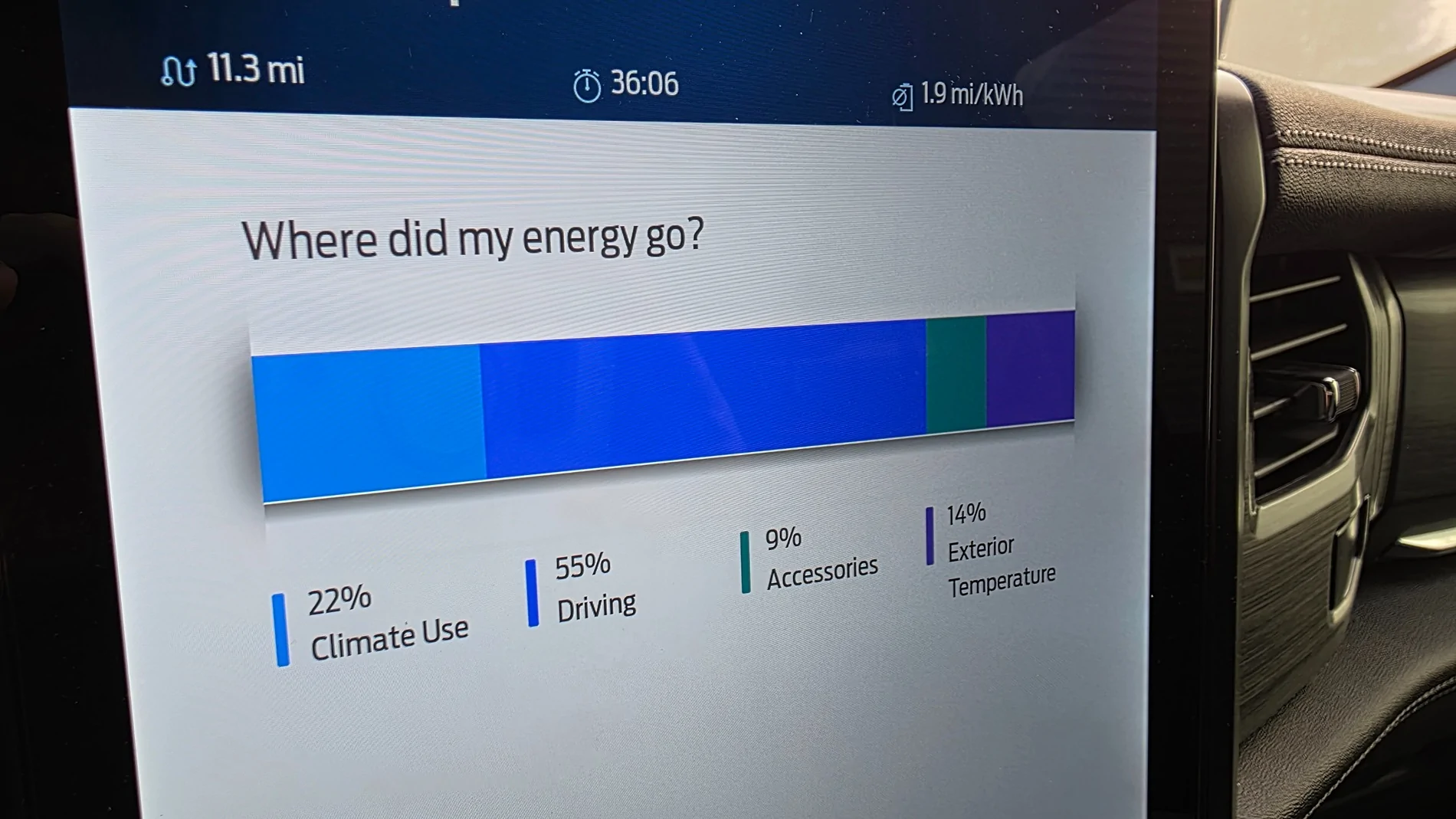

Well we're a tick above freezing this morning and I took a trip to town for breakfast and then back home again and it's showing me that I used almost a full quarter of my energy on climate control. Ouch. It's not even winter yet. We've got a long way to go. This is going to get interesting.
Ford F-150 Lightning How does cabin heating work? 1000018360

Correct.
You drove 11.3 miles using 6kWh (11.3/.1.9, rounded) in 36 min. Your heater can use (pre-heat pump info) up to 10kWh of energy.
Your 11.3 miles in 36 min means an average speed of 19 miles per hour. This is saying that you used roughly 3.9kWh driving and 2.1kWh heating the truck and battery. Makes total sense.
The question is if a pre-heat pump truck did the exact same route at the exact same time, how much energy would it use?

This is where setting a departure time or remote starting climate though the app pays off. Pre-heat (or pre cool) the cabin while plugged in so the initial heat or cooling is done with home power, not battery power. Once the cabin is at a comfortable temperature the heat pump sips power. The initial heating from say 35 to 68 takes a lot more power.

Once you get into this cold of territory, you may want to use departure time. As mentioned above, you can do the math as to how much power you’re using to preheat. It really depends on the cost of your power to decide if it’s worth the comfort. I ran a bunch of tests on my 24 Flash last winter and it was anywhere from an extra .25 to $1 for me to preheat depending on outside air temp. I found I would recover most of this on the back end charge that evening though as I didn’t spend all the energy to heat on my trip. It was slightly more costly energy wise though, so pick your poison, comfort or quarters.
Departure times are a fun event with our trucks. The E Heat is really interesting in yours, I haven’t seen that and it makes sense they would incorporate that for the quick heating and just use the pump to maintain. About a half hour before my departure time on a cold morning it sounds like a small RC jet is spooling up for takeoff and I’ve been waiting for my neighbors to ask if everything is ok but haven’t heard anything yet…
Make use of your heated seats and steering wheel. For me, neither come off this time of year and I leave the truck on 72 Auto 3. One other thing that’s a PITA but may help you. If I ever feel a chill in the air and I don’t have a passenger (which means passenger heat is off), I will go into climate and flip on passenger heat. I think it’s the Dual button. This noticeably helps balance out the cabin. Just note this resets after you shut off unfortunately which is where the PITA comes in if you want to roll around like this.
