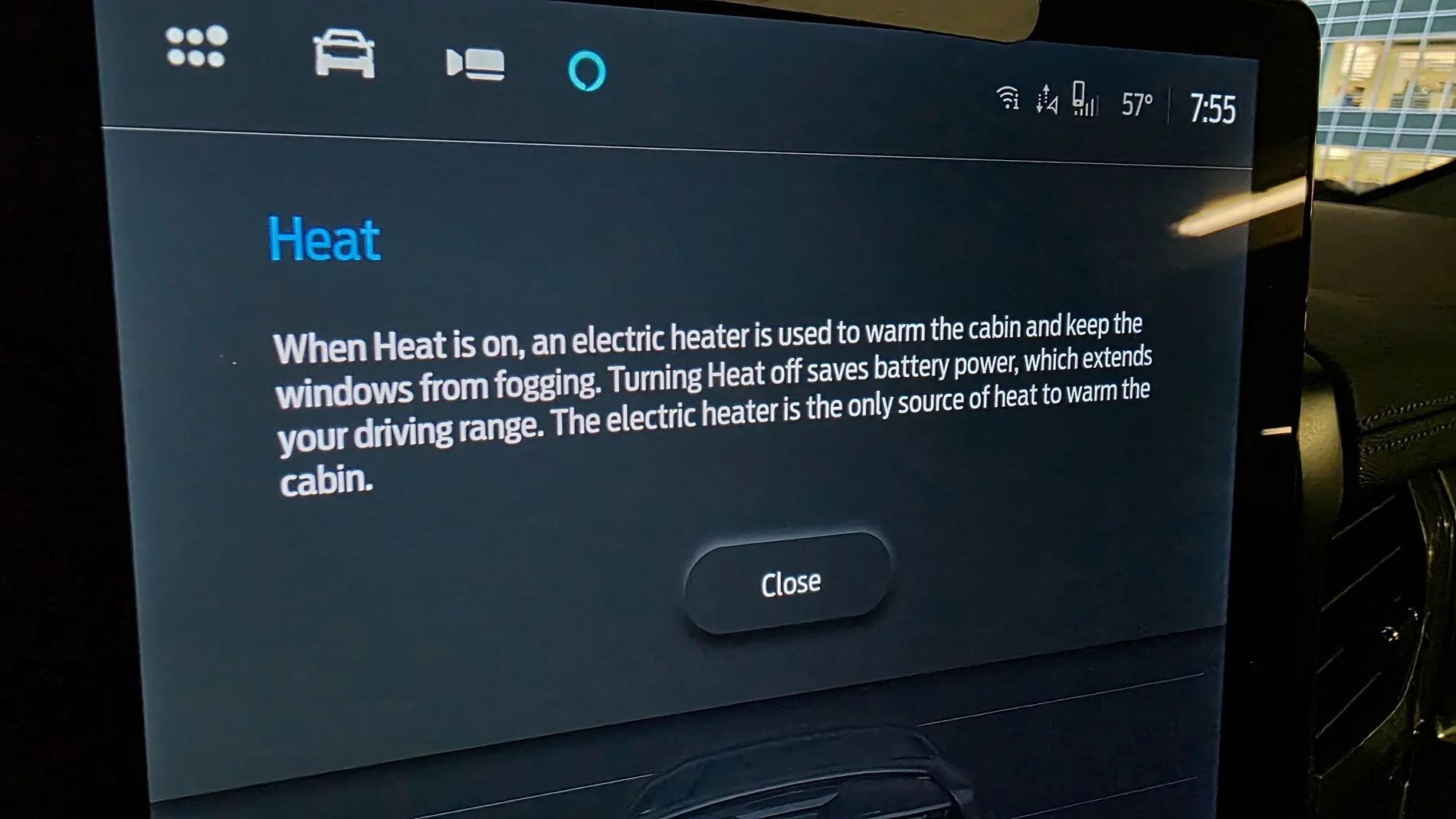

Interestingly, I just looked in my 2025 owners manual and it states:
"When E-Heat is on, an electric heater warms the cabin and keeps the windows from fogging. Turning E-Heat off saves battery power, which extends your driving range. The electric heater is the only source of heat to warm the cabin."
Hmmm.....
Hmmm.....
I think the editor(s) in charge of revisions didn't capture the distinctions with the 24+ heat pump functionality.
That is very possible but even if I get in the truck and open up the climate settings on the screen it says the same thing.
