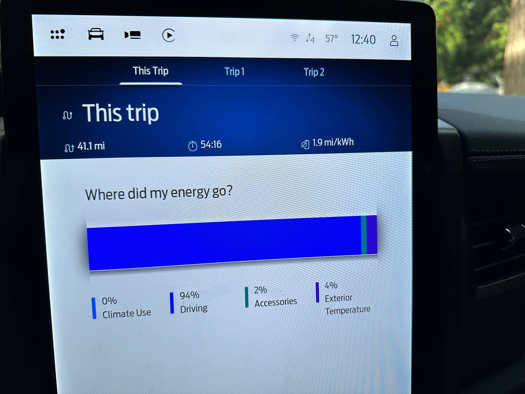

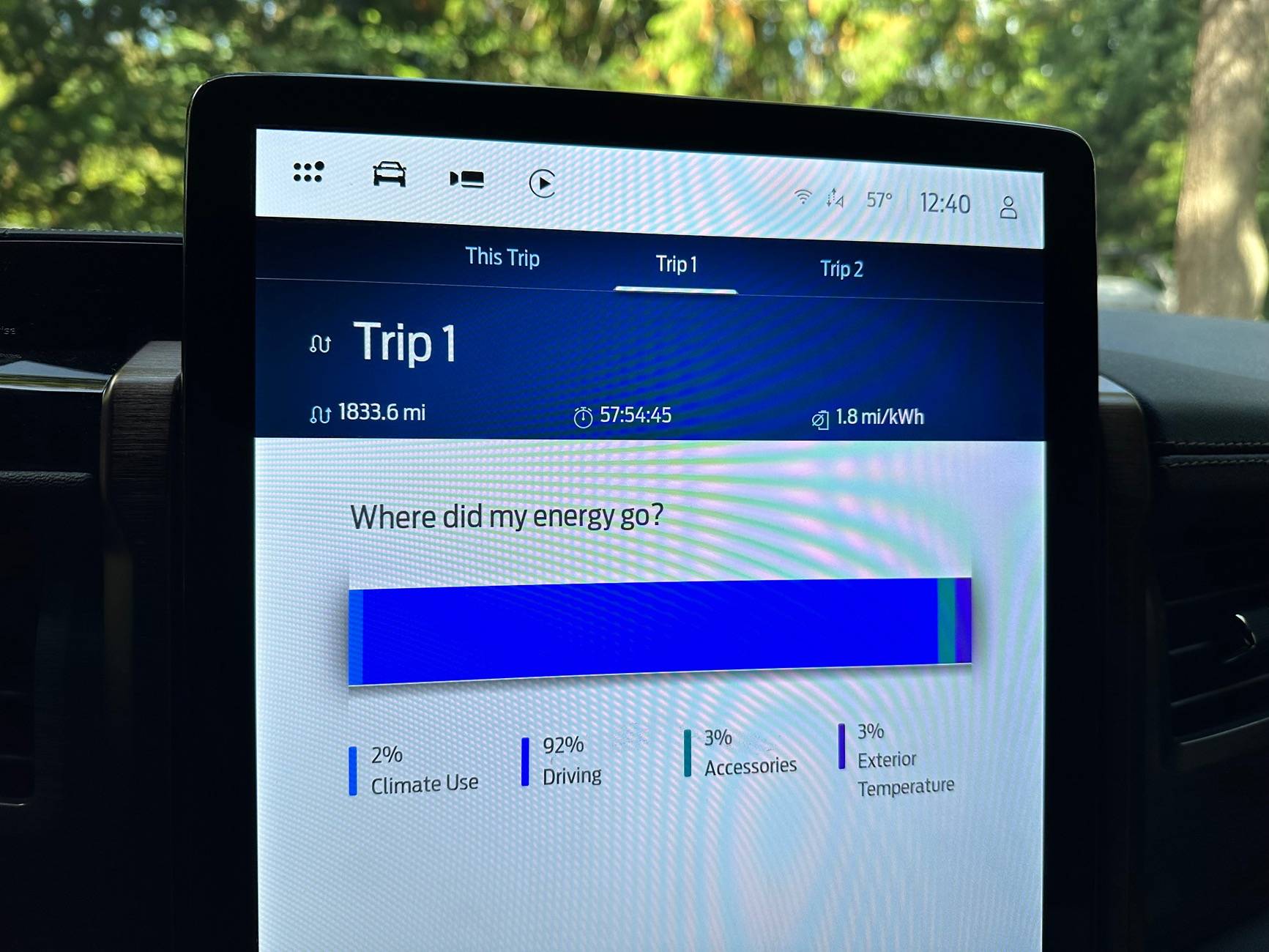

Something new I noticed on my commute today - differing displays and calculations for mi/kWh. I do not use the GOM for anything and usually do the math when driving long distances. I have noticed using my ODBII device the dash display is generally pessimistic on what it shows once I do the calculation post trip. I attributed it to rounding but why do different screens in the truck show different results? Has anyone else done a deeper dive into specifics on this using data for measurements? If so, please provide results. That extra ~.1 or .15 mi/kHw might help change charging locations when traveling.

Interesting how the majority of the responses don't seem to understand the question.
Pictures 1 and 3, and likewise 2 and 4, display the same data. Yet, the miles per kilowatt show for the exact same data is one-tenth different.
The answer is:
Bob Franklin is the person that wrote the code for pics 1 and 2. John Heratio wrote the code for 3 and 4. Bob went to school in New England, and is really smart. John went to school in the south... He's not good at math... :crackup:

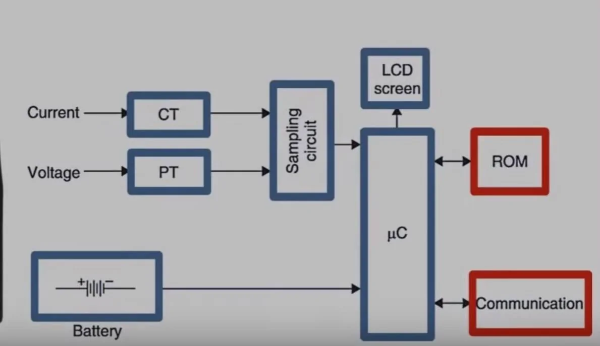

A number of sources of imprecision and estimation in a digital energy meter:
Ford F-150 Lightning How pessimistic is the Mi/kWh display on the dash? digital energy meter
How accurate are the current and voltage measurements?
What is the frequency of sampling - will introduce some sampling error?
How is the calculation done in the microprocessor - is there rounding off?
(Note: the "Battery" in the drawing is the battery powering the meter, not the battery being measured)
The answer is:
I like your "Bob" and "John" analogy. As an IT professional, my guess is that both screens are using the same data point, but for the display value the center screen Bob is rounding (1.87 becomes 1.9) while in the driver display John is truncating (1.87 becomes 1.8).
Still very annoying to those of us with moderate to severe OCD.

OK, so the questions were:
1) "why do different screens in the truck show different results?"
and
2) "Has anyone else done a deeper dive into specifics on this using data for measurements?"
Answer to 1): One screen is "This Trip" and it is a 41.1 mile trip, while the other is for "Trip 1" which 1833.6 miles. Over longer distances the driving style will be different from shorter trips is one possible explanation, another is the short trip is a smaller sample size so maybe less accurate than the longer trip (but only by a hair different).
Answer to 2): I think I beat that question to death in my resplonceanations.
