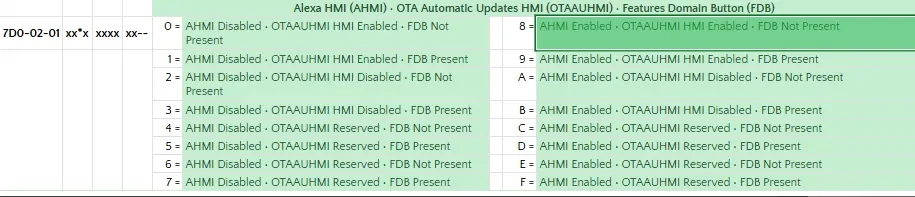

Something similar happened recently on the Mach E forum:
https://www.macheforum.com/site/threads/software-update-page-missing-in-sync.51423/
I was not able to help him get it resolved, but I did find a setting in the APIM that has something to do with this. In his case, it was already enabled, yet he still does not show that option in his touchscreen:
Ford F-150 Lightning Is the Software Updates menu always visible? 1766247728889-7j
I am not 100% confident this is the setting that needs to be enabled in order for that option to be there, but it is the only thing I was able to find in the APIM that I can relate to the issue.
