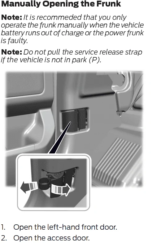

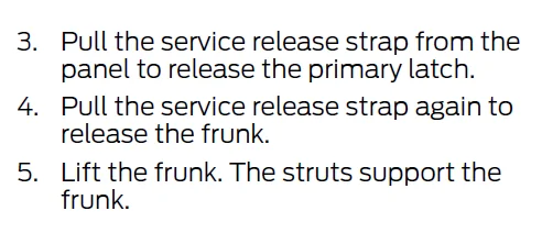

Trying to figure out how to get the Frunk open after pulling the material release inside the cabin. It pops up but don’t see a lever to pull or push up on. Tow truck driver almost here.

IIRC you pull the manual release strap a second time to release the primary / secondary hood latch
Unfortunately a great example of why people should a) read their manuals and b) download a PDF version from owner.ford.com to every device they own. Pulling twice is a known thing.
