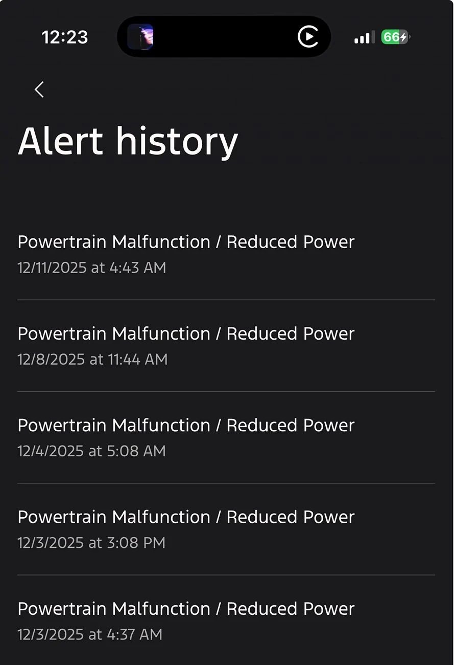

Just starting another thread about Powertrain Malfunction / Reduced Power notification. Started getting a service vehicle soon message a couple weeks ago. Still under warranty but replaced the 12v myself to avoid having to go to the dealer. Didn’t help.
No reduced power. Charged fine. Shifter stowed without issue. Heat works fine.
Dropped truck off with an appointment 12/18/25. They said they’ll trying and get it back to me by Tuesday. I knew full well that wasn’t going to happen.
Had not heard anything so messaged them today and got the response pictured in the text.
Truck hasn’t moved in their lot since I dropped it off(drive by the dealership on my way to work)
2023 XLT ER 31k miles.
