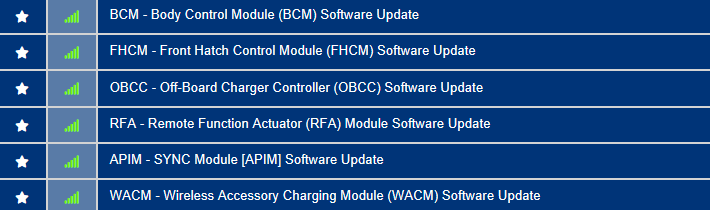

Here's your list:
Enjoy!

Bring your USB 3.0 thumb drive... (y)
Here's your list:
Enjoy!
Thanks again. Ran the updates yesterday and without any issues. Really enjoying the new version of sync with youtube.

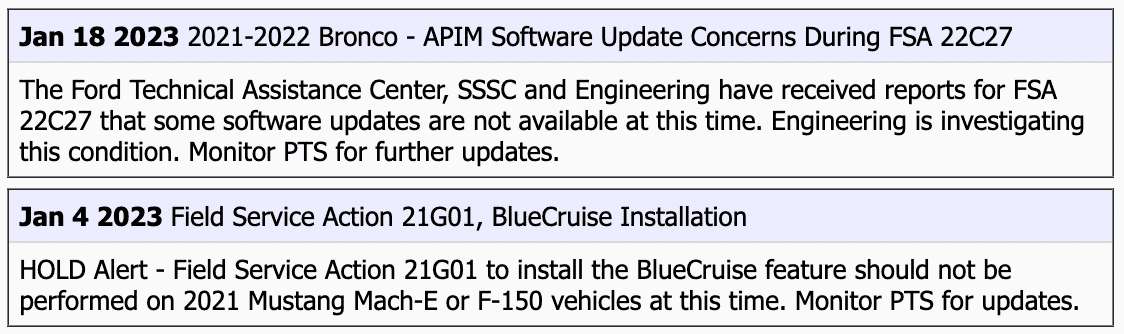

So a member memtioned to me that his BC is now not working (MY22), and the service advisor says that Ford has told them that they can't do any BlueCruise programming cause there's a bug in the APIM software and there's a hold on programming.
Emmm. No. That's not what the OASIS broadcast said.
Ford F-150 Lightning Lightning Software Updates using FDRS Screen Shot 2023-01-24 at 5.37.26 PM
It seems that this service advisor (as well as others who simply skim the headlines and don't process the whole message) are conflating two messages, and neither of them have anything to do with diagnosis and repair on a 22MY Lightning that came with working BlueCruise from the plant...that now doesn't function.
They can and should diagnose and repair that condition on our trucks.
That 21G01 hold is for 21MY Job 1 Mustang Mach-Es and F-150s that were supposed to either get BC as an OTA or by having a service tech do the update at the dealer in the last year...and neither of those things happened during the period that 21G01 was a funded program. So the program had to get extended, and then problems were discovered and Ford put doing the BC programming for '21J1 vehicles that never had it working before on hold. Nothing to do with Lightnings that came from the plant with working BC.
