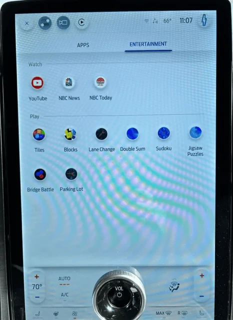

I noticed this a couple of days ago but forgot to post an update.
I have the new UI interface (Sync 640) and initially thought that the addition of the streaming capability that the Mach-E has had now for a while wasn't included and would require a further update to enable cause it wasn't there immediately after the update. And I noticed about a day or so after I did the update, the "Entertainment" section was completely grayed out and couldn't be selected, but I didn't give it much thought as I don't use those features.
So while looking up something else in the menus on Friday before a drive I noticed that the Entertainment section was 'back' and not only that but the streaming of Youtube and the NBC stuff had shown up just like it has on my Mach-E.
I don't know when this happened, but I know it was sometime after I updated Sync. I know I haven't had any OTAs (no history according to the truck). Anyway, for those who haven't seen this yet, here's what it looks like:

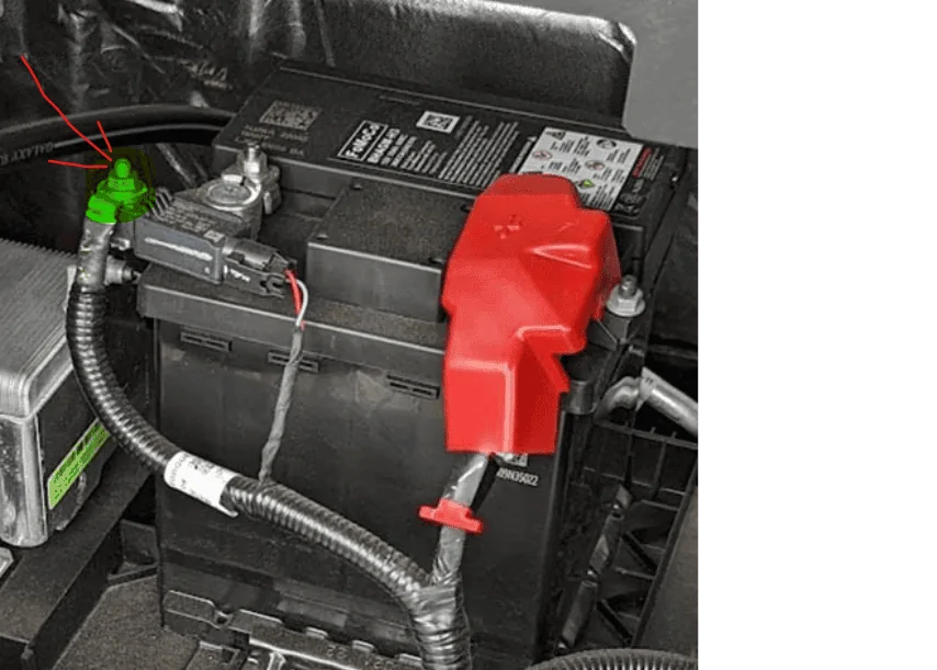

Let me make sure I understand this before I attempt myself lol - you all are using the jump points to connect the maintainer / charger?
Ideally that is what you could do, or, open the battery access door, connect the charger negative clamp to the threaded connection on the current sampling bridge not the battery post, the bridge measures and informs the trucks BMS system as to current coming and going to the LVB.
The positive charger clamp can be attached directly to the post of the LVB.
Yes, that's what I do. I try to stay away from that battery monitor on the negative terminal.
