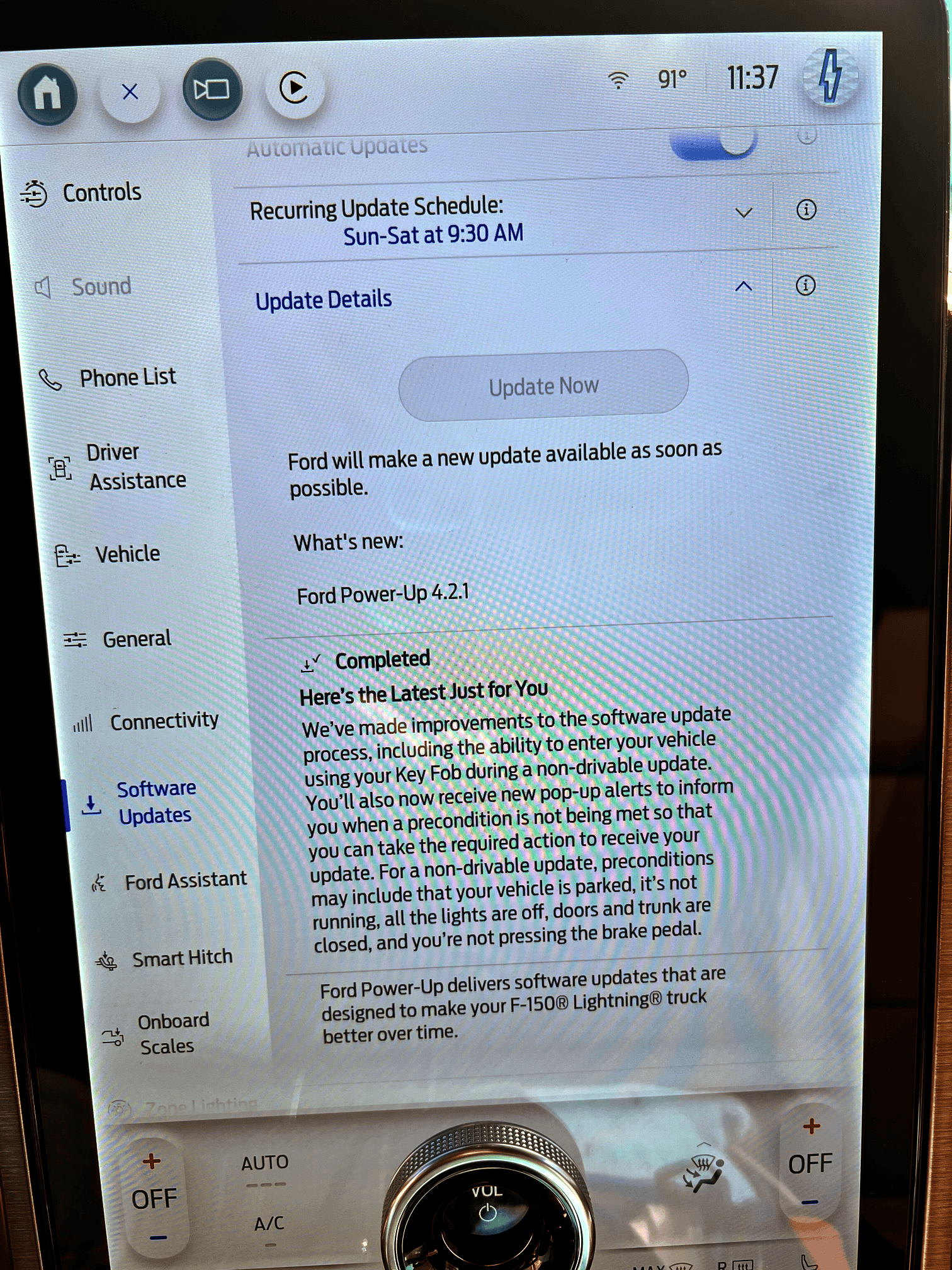

Do you think the GWM update is the same as Ford Power-Up 4.2.1? And do we have any way to tell? It's my understanding that the "Ford Power-Up" updates are really just a naming package for a set of updates that go via OTA.
My F150 just got 4.2.1 via OTA today, but I am not by the vehicle right now to see if anything really changed. I manually updated everything via FDRS a few weeks ago, but only acquired a 2 Day license at that time, so haven't checked yet to see if it or my Mach-E have new updates. Note, I have not received any update notices for my Mach-E yet....
Why yes...yes I do think it's OTA 4.2.1.
Got the gear out and hooked up the PL6100 and opened FDRS after connecting the Mongoose. I checked the DTCs and did a reset and recheck...and then I went to the 'toolbox' to see the list of software updates that I had checked earlier this morning from my desk.
GWM was gone. Nothing in the list.
So I flipped back to the vehicle identification section and lo and behold my GWM revision was no longer "-LCE", but instead it now shows "-LMA". (This is similar to the Mach-E going from "-LCE" to "-LKA" as a result of last week's update).
So I checked the software updates page in Sync (which I usually never do) and saw this:
Ford F-150 Lightning Lightning Software Updates using FDRS Lightning_OTA_421
I don't know which is more surprising...the fact that I got an OTA, or the fact that I got an OTA the same day the gateway module update appeared in FDRS as well. Usually FDRS updates lead OTAs by ten days to two weeks (from what others have said on the Mach-E forums). Maybe they were really keen to get this gateway update out there for some reason.
I guess that short little drive I took yesterday was worth it. I don't normally get OTAs at all.
Anyway, OTA 4.2.1 = software revision ML3T-14H021-LMA on my '22 Lightning ('23s may see a different rev afterward, we'll have to see :unsure:).

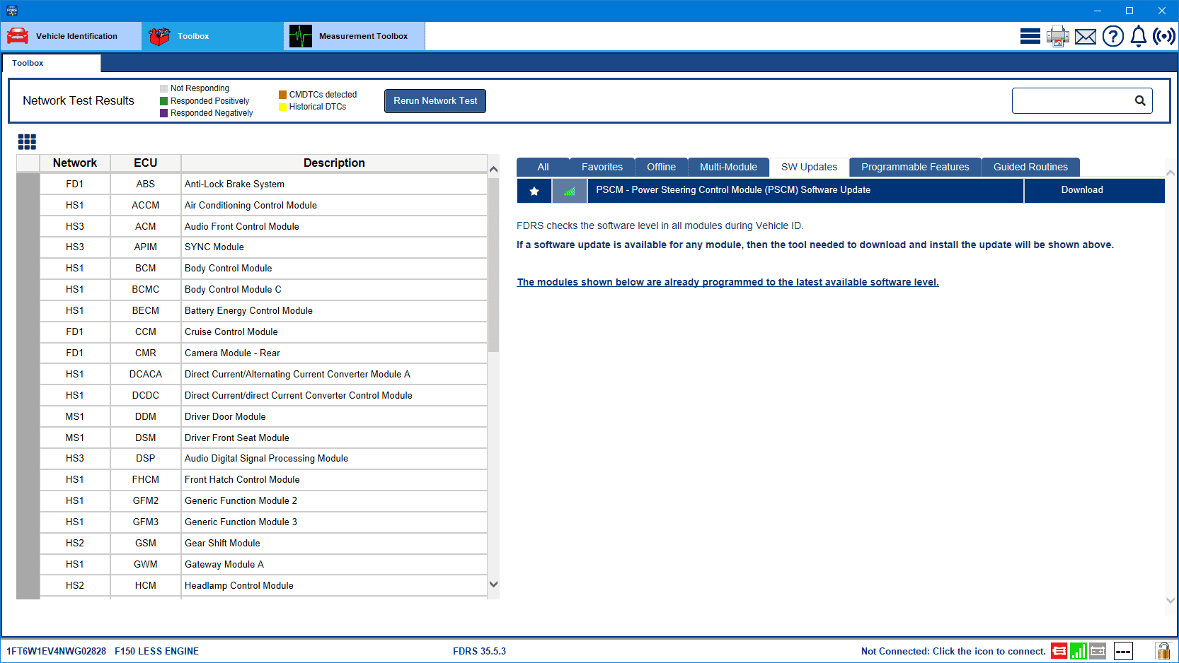

I guess since many Mach-Es got an update to the Power Steering Control Module (PSCM) on or about 18 Feb, today's appearance of a similar update for the Lightning should be no surprise:
Ford F-150 Lightning Lightning Software Updates using FDRS PSCM-4-Mar-23-Lightni
I'll post what I find out about this after the update.
So the update took 5 minutes.
Included a new secondary boot loader, image, and strategy, but did not change the revision number (F188 DID is the same). No other changes noted.

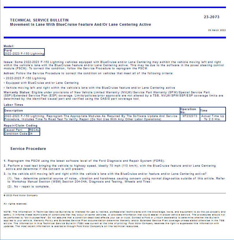

So the reason for the PSCM update has been revealed!
It's a strategy update to correct lane ping-pong while using BlueCruise.
TSB 23-2073 came out yesterday:
As a reminder you can read the available service info for your Ford vehicles by visiting this site and entering your VIN after agreeing to the conditions.
Is this an example of an update that can only be done via FDRS and will not come OTA?
I'm trying to figure out my strategy for doing FDRS updates since I'll be paying for 2 days at a time....thinking I'll wait until there's a bundle of important ones that apply to both my MME and Lightning.
No OTA for this has been announced. It theoretically could come as an OTA. It has not been fed into the OTA hopper for spreading yet I guess.

I applied this update via FDRS a few days ago. Yesterday I took the truck on a 400 mile trip and BlueCruise was noticeably better. Previously my truck would bounce from side to side. Now it stayed straight in the lane. I was very impressed with the improvement.
I like the way they word it that some vehicles “may” exhibit the problem. It’s like Microsoft issuing a fix that says some copies of Excel may tell you that 2+2=5. My dealer has to diagnose this before they can do the update. There are two versions of the code and one works better than the other. Just give me the new version and be done with it, but instead they are going to pay a tech to drive my truck around and see that it wants to wander across the lane.
Well I can say with 99% confidence that this update will be required in addition to others to enable BC 1.2 when it rolls out. This is key to correcting one major issue that BC users have complained about.
