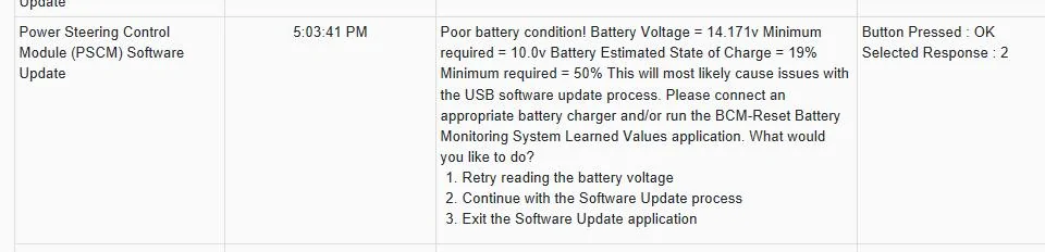

FDRS captures everything. Its hard to hide being a tech. Last week looks like they got brave and did the updates with no power supply - or it still drained hard. IPMA was started with 67% SOC and the IPMA was started with just 19%. It took about 14 minutes.

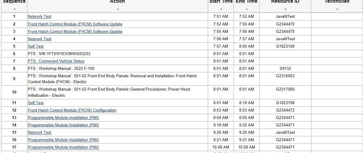

OK - guessing that all the little details in the hands of the novice (me) is dangerous. I'm wondering if they had to replace my Front Hatch module. They tried twice to update the SW and it failed. Code E100. They tried PMI on the module 3 times answering NO each time to was the original module installed and it failed with E100. Then an hour and a half passes and one more PMI is successful. They didn't add the parts to my work order.
