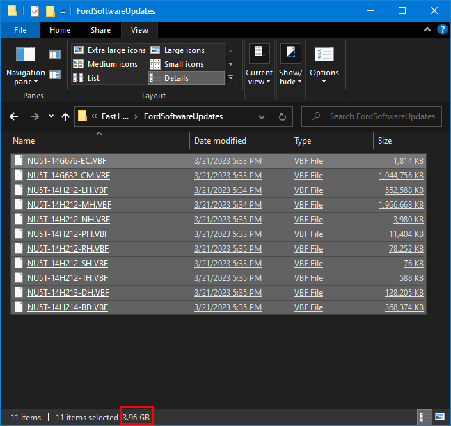

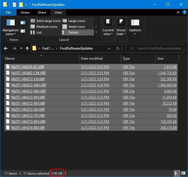

21 Mar 23 and there's progress.
I checked my VIN late this afternoon and found a new APIM update as the sole thing on my list.
I have already been running Sync 640 (new Sync UI) for a while now as those who follow this thread know.
I was kindof expecting a new APIM update because my '21 Mach-E (as well as those with '23 models for some reason, but not many '22s) have gotten Sync 713 about two or three weeks ago.
I hopped in the truck to move it over to the shop to do the update and noticed I had a software download for PowerUp 4.2.1 that said it had "not completed" but the notes were there. (On the Mach-E OTA 4.2.1 was a GWM update and the notes on the Lightning matched what the notes were for OTA 4.2.1 on the Mach-E so I figured it's the same).
In the 30 seconds it took to move the truck the screen changed and said that the 4.2.1 update was now completed.
I connected up the laptop and the APIM was still in the list so I downloaded and ran the update. Took a while to do the download this time, like 15 minutes, and then to about half as long to copy the almost 4GB of data to the USB drive.
Ford F-150 Lightning Lightning Software Updates using FDRS APIM_4-2-2_Sync_713
Plugged the drive in and about 5 minutes later was told to shutdown and leave the driver's door open and then come back for the restart after 10 minutes.
All went as planned. Sync version is now 713, like my Mach-E, and the software revision version is also the same as my Mach-E at "NU5T-14G676-EC" revision (it was "-BB").
So this Sync 713 has the same two new games (Bridge Battle and Parking Lot) and that matches the Mach-E that got this update as PowerUp 4.2.2. So it's fair to assume that when this APIM update arrives as a PowerUp it will indeed be 4.2.2.
Have a great evening (unless you had other plans).
