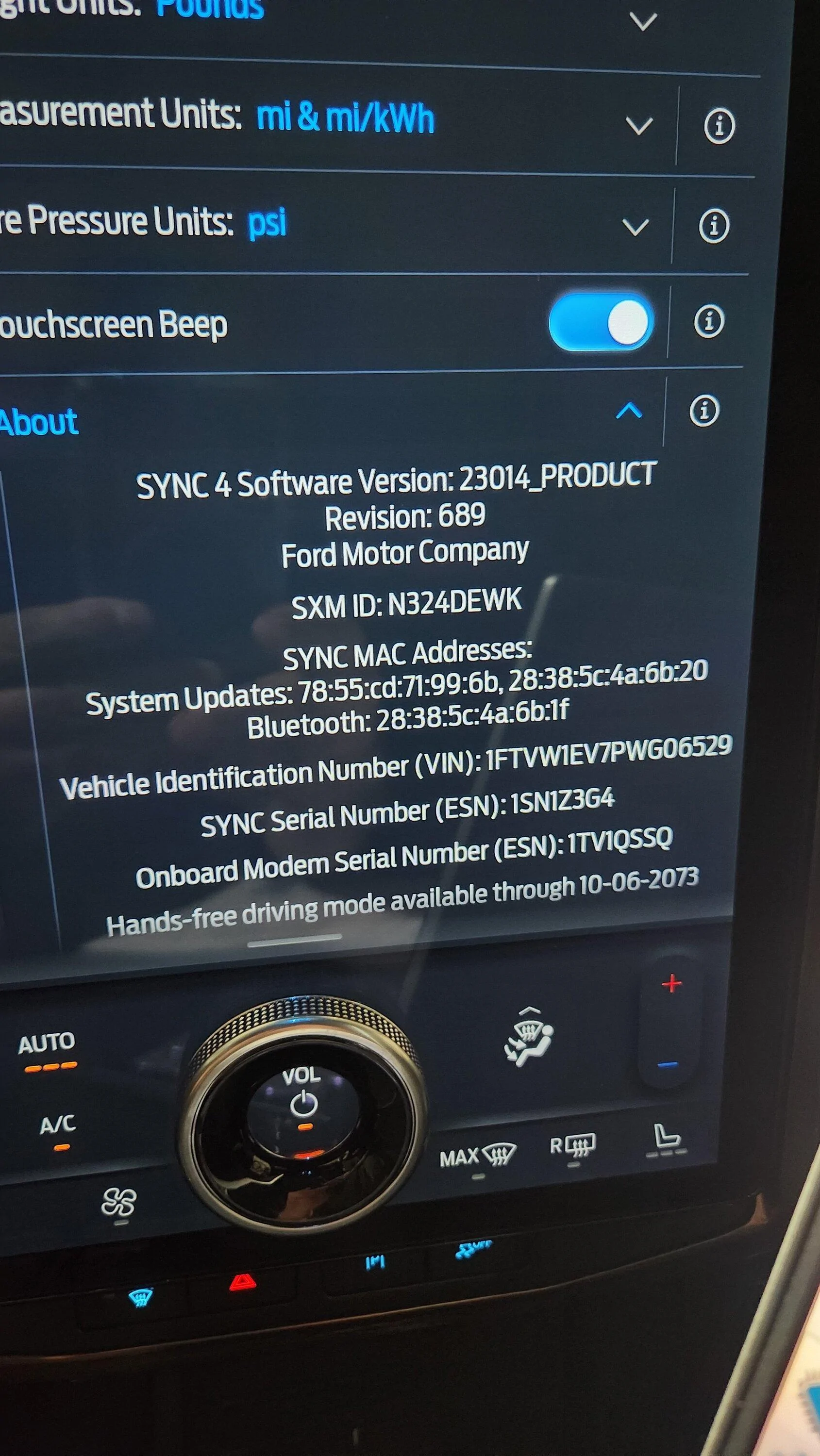

Not sure if this is the right place to ask but I have a 2023 ER Lariat with a 12/08/22 build date. I bought it in early Feb and have not received any OTA updates. I still have the older interface with the slides for heated seats and HVAC. I did have the dealer apply TSB23-2050 and TSB23-2073 (Bluecruise update). My about only shows that I am on Sync 4 Version 22230_PRODUCT, revision 546. Can someone please lookup my VIN and let me know what updates FDRS is showing? VIN 1FTVW1EV7PWG06529.

Not sure if this is the right place to ask but I have a 2023 ER Lariat with a 12/08/22 build date. I bought it in early Feb and have not received any OTA updates. I still have the older interface with the slides for heated seats and HVAC. I did have the dealer apply TSB23-2050 and TSB23-2073 (Bluecruise update). My about only shows that I am on 4.0.22230. Can someone please lookup my VIN and let me know what updates FDRS is showing? VIN 1FTVW1EV7PWG06529.
The only update in your list is an APIM (Sync) update.
They normally do come as an OTA though so you may want to do two things.
Call your service advisor and ask them to pull up your VIn in PTS and go to the 'OTA Dashboard' and tell you if this update has tried to download or if they see any problems with your OTA status. They can do this over the phone.

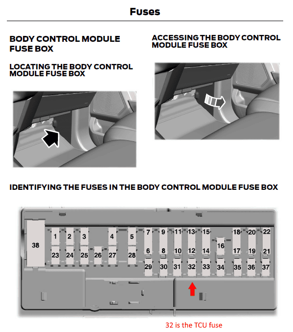

Then there's another thing you can try....you can pull the TCU modem fuse in the right side passenger footwell and leave it out for like 15 minutes and then put it back in and go for a drive of around 20-30 minutes in an area with good AT&T coverage to see if anything downloads.

Well, I pulled fuse 32 and left it out for 45 minutes. I plugged it back in, drove 20 minutes, and not update. Ugh. All features work in Ford Pass. I guess I have yet another trip to the dealer. I have had it in for a total of 4 times so far. Are APIM updates specific to a vehicle or can it be shared so I can put it on a USB drive?

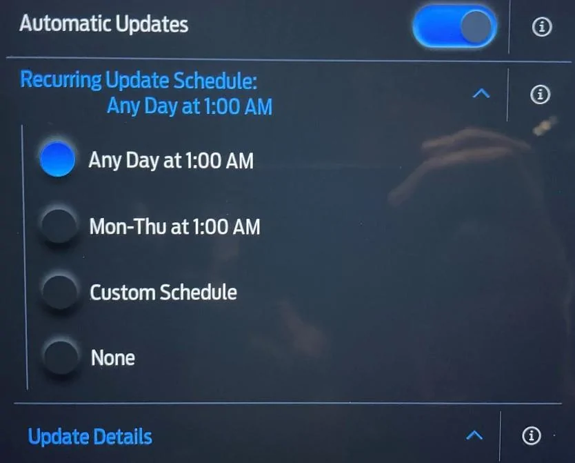

Is your scheduled updates set to a time when you'll be driving the truck? You should set it so that it checks while you're out and about or an a daily commute. I have mine set to 0900 every morning.

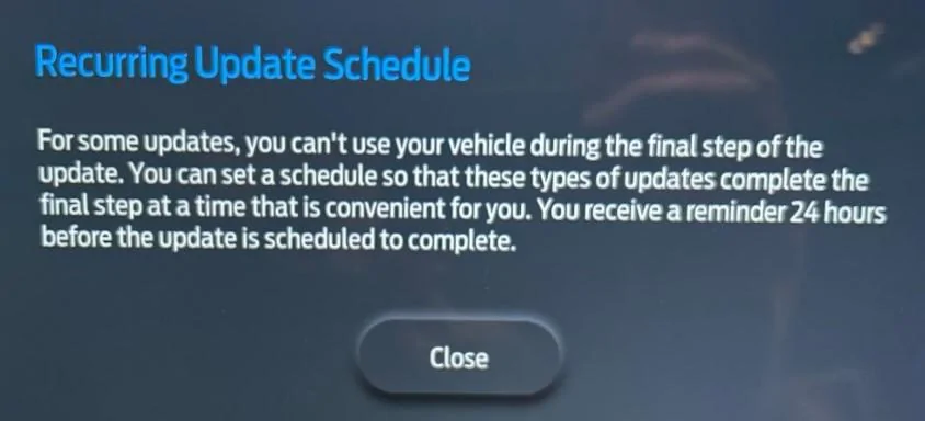

I'm not sure this is correct. The recurring schedule updates are for a time when you are not driving. If you click the info icon on the setting it gives this help message:

And then the choices for schedule are all times in the middle of the night or custom:

I think this last screen is new with the 1:00 AM choices. I think before it just gave custom. I know I had mine set for midnight but when I opened the screen it was set to None (so I changed it to 1:00 AM everyday). Still I have gotten every update usually the first day it came out including 4.2.2 yesterday.
Many of these updates for me happen when I'm driving and when I turn off the truck I get a message in Ford Pass that an update just occurred.

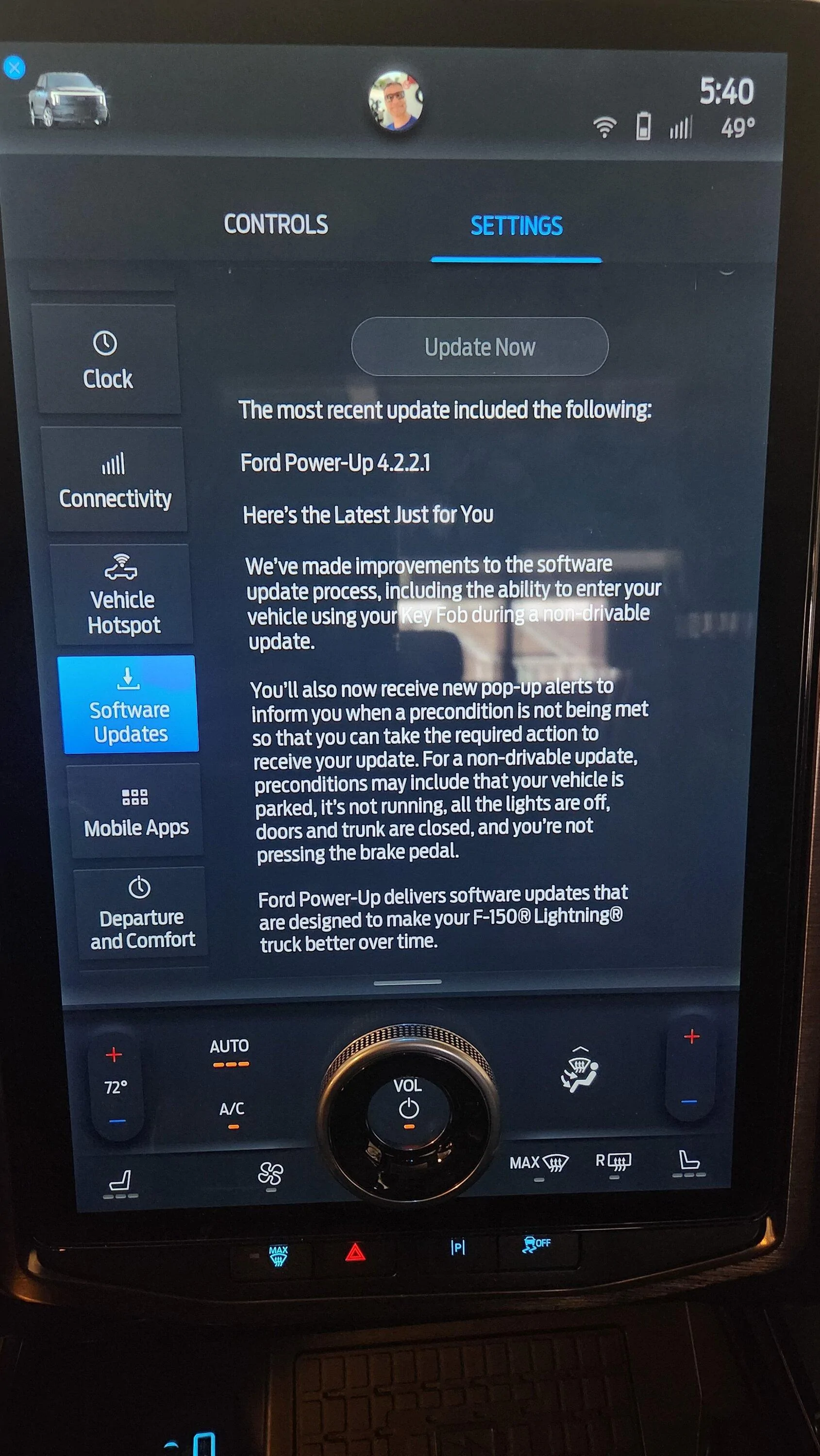

Well, after work today, I took @Mike G advice. I set the update to check 5 minutes after I left. I went to the post office on the way home. I checked for any updates after I arrived...none...so I set it back to checking at 1am. I went into the post office, dropped off a package, and then drove home. On the way home, I received the notice that I had an update installed, 4.2.2.1. Imagine that. The weird thing is that I still have the old user interface. Thanks for everyone's help and advice, I truly appreciate it. And sorry that I highjacked this thread a little bit.

Those are the notes for a gateway (GWM) update. You'll need a bit of a longer drive for the APIM that comes next. It's a big download. So I would repeat the morning drive schedule check but take a longer drive. It takes a while to download 6GB.
