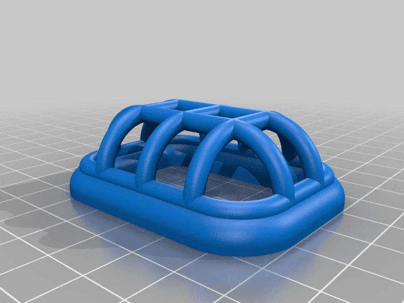

I printed one at my library yesterday.
Ford F-150 Lightning Frunk Emergency Opened While Driving Due to Golf Clubs! KidnappedButtonCoverV2_4mm

You can buy one here
https://3dprint4us.com/products/f-150-lightning-frunk-button-cover-inside
Or
https://www.f150lightningforum.com/forum/threads/frunk-emergency-release-button-cover.17715/
hope it helps.

Just ordered one, thanks for the link! Also L O L Ford would add it onto vehicles and never mention it to any of us. It didn't even cross my mind until it happened. Agreed with a letter at a minimum stating to use caution and retrofit them at dealerships.

I made my own! Took a hard plastic lid from a glass jar from the recycle bin and grabbed my hot glue gun and stuck it on over the emergency release button... I know it's not pretty but I was going on a trip and loading the frunk and didn't want to have to worry about the Button getting hit.. Worked great!

I purchased the device from 3Dprint4Us and it is amazing. I figured I'd need to Super-Glue it on but it actually just snaps on and is secure. Great product.

Same here, shipped insanely fast too.
