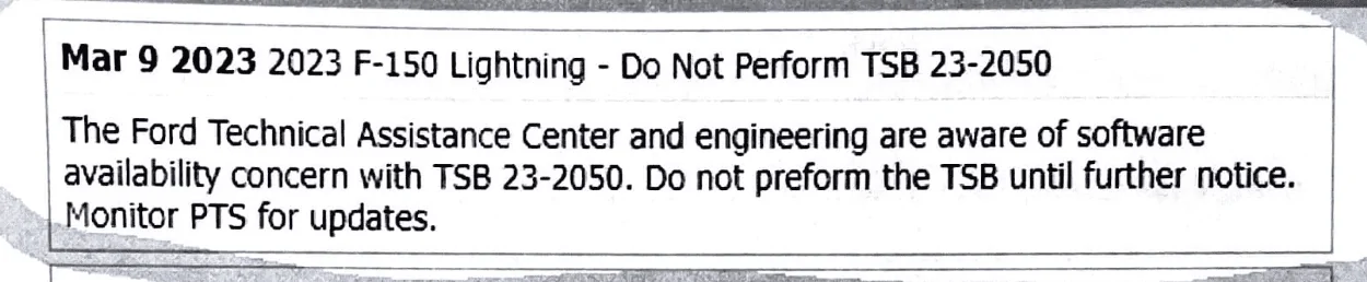

Getting my TSB 23-2050 Thursday afternoon plus various UI updates.
I completely agree zero contact from Ford to me on my $ 2023 platinum model. It’s been all me and others here on the forum here for information exclusively. Pulling fuse 32 every 48 hours until then. Seems like we should get free service & rotates & balances etc for life after all this plus more.
Ford sent this out last week so you might not be getting the TSB done.
Ford sent this? To not “preform” the update. Then they need a grammar checker if they meant “perform” lol.
hooefully I get it done. Fingers crossed.

Law
What is a ‘preform’ for TSB. I hope this is a technical term and not a Scrivener’s error, meaning Ford can’t get out two sentences correctly. I don’t know the automotive world, so I’d suspect it’s something related to preparation of TSB work, right?
They spelled it right in the title but couldn’t do it twice.
