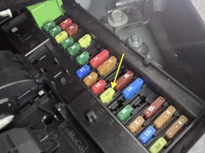

Update: My dealer has not gotten back to me, so I went ahead and pulled Fuse 32 from the passenger-side kick panel, and after 60 seconds, replaced it. It took about 5-10 minutes, but FordPass re-established contact with the Lightning and accurately reported its charge status and location. It will be interesting to see how long this "fix" lasts.
Side note #1: Turning off Apple CarPlay (or its Android equivalent) before messing with the system is apparently important to the process. I think it has to do with freeing up the WiFi modem to allow connectivity.
Side note #2: I had a 2016 Ford C-MAX Energi with the same recurring problem and I had to pull a fuse on numerous occasions to fix it. Ford really needs to get its software/hardware act together.

Maybe as an experiment, stop using wireless carplay (delete your phone from the truck). Reset the modem with the battery or fuse 32 fix and see if it comes back.

I'm already doing this after pulling fuse 32 on Friday morning. On Thursday, the Ford Support tech mentioned turning off Apple CarPlay multiple times as we were troubleshooting. At the time, I wondered if there was a relationship between wireless CarPlay and this problem.

just lost my fuse 32 20 amp one and the flippin spare 27? 20amp one way into no man’s land. This every 1-2 days Ford modem reset really disappoints and sucks Ford. You owe me a heated steering wheel at least ugh!!! 40mins and a super bad sore back later I retrieved both fuses many hand scratches later. Modem reset and FordPass working for moment. This really sucks guys and gals. Ugh ?
Don’t put it back in upside down. Gives off all sorts of error codes ??‍♂
But when put back in correctly my app was working and connected again
