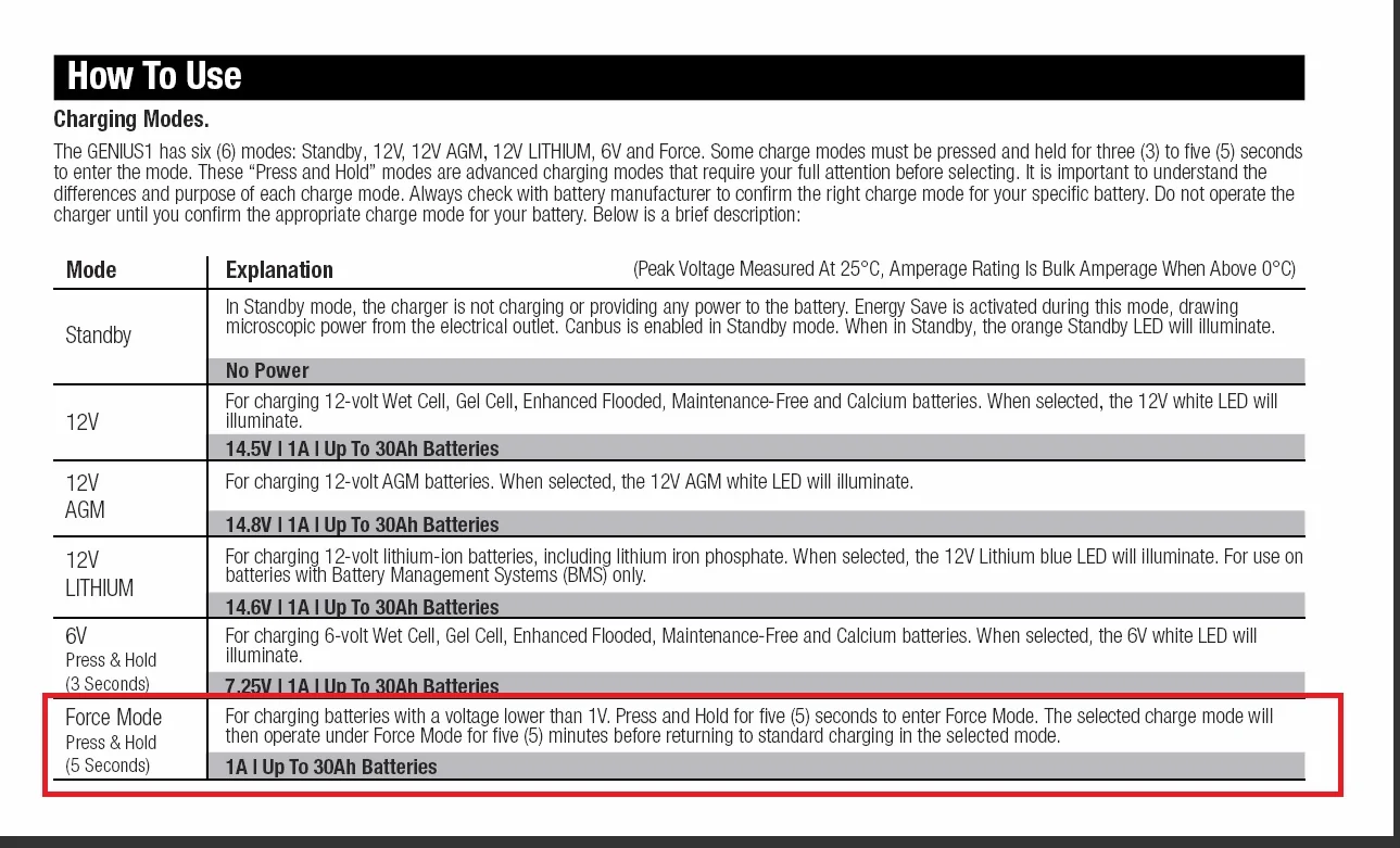

To "force charge" with the NOCO you have to specifically set it to do that, it is not the default. The Reddit post did not say he was using a "force mode" and he took it off the "trickle charger" before it exploded, from my reading.
Right. I know. I have one of these and use it to maintain. I was replying to someone else who stated you can’t force charge these batteries. I guess can’t should have been changed to shouldn’t.
