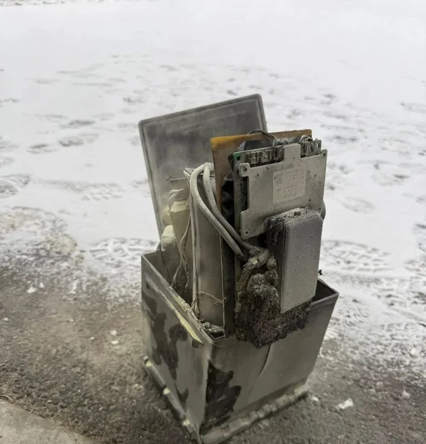

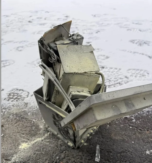

It was being "FORCE CHARGED" by the Lightning???
No one should ever try to charge any lithium chemistry battery that has one cell at one volt. That cell is shot, and is well below the lowest voltage to attempt a normal recharge. The Ohmmu BMS should have prevented any current from going in or out of the battery, no matter what chargers or chargers were connected.
The owner of that battery (not the same as the owner of the truck that caught fire, BTW) should have known better ... somewhere in the Ohmmu manual it would have mentioned the danger of trying to charge a battery with one or more dead cells. If Ohmmu failed to put that in the manual, then shame on them. If the BMS allowed charging under that condition, again, shame on them.
Personally, I would not dream of using any replacement battery for the Ford that is not of identical chemistry and construction to the original, or if not, that has explicit endorsement by Ford as being safe.

Very high charge currents have been seen/measured when the Lightning is charging the 12v battery. Maybe the Ohmmu BMS should have prevented this? Maybe the Ford 12v Battery Manager is a battery mangler?
In the particular case from Reddit, the Ohmmu BMS is clearly at fault, if the post is to be believed. There is no way that one cell of a LiFePo battery can get as low as 1.0 volt, with the other cells being "normal" (presumably 3.2-3.5 volts) with a functioning BMS. A "smart" BMS should give an indication that the battery should be removed immediately, and no attempt to charge it should be made. But if an attempt to charge the battery under such a condition were made, the BMS should not permit it, at all, no matter how aggressively the Ford BMS might be trying to do so. It should be an open circuit to the Ford.
I have a bunch of 60A LiFePo cells from 15 years ago, that are still functioning. A BMS from that era would not allow the cells (in a battery) to be charged or discharged if one cell was at 1.0 volts. (2.0V is the absolute low voltage cutoff). One would hope that modern BMS's are better, not worse.
As far as this recent fire goes, there are all sorts of things that might have gone wrong. We can hope that enough of the truck is left to find the root cause. And we can all be thankful that no one was hurt. The loss for the insurance company will be low enough that the investigation may be very brief. If they were on the hook for far more money, then there would be likely subrogation against Ohmmu, which would require a thorough investigation, lots of experts, etc. Chances are good that we will never know what went wrong.
