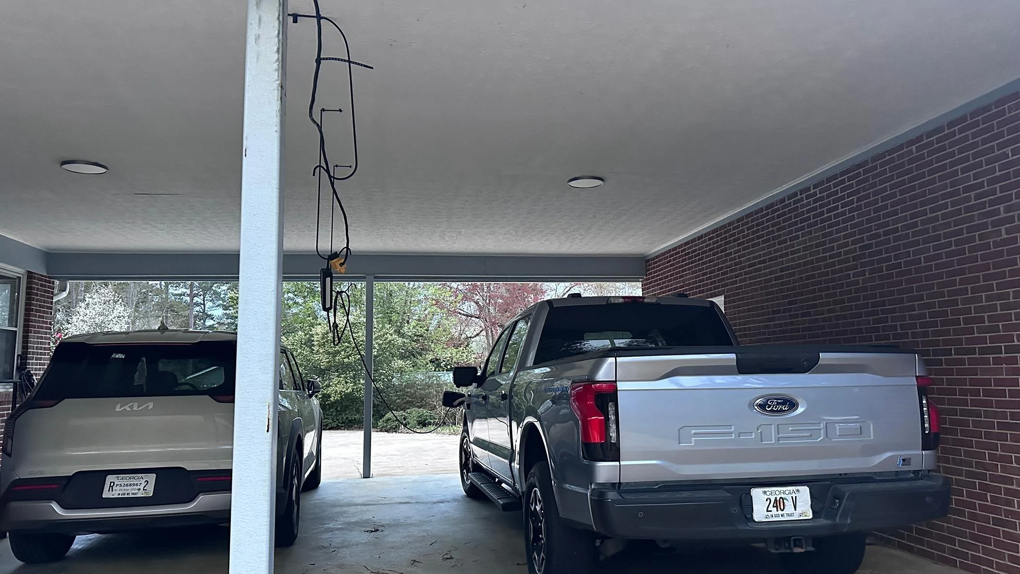

thanks for the update, good info for those of us traveling - you just never know 'what' situation you may get into, depending on the day of the week, your location, the brand charger station, and 'technology' getting in the way...
our new Kia EV9 and the beautiful LIGHTNING a'ppreciate it...

That is a sweet carport. Congrats for EV9, how do you like it?

LOVE it(did I say LOVE it?!?!)...yes, I did. I'll say it again, too : )
