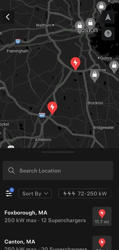

The Tesla app will let you configure the specifics of how you will charge, but you need to bring your own NACS to J1772 adapter with you to "Destination Charger" locations, most do not have adapters unless a private host lends one to you for the visit.

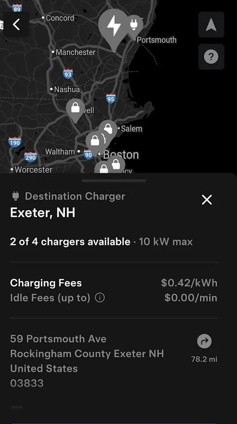

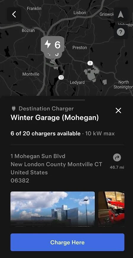

Here is a view of AC charging on the Tesla app, configuration and search results

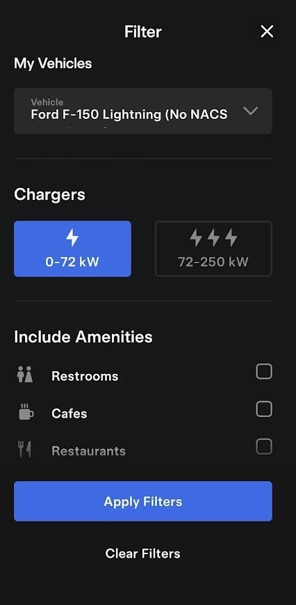

Set up 0-72 charging---------- where you see a lock symbol, these are private use, the host may let you use the equipment, where you see single lightning bolt are slow AC charging open to public for a fee.

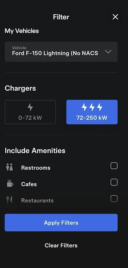

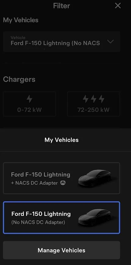

This is how you set up your tesla app for fast DC charging on [No NACS] vehicles if you do not have an NACS->CCS1 adapter, ie. Magic Dock adapter is built into the Tesla cabinet.

The Tesla app will let you configure the specifics of how you will charge, but you need to bring your on NACS to J1772 adapter with you to "Destination Charger" locations, most do not have adapters unless a private host lends one to you for the visit.
Thanks for that detailed explanation! Seems like if you're in a pinch, you'll use what is closest to your location and will most likely be the 0-72 due to their extensive network. But on long trips, you'd want to adjust your timing to take advantage of the DC charging ports. As to the adapters: NACS -> J1772 adapter = AC/slower charging; NACS -> CCS1 adapter = DC/faster charging?

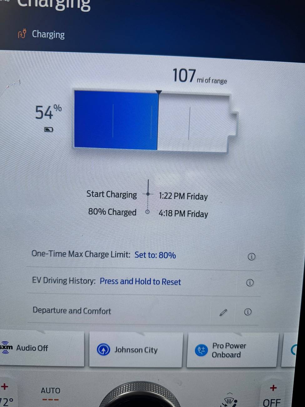

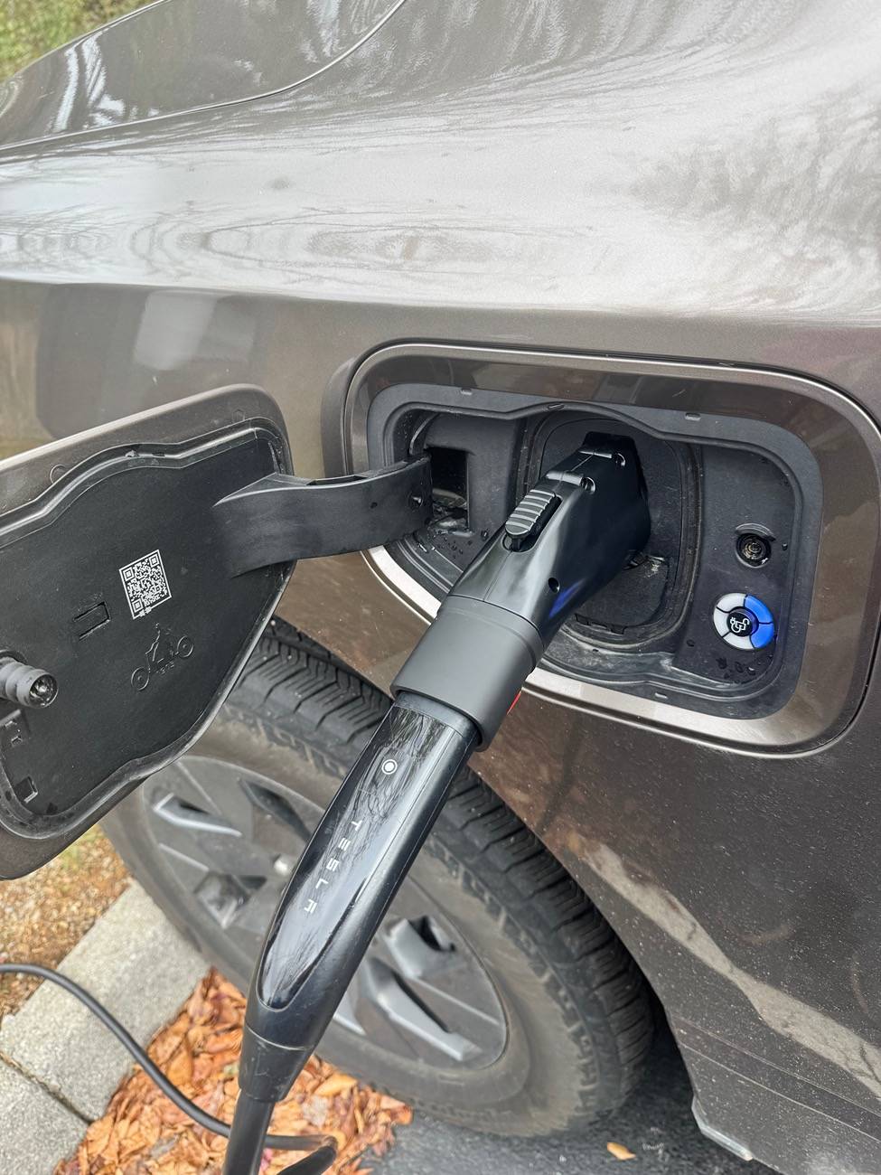

Here’s another brand of destination charge adapter. Free charging as I’m a guest at the Holiday Inn Express in Johnson City, Tennessee. Only one charger, but it works well.
There are lots of the level 2 adapters. Never heard of Latough before. Sold by:

It is rated to 60amps max, warranty link brings up a blank page. A2Z's Stellar adapter is rated to 80amps. Currently $97.2 with code FORDFORUM, and a 12 month warranty. Company is in Montreal.
It works. Any port in a storm. I do have A2Z’s Pro and the destination charger extension cord. Almost needed it today as there was a homesteader parked where a Tesla would need to be. I left him/her/them a gentle note.
